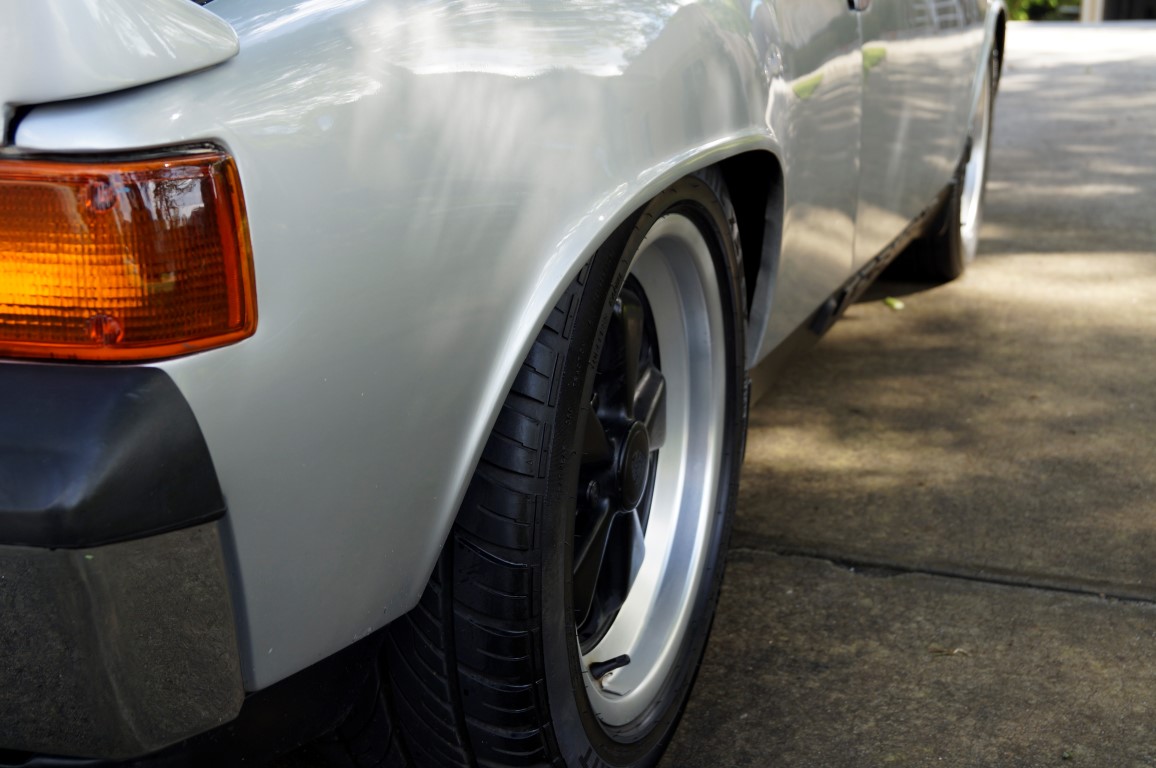

Here is a pic of it before it was delivered.
Its hard to tell but this is a 225 on a 7x16, the sidewalls are ballooned out pretty good.
Here the same size tire on an 8" - the sidewalls are straighter and the offset pushing them a little further out (about 1/2 inch front and rear).
The tires are the same size (205s front, 225s rear) and the wheels are the same (all 16" Fuchs) but it came with 6s and 7s and I pulled from storage a set of 7s and 8s I had with tires the same size.
Sorry I don't have better pictures for comparison.

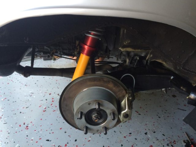

- replaced the rear KYBs and springs with Koni yellow sport coil overs with 10" QA1 140-250lb progressive springs (really helped the ride)

Thanks for the positive comments on the flares. There was a little metal added to make them "right", so more than just pulling them. The rears do give it a more muscular look.
QUOTE(HaraldD @ Jul 25 2015, 09:08 AM) *
Hi,
I think your new wheels are also 7"..
Could it be?
My Best
Harald
When I got it, the PO had 6x16s on the front with 205s and 7x16s on the rear with 225s but the tires needed to be replaced and they looked a little like donuts with the sidewalls ballooned out a little too much for my tastes so I pulled another set of wheels I had and put 7x16s on the front with new 205s and 8x16s on the rear with new 225s. If I had 10MM longer studs, I'd put some 7MM spacers on the rear to move them out a touch more with the flares.

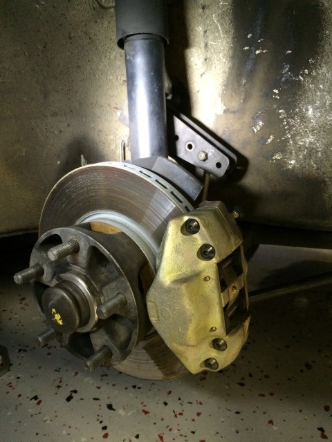

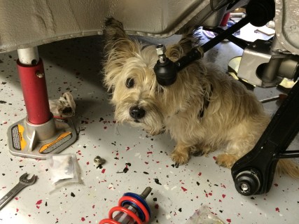

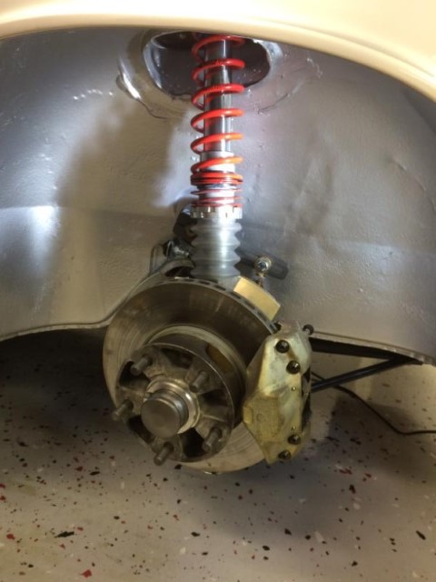

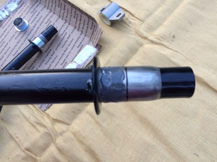

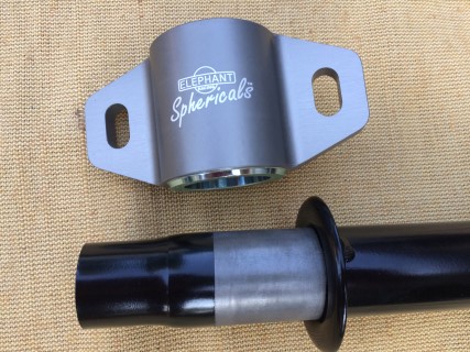

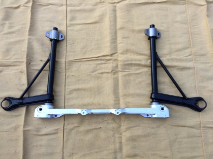

So with the Okteenerfest coming up, it has prompted me to get it in gear and refresh the suspension under the -6. The last time that the previous owner paid it much attention is probably back in the '80s when teflon bushings were added along with a 21mm H&H swaybar.
I started with the front looking like this
After a lot of cleaning, bead blasting, powder-coating, more cleaning, and basically a lot of work, its looking like this
- cleaned and powder-coated the 911 A-Arms
- installed Elephant Racing Sphericals
- replaced the steel crossmember support with an aluminum one

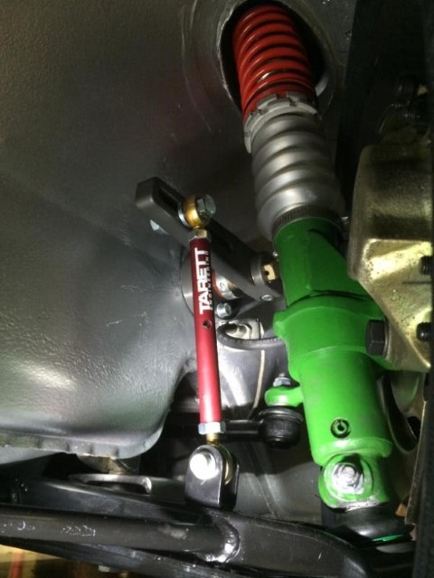

- installed a set of NOS RSR front struts I squirreled away more than 25 years ago
- added new Bilstein sport inserts
- Eibach springs
- turbo tie rod ends
- new 19.4mm hollow GPR/Tarett swaybar
- new ball joints and hardware
- new wheel seals, inner and outer wheel bearings
- new brake lines
The brake calipers where restored in December by our good friend and resident brake expert, Eric.
And a little help from my shop mutt.

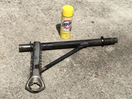

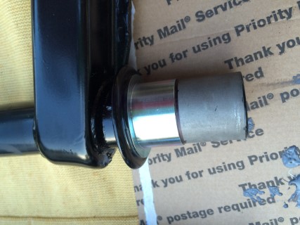

I found a new friend when it came to stripping the paint on the a-arms before powder-coating.....HD Easy Off
Then measured and taped off the bearing area on each end of the a-arms during powder-coating, roughed up the bare metal surface, epoxied the races in place, and after letting them cure, the installation was very easy.
db9146
post Aug 26 2015, 09:32 PM
Post #37
Posts: 953
Joined: 21-December 04
From: Atlanta, GA
Member No.: 3,315
And speaking of "easy", the arms now move smooth as glass.

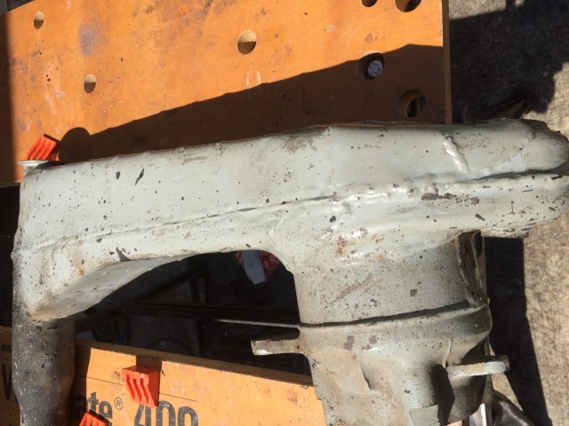

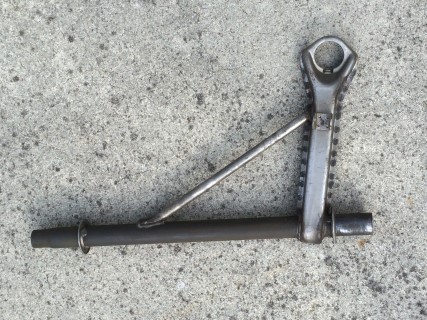

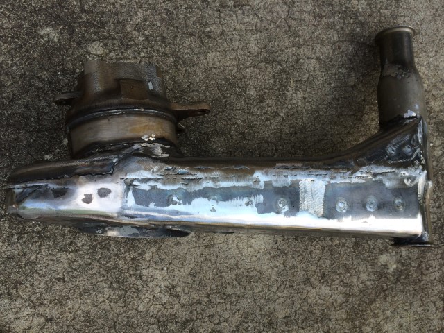

I removed the trailing arms and stripped them - I found two different types of delrin bushings on the pivot shafts, white on one side and black on the other. (IMG:style_emoticons/default/blink.gif)
Literally, I stripped them using EasyOff and then ground the welds where the swingarm stiffening pieces had been added.
Before:
After:

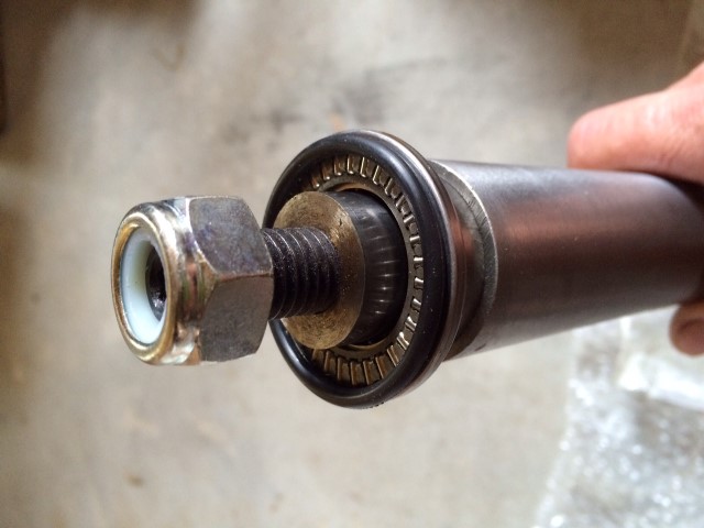

Then bead blasted them to get them clean, wiped them down, and powder coated them. Then installed a Mueller needle-roller bearing kit, zerk fittings, fresh hub bearings and cleaned up the wheelwells and the mounting points.
Attached ImageAttached ImageAttached Image
And now:
And the ride is SO MUCH BETTER!!! (IMG:style_emoticons/default/smilie_pokal.gif)
