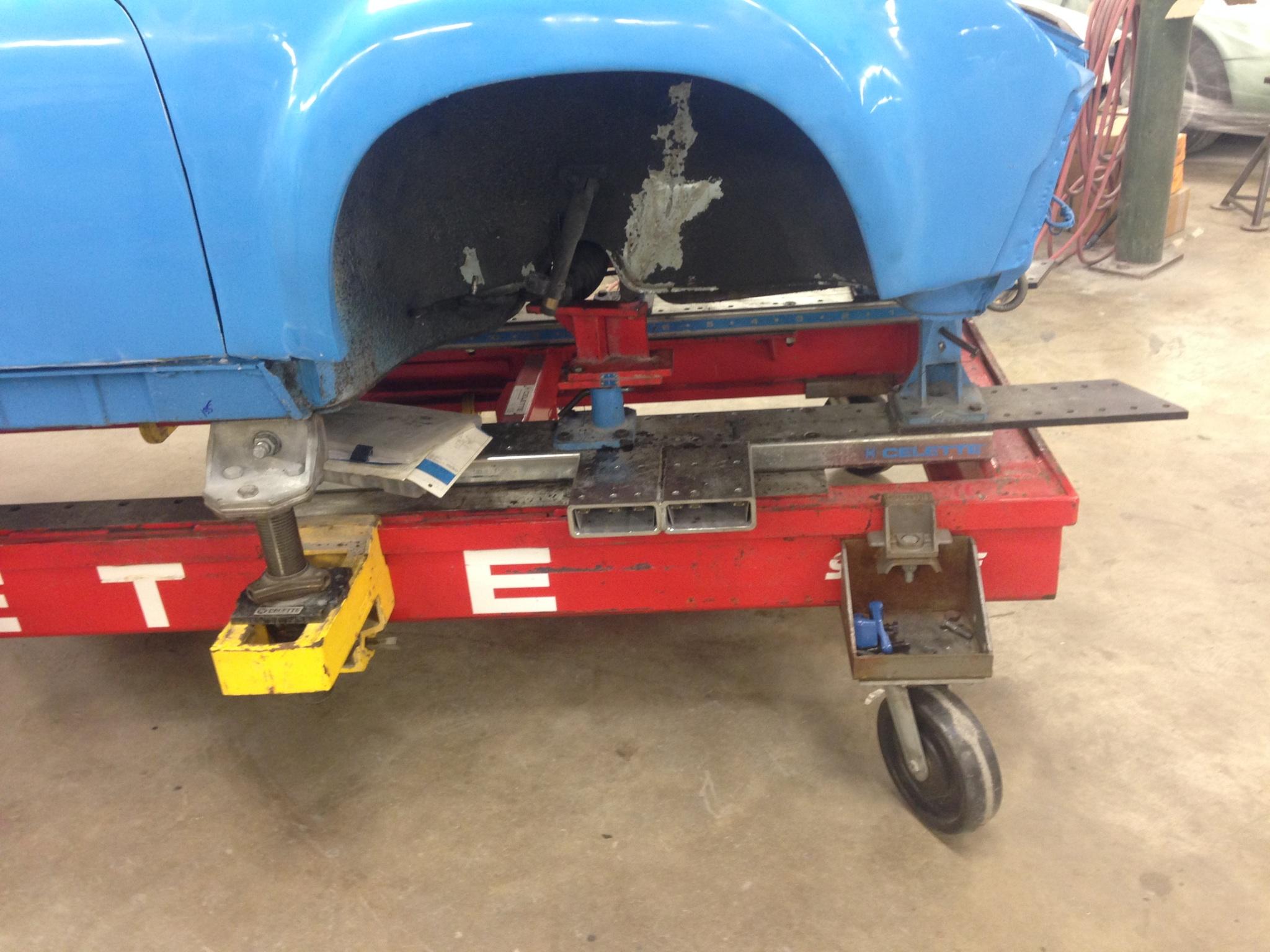

Crash, where did you have this done?
I'd like to have my car racked to take out the slight twist I put into it while welding the longs. And of course the hits it took before I took ownership.
How much did you have to remove from the car?
Zach

QUOTE(Vacca Rabite @ May 5 2015, 11:04 AM) *
Everything ...

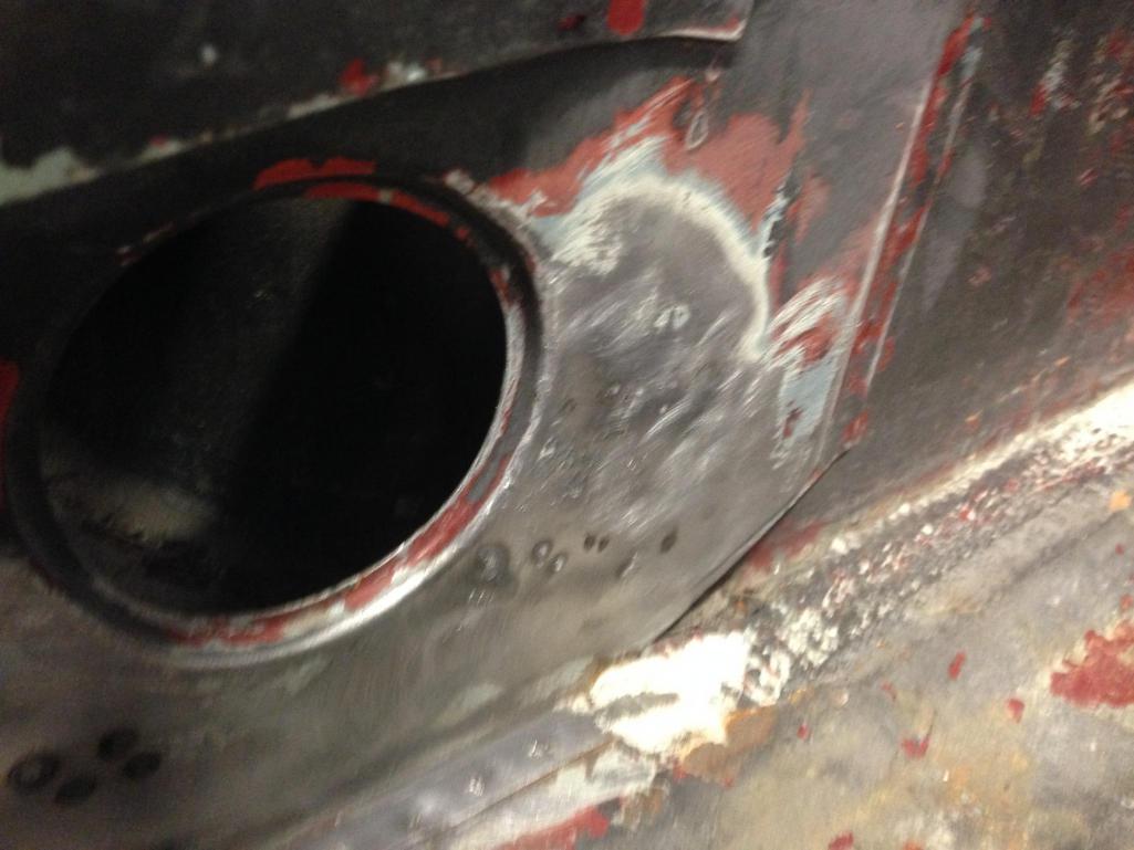

C orrect, everything. About 8 hours to get it on the rack. Its helpful that the front end is the saisme as a 911. The rear mounts were fabed. My chassis had a pretty good twist. I guess it took some doing to get the contact points down on the 4 corners. We have about 30 hours labor in it so far and I am doing the reinstall to keep costs down.

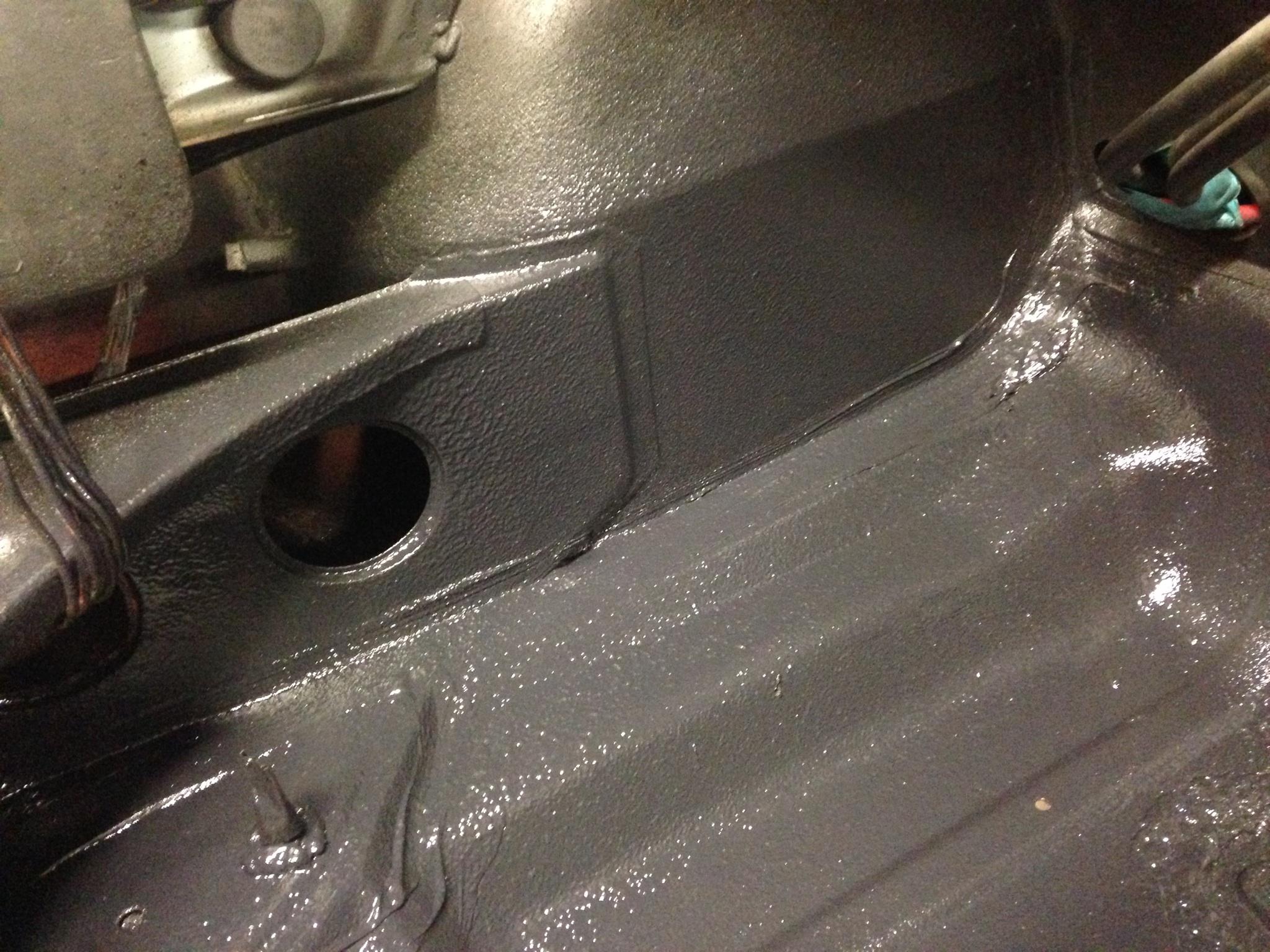

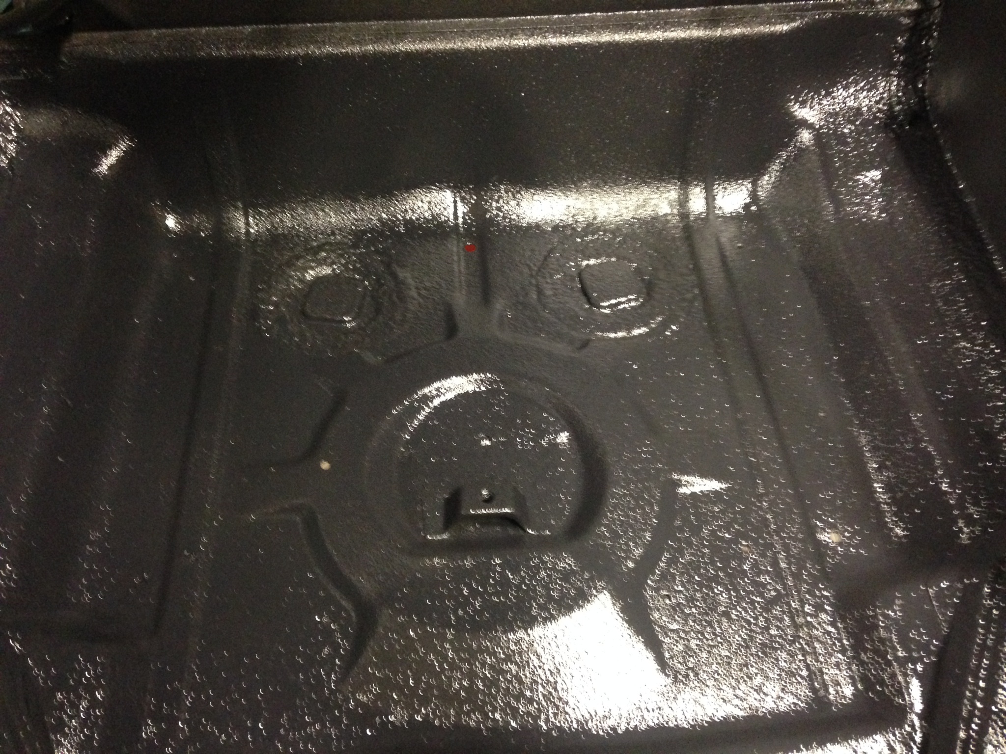

couple more....
final clean up.
Attached Image Attached Image Attached Image Attached Image Attached Image Attached Image

(IMG:style_emoticons/default/agree.gif) What name brand of schmutz is that?

QUOTE(altitude411 @ May 5 2015, 05:47 PM) *
http://dict.leo.org/#/search=Schmutz&s...rdShowSingle=on
(IMG:style_emoticons/default/lol-2.gif)

Ha, I think that the trunk stuff is "stone Guard" I am guessing its like Line X or something...undercoating.
