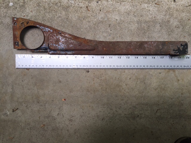

QUOTE(mepstein @ May 18 2015, 10:58 AM) *
QUOTE(914itis @ May 18 2015, 10:32 AM) *
QUOTE(mepstein @ May 18 2015, 01:05 AM) *
QUOTE(914itis @ May 17 2015, 11:32 PM) *
Ill get you one in tomorrow, but nothing is plumbed rom the top to the HE's
Do you have the hoses from the side of the alternator fan to the HE's?
Mark,
Looking at this picture , does the flex pipe shown attaches to a j pipe as in the T4's or does it go all the way down to the exchangers?.
Thanks
Goes through a hole on the engine tin down to the he's. All one length on each side. I have some factory tin if you need pictures and size for the hole in the tin.
Yes please with the size of the holes and the lenght of the hose if possible .
post May 18 2015, 09:28 AM
Post #22
914-6 GT in waiting
Posts: 20,587
Joined: 19-September 09
Member No.: 10,825
QUOTE(914itis @ May 18 2015, 11:00 AM) *
Mark,
Thanks
Holes are 65mm diameter. I don't know how long the hose is. I know people buy from aircraft spruce.com I'm guessing 2 feet on each side but it's just a guess. someone who has a 6 will probably know.

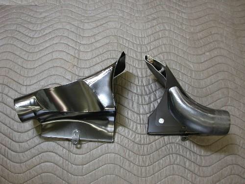

So Paul, do you already have a set of fan duct nozzles?
(IMG:http://www.914world.com/bbs2/uploads/post-10825-1431925778.jpg)
914itis
post May 18 2015, 10:58 AM
Post #27
Posts: 2,892
Joined: 9-October 10
From: New York City
Member No.: 12,256
Yes I do. They are currently capped.
