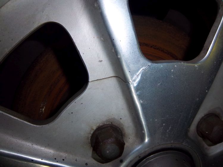

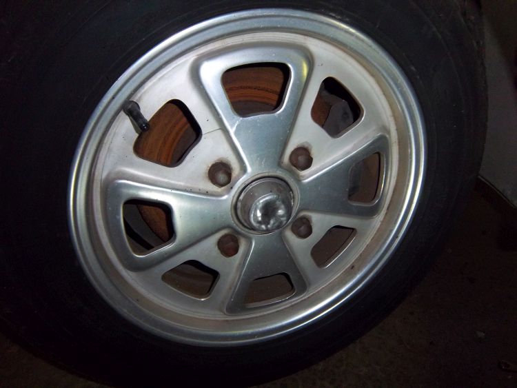

post Jul 6 2015, 06:48 PM
You bought another 914?
Posts: 7,643
Joined: 27-June 03
From: Portage, IN
Member No.: 865
Fuchs can crack for sure. This one was on a parts car I picked last fall. As you can see the rims had zero curb rash. Rim wasn't bent either. I always check my fuchs before any Autocross or track day.
