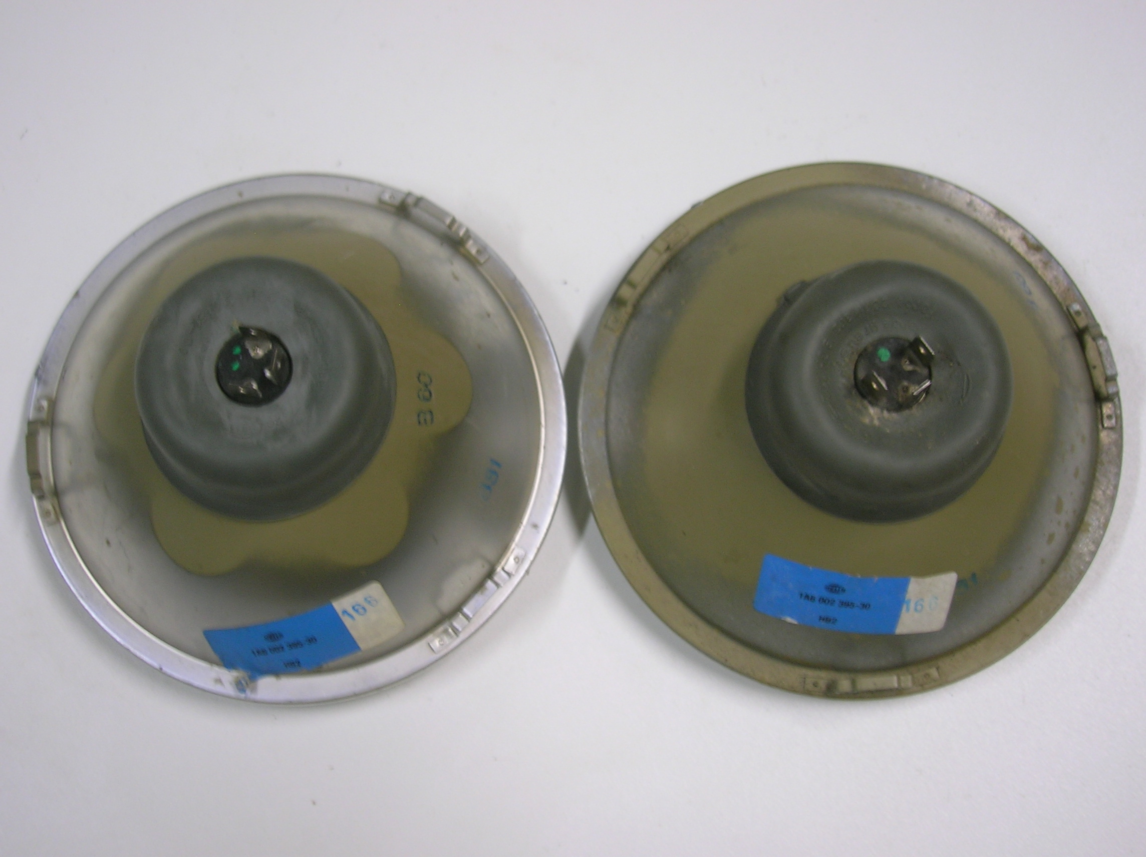

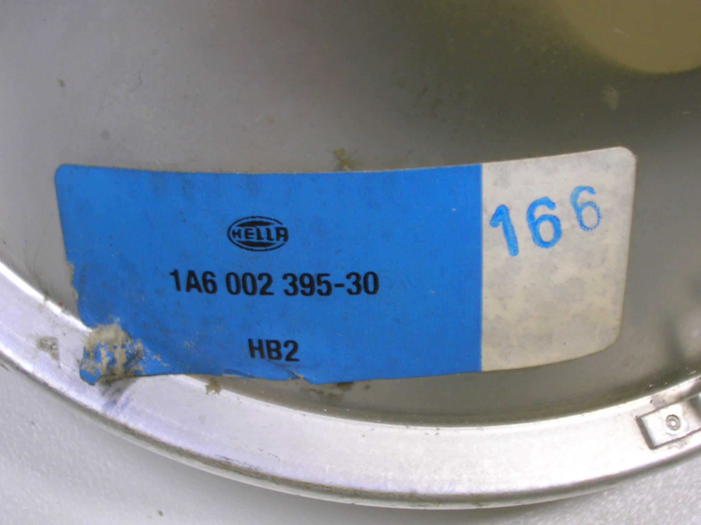

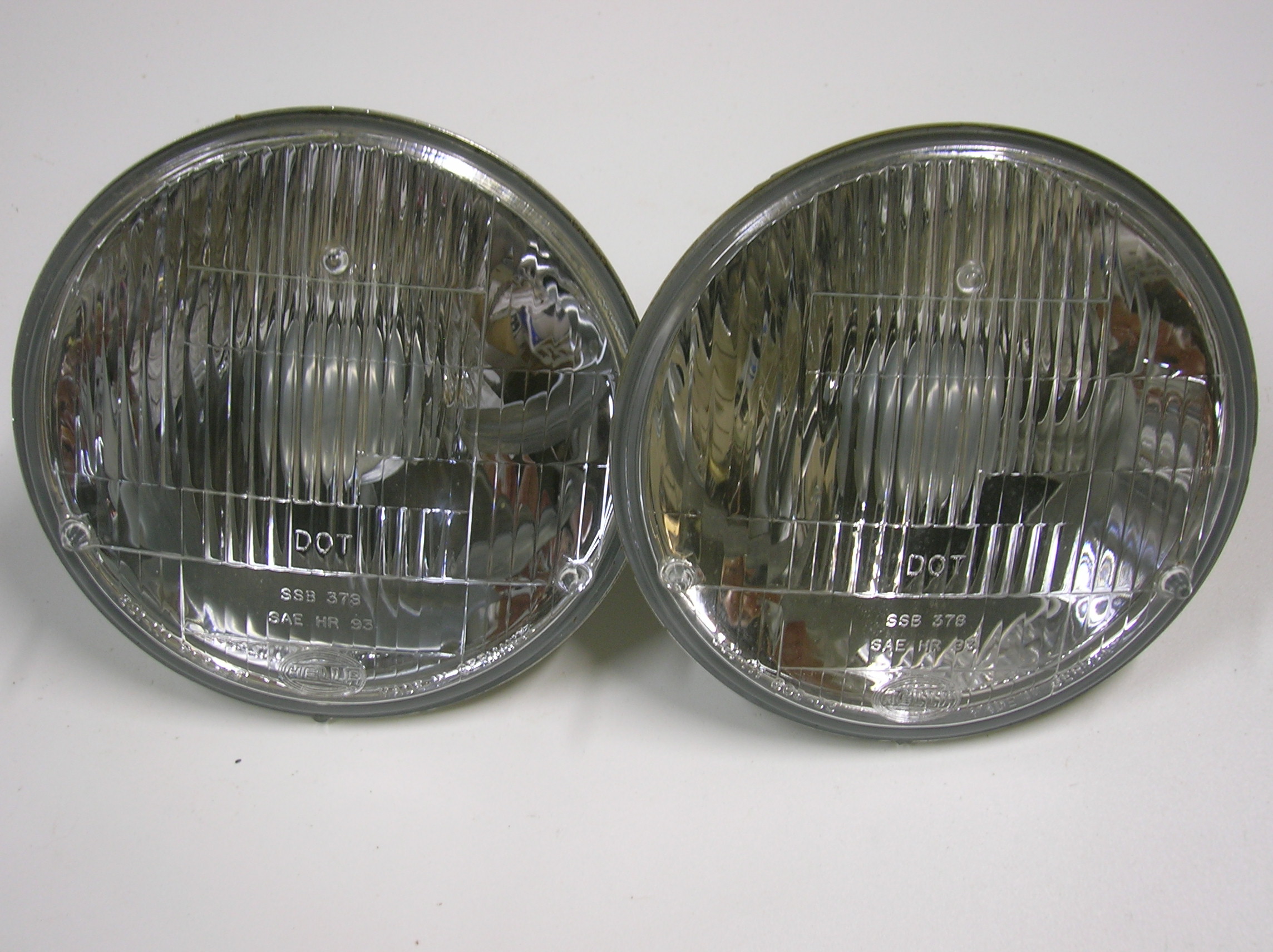

Ron...if you need/want a pair of Hella H4s... I have this set of excellent condition like new for $25 each unit plus shipping.
Std H4 12V 60/55W Halogen Bulbs
Thanks....John
Attached ImageAttached ImageAttached Image[attachmentid=507
657]Attached Image

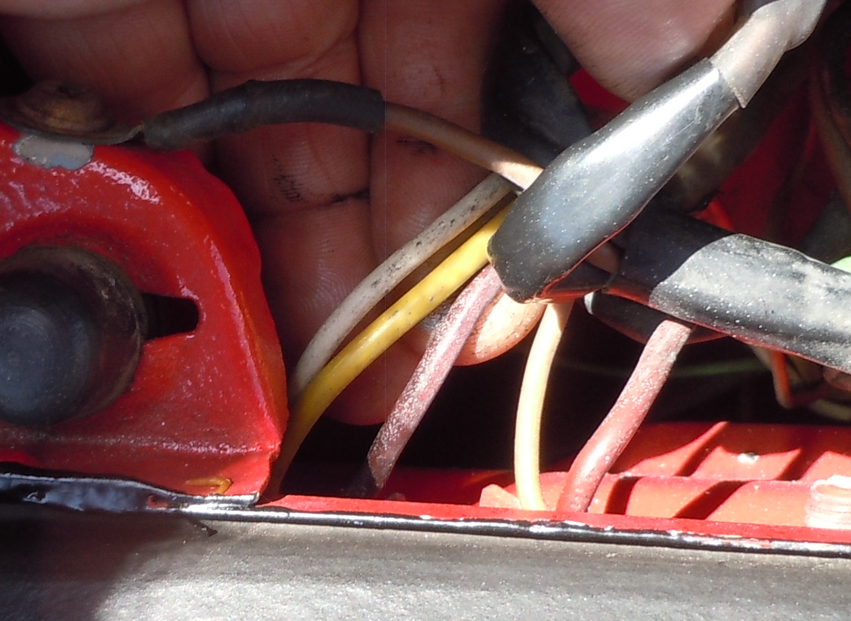

I contacted JWest Engineering about their 911 relay kits, 74-89 and 73 and earlier to see which one would be better for a 914. I converted my 75 914 to H4 headlights using 100w/55w bulbs.
Their response: "Neither, the 911 headlight circuit is very different from the 914. The 914 is actually much more robust. There is really nothing to gain from adding relays unless you are willing to run power from the battery directly to the front trunk, to feed the relays. Which is a lot of trouble and would most likely result in a negligible difference. James, JWest Engineering"
Here is a picture of my headlight wires. The ground (brown wire) and the yellow wire appear thicker than the white wire. I have used this set up for 3 years and have not had a problem. It still seems like a good idea to add relays to reduce the load on the switches. Attached Image
