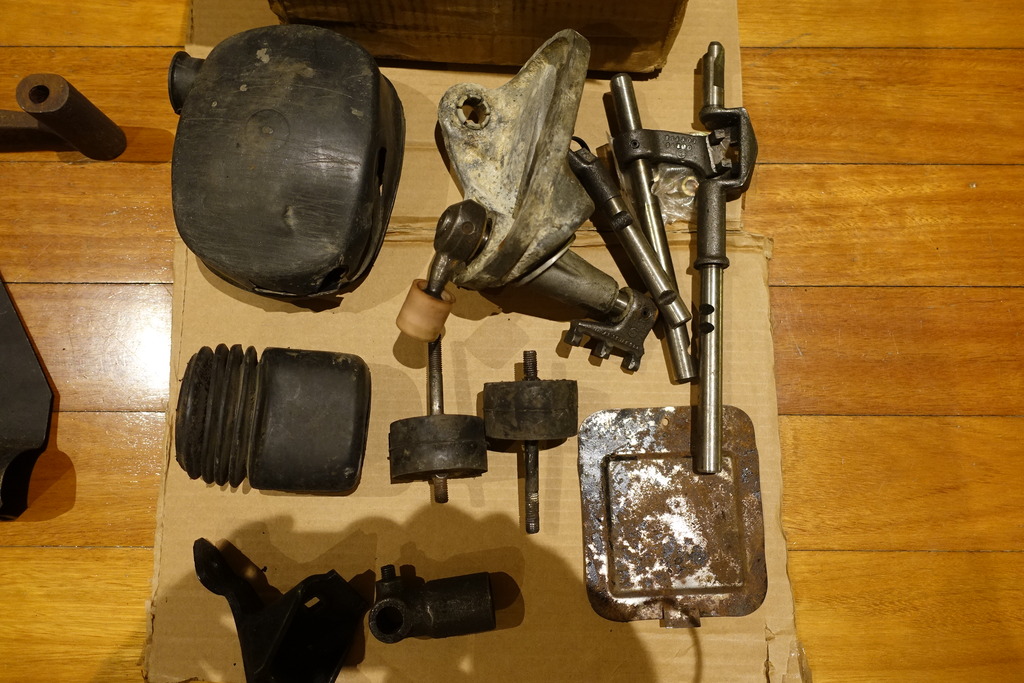

There are some very useful threads on here and pelican but none with all the bits I wanted in the 1 place. This isn't a how to, but more wanted to share some of my findings.
Thanks to a couple of newly found 914 friendships at home, I decided to have a crack.

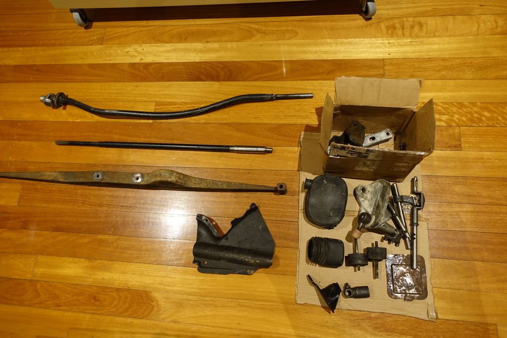

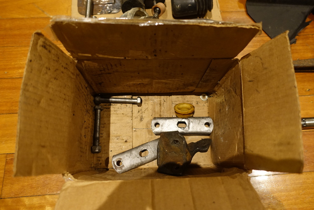

Rather than buy a complete side shifting transmission, I found that Brad Mayeur sold a "kit" of parts needed to do the conversion. Brad sold me everything needed.. and I mean EVERYTHING.
Shift lever and console, all the shift rods, coupler, side shift console, new engine mounts, engine cross bar, etc etc. He even included a new oil seal for the drive shaft in the box, and new exhaust gaskets.

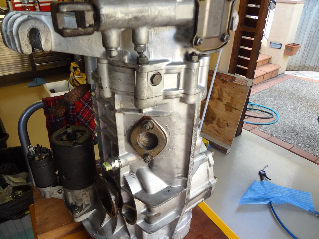

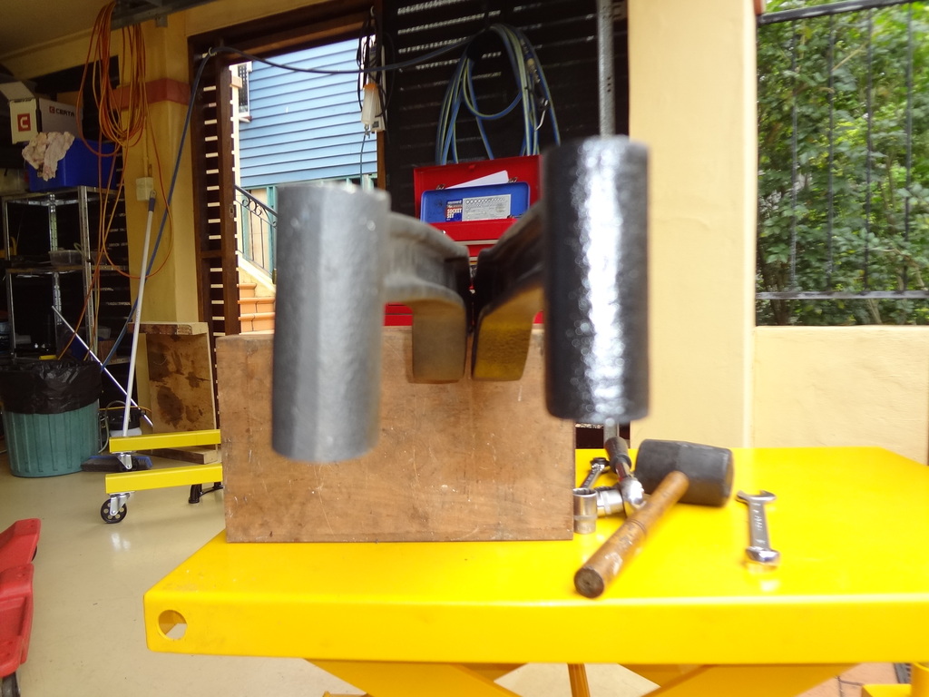

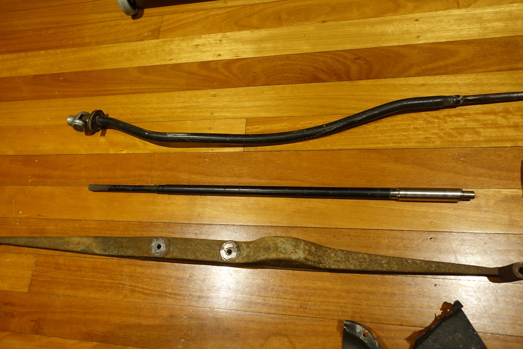

Here are some pics of the bits I received...
(IMG:http://www.914world.com/bbs2/uploads_offsite/i1260.photobucket.com-18462-1438894508.1.jpg)
(IMG:http://www.914world.com/bbs2/uploads_offsite/i1260.photobucket.com-18462-1438894509.2.jpg)
(IMG:http://www.914world.com/bbs2/uploads_offsite/i1260.photobucket.com-18462-1438894509.3.jpg)(IMG:http://www.914world.com/bbs2/uploads_offsite/i1260.photobucket.com-18462-1438894509.4.jpg)

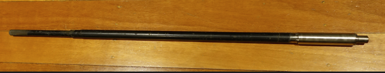

One point worth mentioning, is that the firewall bushing in tailshifter cars is different to side shifting cars.
But what Brad does, is weld a tube of the correct diameter, to the gear shift rod, so that where it exits the firewall, it is the correct diameter for the original bushing.
In this photo, you can see the steel sleeve on the right hand side...
(IMG:http://www.914world.com/bbs2/uploads_offsite/i1260.photobucket.com-18462-1438896447.1.png)

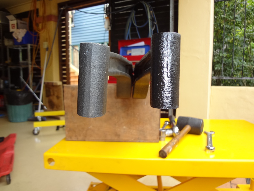

Interestingly, because my car has a non original, 2litre motor, I thought that some parts were original.
My car already has the solid engine mounts so I did not use the ones that Brad provided me. Plus my engine mount bar was the same.. or at least I thought it was.
When I first installed the transmission, everything lined up great, but when trying to select 4th or 5th, the rod would bind in on the bar...

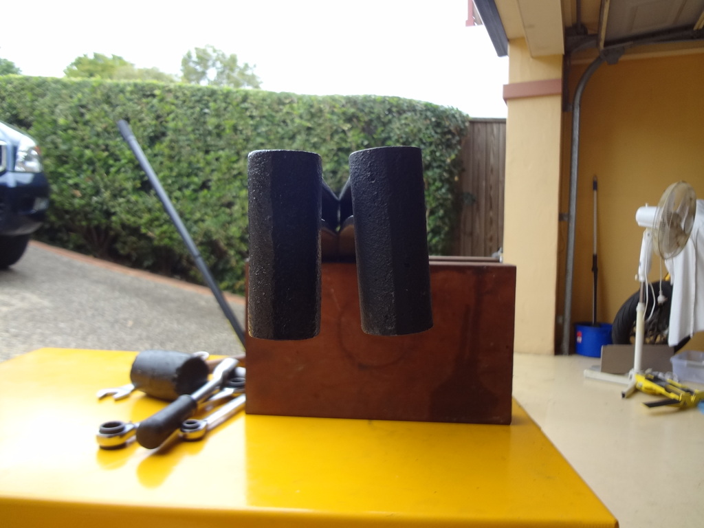

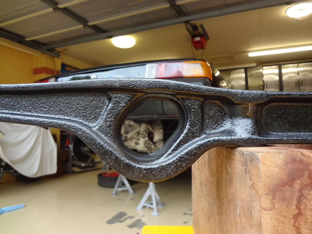

I took my original bar off the car and CLOSELY lined it up with the one from Brad, and it seems there IS a small difference! I tried to take some photos to show, but basically, the bar for a sideshift is about 5mm difference on the drivers side, to give that all important clearance.
looks same here
(IMG:http://www.914world.com/bbs2/uploads_offsite/i1260.photobucket.com-18462-1438972107.1.jpg)
passenger side also looks same
(IMG:http://www.914world.com/bbs2/uploads_offsite/i1260.photobucket.com-18462-1438972107.2.jpg)
But drivers side shows the difference.. the shiny one is the side shift bar freshly painted.
(IMG:http://www.914world.com/bbs2/uploads_offsite/i1260.photobucket.com-18462-1438972108.3.jpg)

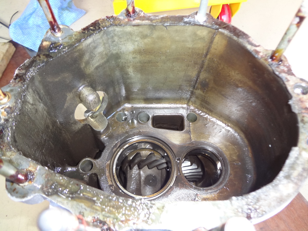

When I removed the rear cover, this is what I found...
(IMG:http://www.914world.com/bbs2/uploads_offsite/i1260.photobucket.com-18462-1438972707.1.jpg)

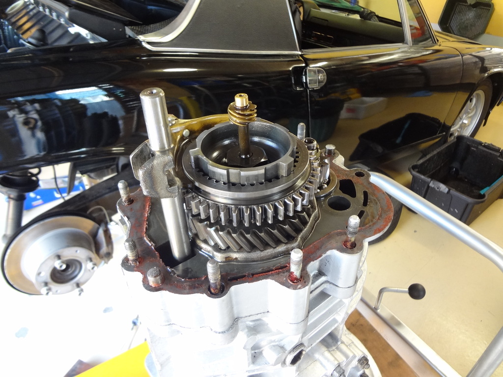

need to select 5th gear....before removing the cluster from the case...
You can see the end of the selector rod at the centre bottom of the photo, poking through the intermediate plate.. I pushd it all the way in with a socket extension.. it make a nice "click" as the gear selected..
This slides the brass shift fork down, and creates a bit of space to help manouvre the gear stack out of the case.
(IMG:http://www.914world.com/bbs2/uploads_offsite/i1260.photobucket.com-18462-1438973016.1.jpg)

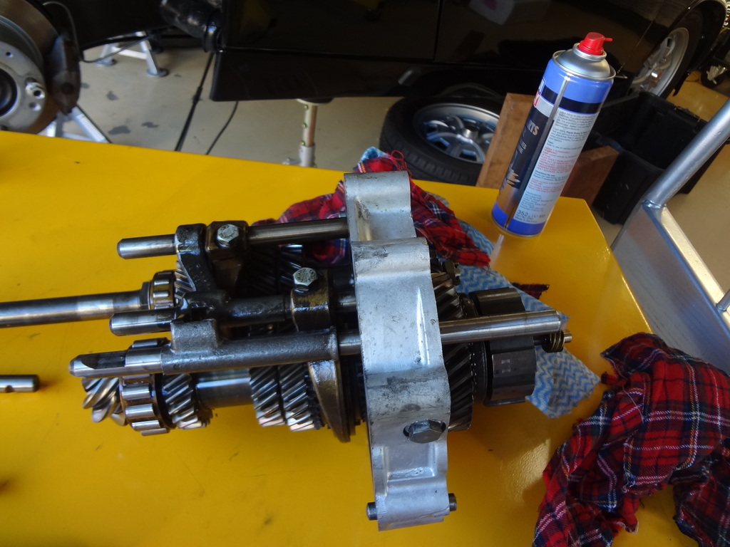

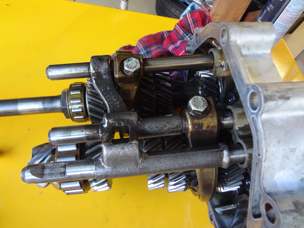

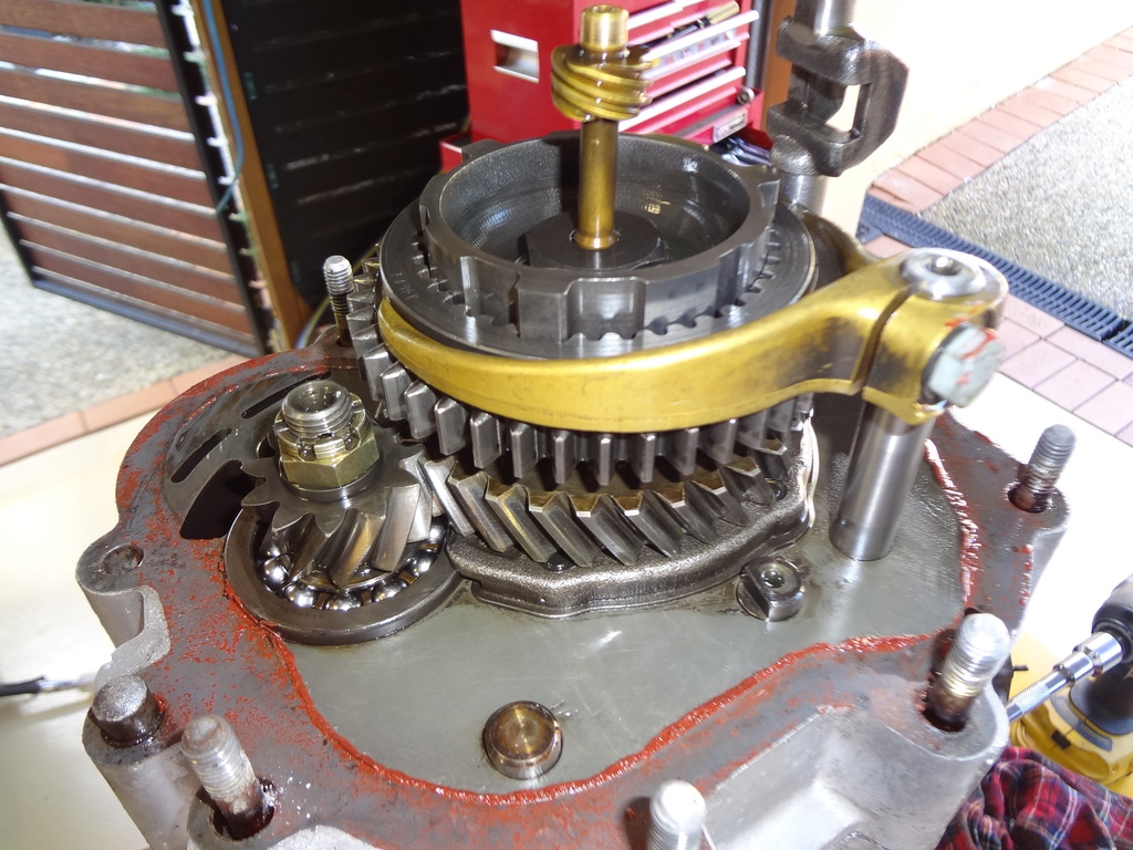

Here is the gear stack... took a few taps with a mallet to get it to come out.
You can see the funny shift rod that goes through the intermediate plate and has the dongle thing on the end that rotates through the shift rods and selects the gears. Very intersting and good learning experience this!
(IMG:http://www.914world.com/bbs2/uploads_offsite/i1260.photobucket.com-18462-1439081296.1.jpg)

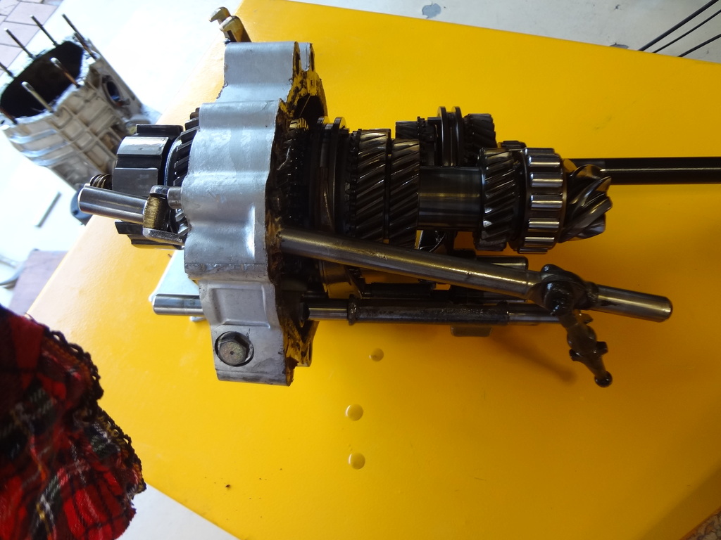

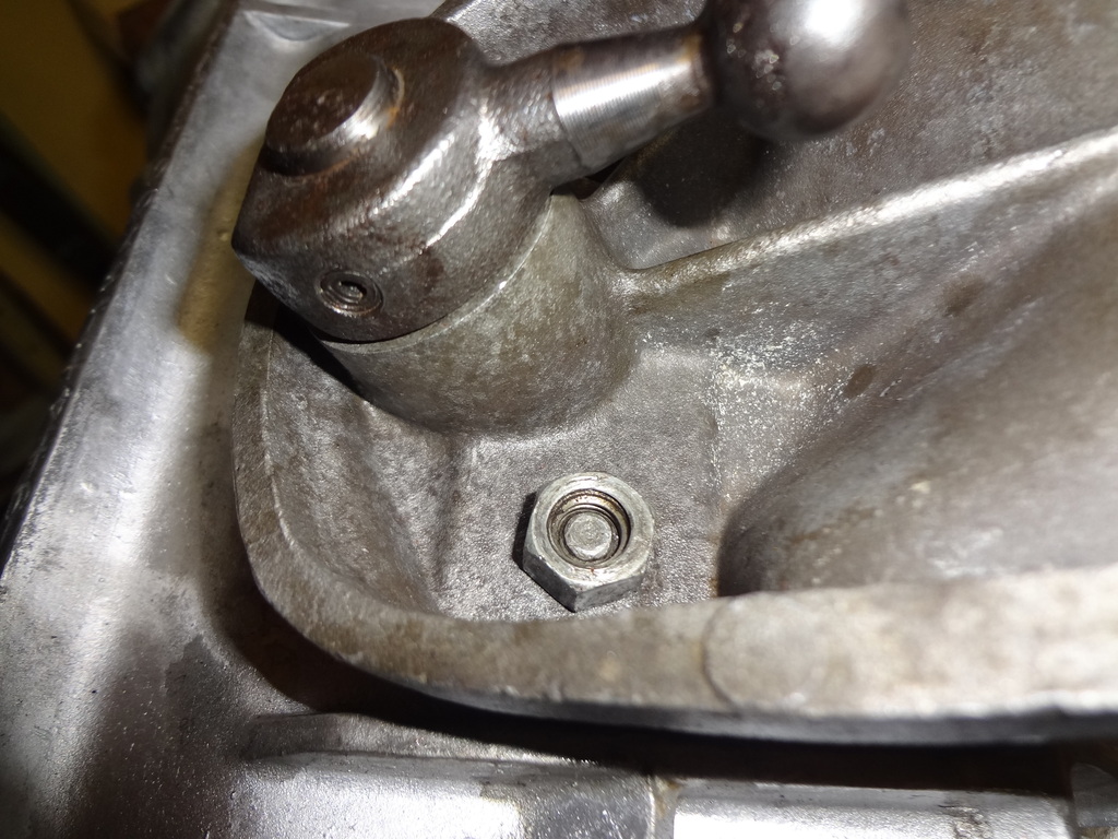

Anyhow, I wanted to remove this dong thing forever.. and to get it out is harder that I thought. Remove a split pin, then you have the DRIVE the steel pin out. It is an interference fit.. and with my tennis elbow condition at the moment, I took quite a few goes to get it out.
(IMG:http://www.914world.com/bbs2/uploads_offsite/i1260.photobucket.com-18462-1439081491.1.jpg)

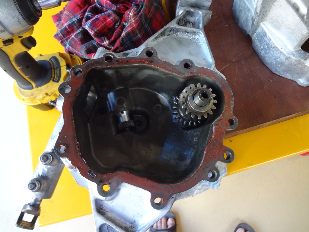

Here is the inside of my case..
(IMG:http://www.914world.com/bbs2/uploads_offsite/i1260.photobucket.com-18462-1439081537.1.jpg)

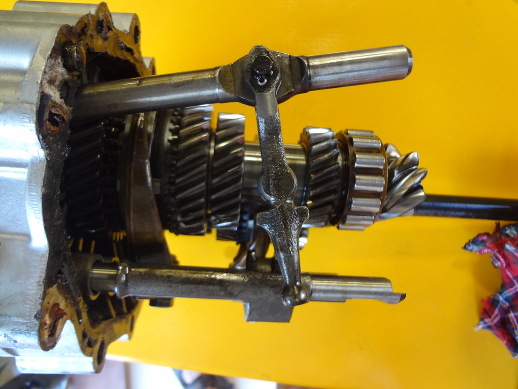

Here are the tail shift selector rods...
(IMG:http://www.914world.com/bbs2/uploads_offsite/i1260.photobucket.com-18462-1439081634.1.jpg)
The next bit is tricky...
mikedsilva
post Aug 8 2015, 06:56 PM
Posts: 90
Joined: 23-February 15
From: Australia
Member No.: 18,462
Region Association: Australia and New Zealand
(IMG:http://www.914world.com/bbs2/uploads_offsite/i1260.photobucket.com-18462-1439081801.1.jpg)
See that bolt head on the bottom of the intermediate plate?
That comes out, to release a series of ball bearings, springs etc.. which provide the "click" for the shift rods when they engage a gear... I didn't take any photos, but its all pretty simple.. undo the bolt, the first ball and spring comes out, then you can remove the rod..
Undo the bolt clamping the brass shift fork to the rod first...

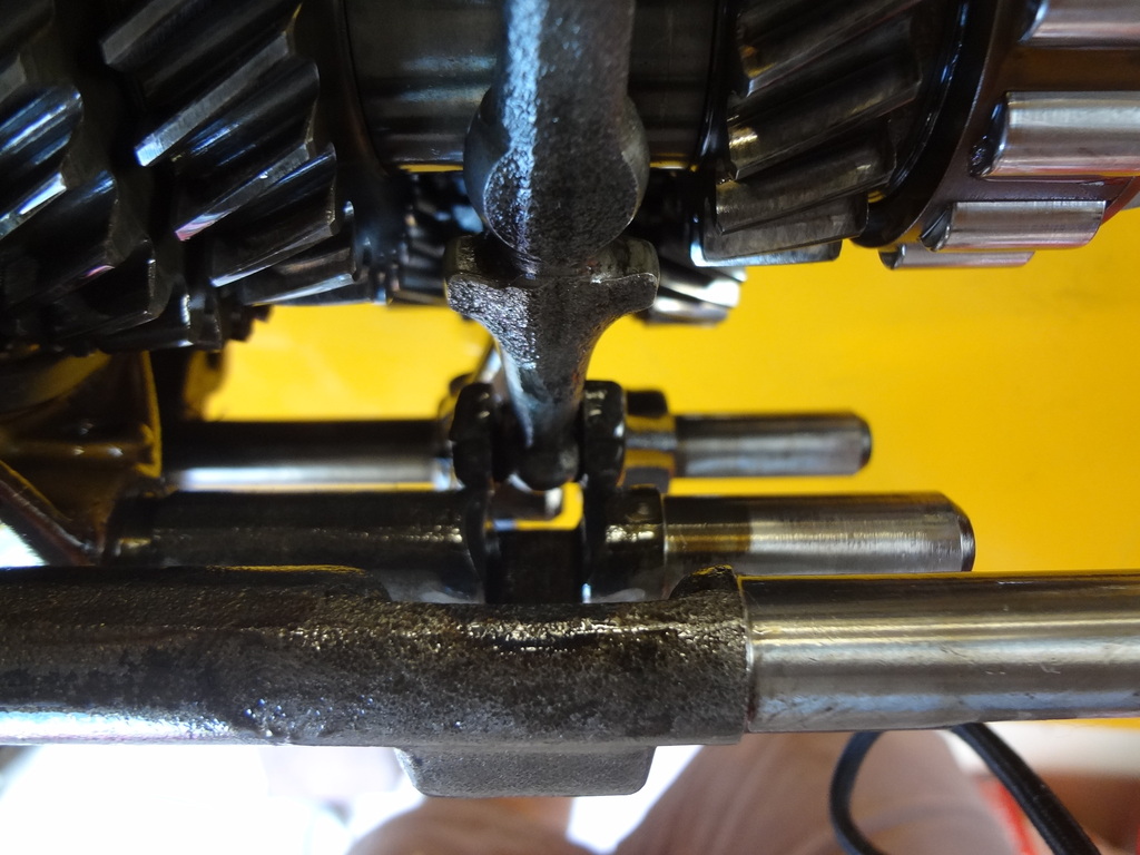

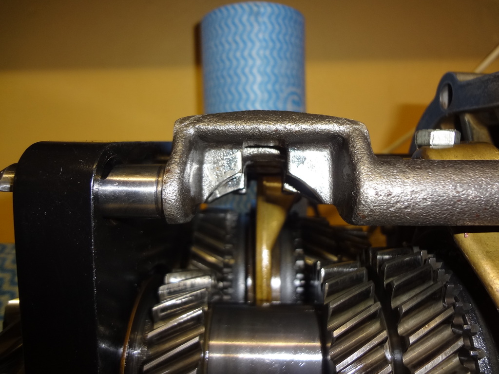

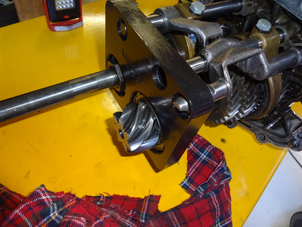

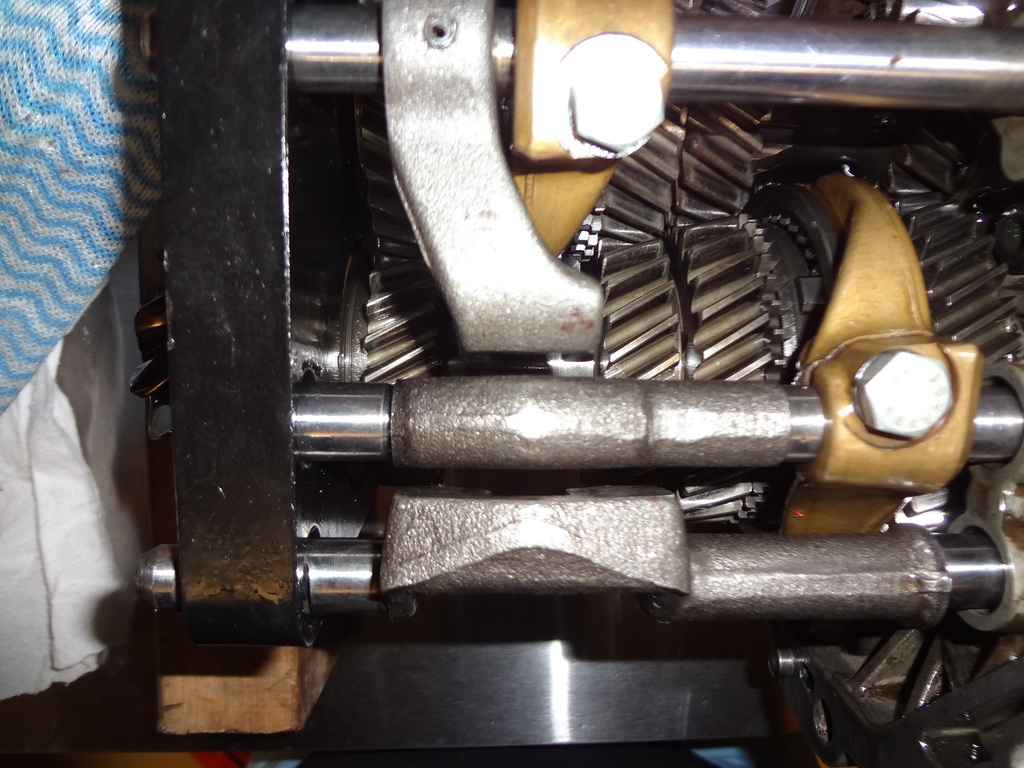

Now the fun part of aligning the shift rods...
(IMG:http://www.914world.com/bbs2/uploads_offsite/i1260.photobucket.com-18462-1439081943.1.jpg)
(IMG:http://www.914world.com/bbs2/uploads_offsite/i1260.photobucket.com-18462-1439081944.2.jpg)

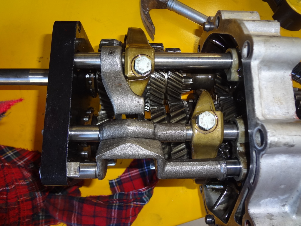

In the end I chickened out, and got my friend Dave to come over the share his experience of aligning the rods as he has been inside these gearboxes before..
(IMG:http://www.914world.com/bbs2/uploads_offsite/i1260.photobucket.com-18462-1439082035.1.jpg)
mikedsilva
post Aug 8 2015, 07:03 PM
Posts: 90
From: Australia
Member No.: 18,462

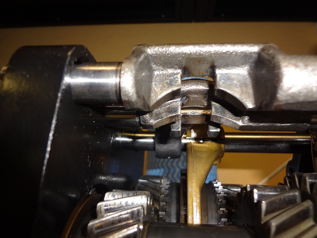

It's a really finicky process, since you want a straight shot between all the shift rods, so the shift COMB from the side console, can go back and forth perfectly and also to have enough throw, to select each gear position forwards and backwards.
In addition to this, the brass shift fork needs to be aligned so that the dog teeth for either gear on either side of the syncro band, do not overlap the syncro band...
