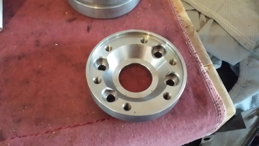

I bought these conversion pieces for axles. They bolt to my 4 bolt stub axles then got to 100 mm cv outboard and 108mm inboard.
Pretty cheep.

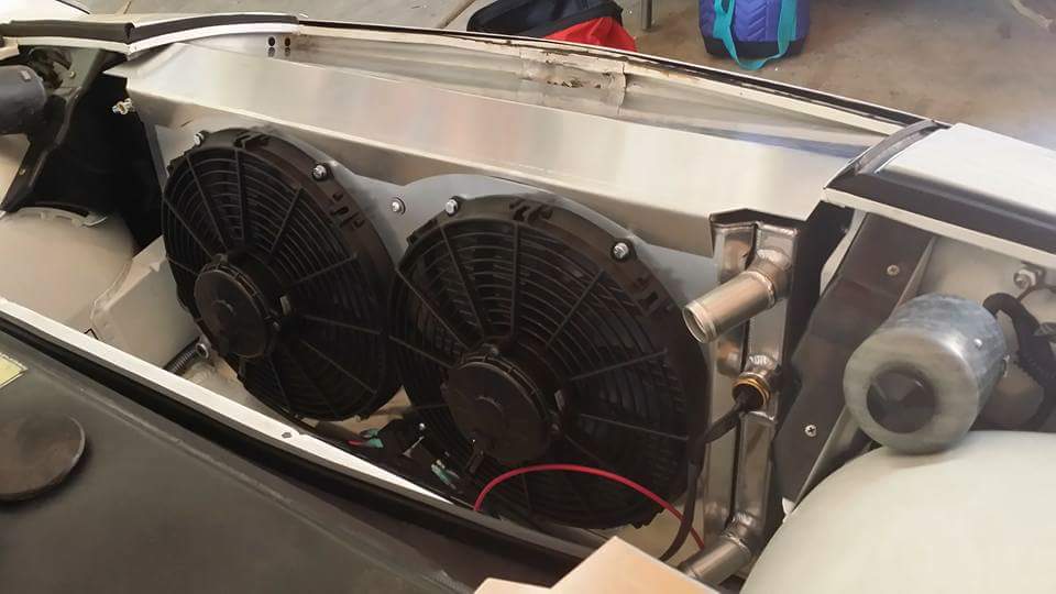

(IMG:http://www.914world.com/bbs2/uploads_offsite/i1315.photobucket.com-15718-1439041547.1.jpg)
Here's where I'm at (IMG:style_emoticons/default/biggrin.gif)
(IMG:http://www.914world.com/bbs2/uploads_offsite/i1315.photobucket.com-15718-1439041547.2.jpg)

I forgot to mention that Patrick Motorsports sells a 94mm (914) to 108mm adapter.
http://www.patrickmotorsports.com/part/rea...4-transmission/
You can bolt this on to your stub and run 108mm CV's. If you buy off the shelf parts like this and what I posted above, replacement is easy. No custom machine work required.
[/quote]
Thanks for the advise, this is a great option. The tub I bought came with 914 hubs that were already drilled for 5 lugs. At this point, not really sure which route to go, but I do know that I will scratch off the axle kit from the order list at Renegade.
That transmission mount looks pretty cool, is that what I should expect from Renegade, never seen a picture of it. That adapter plate looks pretty thick, was that made from Kennedy Adapters? Kennedy pretty much told me to screw off once they knew I was trying to mate a LS4 to a Boxster 6 speed. The LS4 has no provisions for a starter, same holds true for the Boxster transaxle. After some intense searching, I found a company that has mated these two before and only charges 1500 for the adapter plate, flywheel, pressure plate, clutch and starter. The LS4 seems pretty popular with the Fiero crowd, and has been even installed in a MGB! I also like the idea that this engine can disable 4 cylinders at freeway speeds to conserve fuel. This will be a fun project! (IMG:style_emoticons/default/driving.gif)
