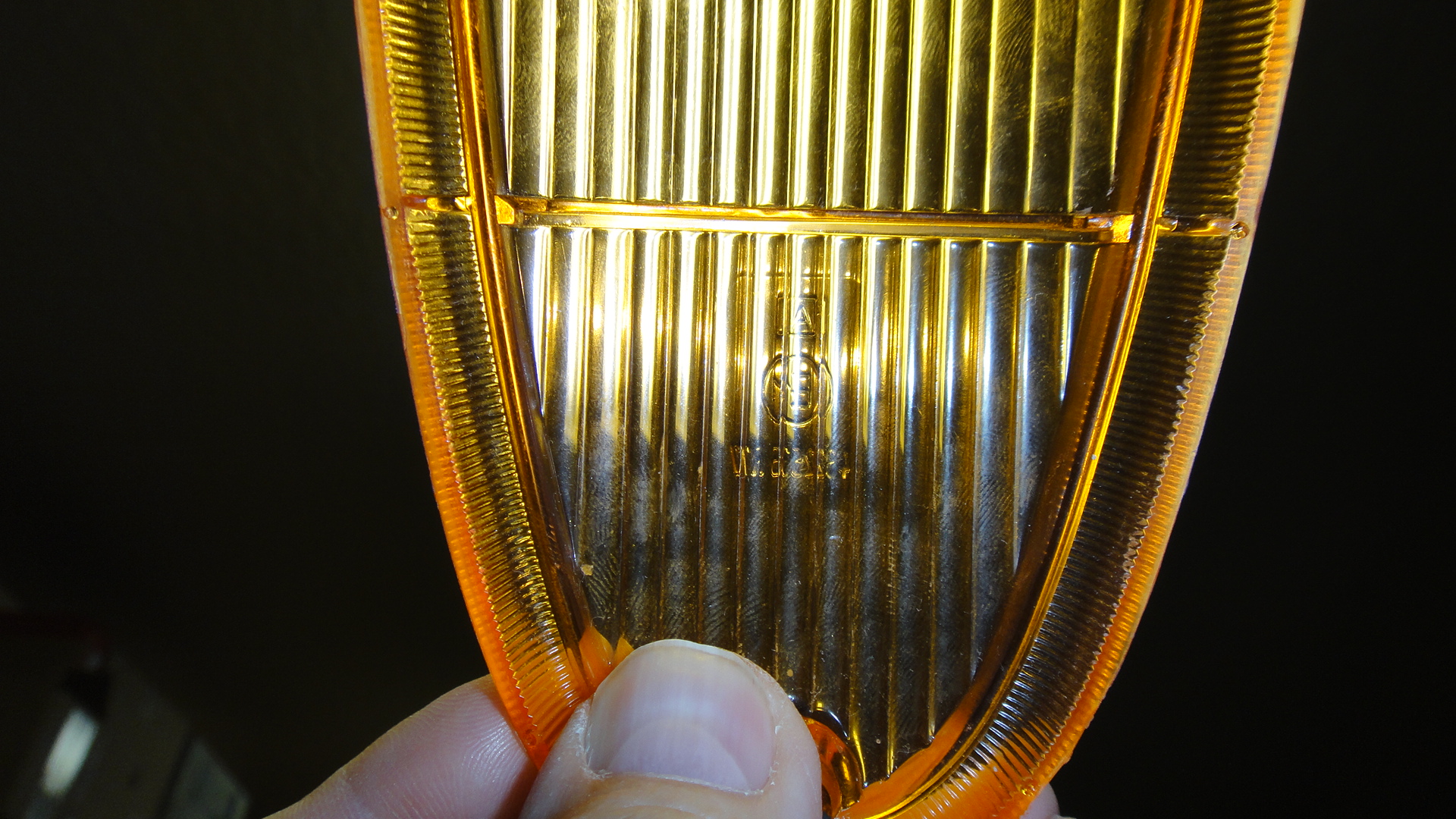

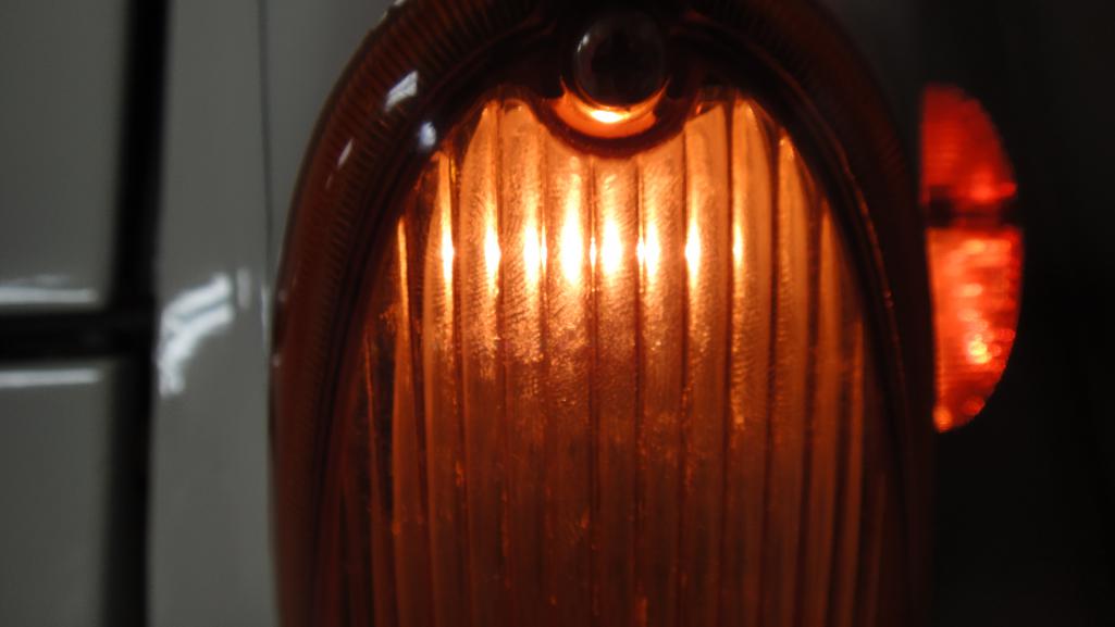

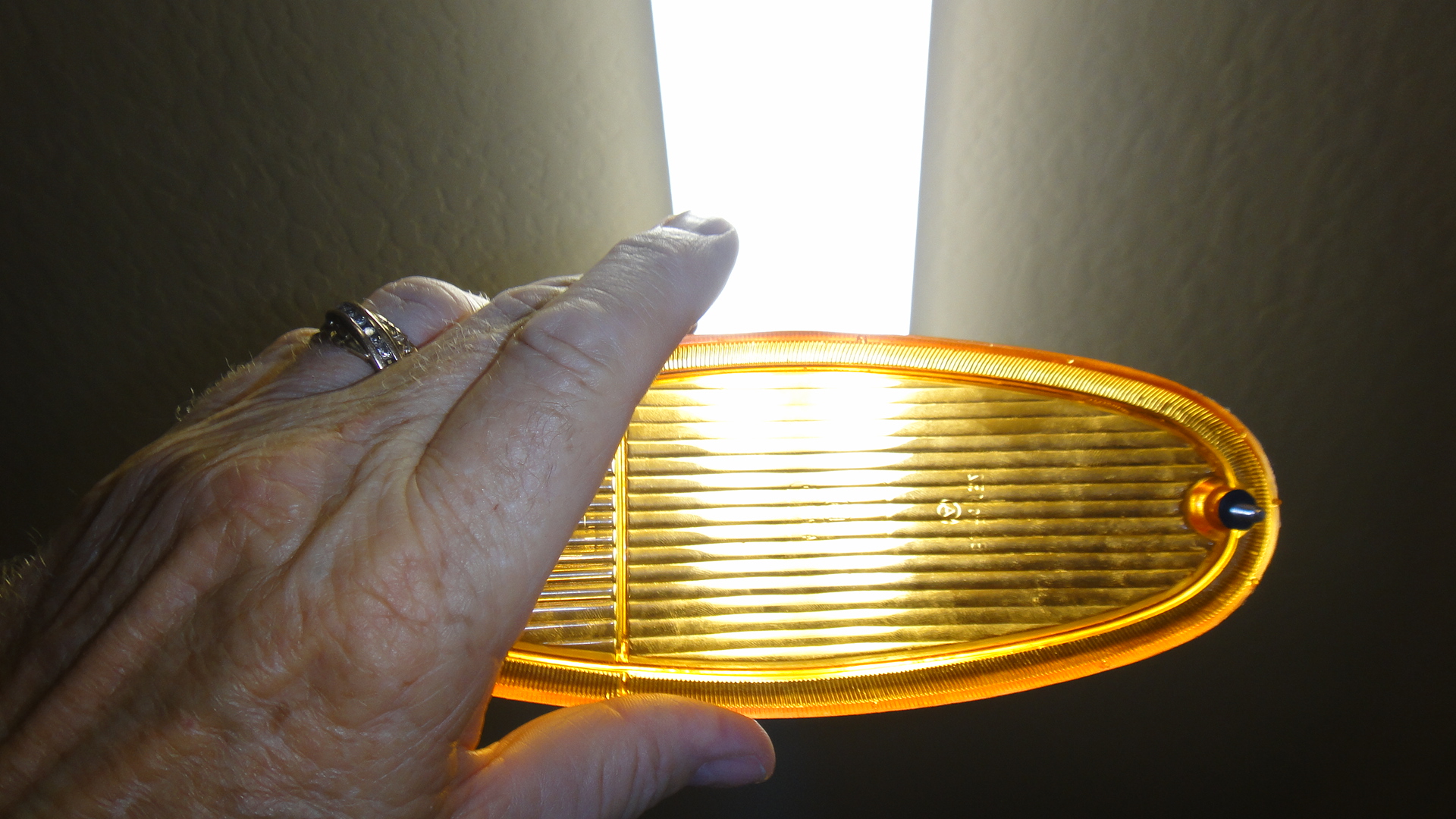

I ordered these from 914Rubber, The side marker lens look good, but the front turn signal lens look terrible. There's a haze in a lot of areas on inside of lens, and finger prints in bedded in the plastic???? Tried some polish cutter, and it's still there. They look pretty bad in the daylight, and when there on they look worse. I tried my best to get a good picture, and i think this shows some of the problem. (IMG:style_emoticons/default/sad.gif) (IMG:style_emoticons/default/blink.gif)

Yes no problem with replacing or exchanging. You can usually PM me here for fastest response as it's tied to my phone for notifications. I actually would have seen it before I saw it on the thread. I have nothing to hide, but I can deal with it faster.
As you can see we do hand cast these. and this one obviously was touched on face before it was post cured. I'm cross training my guys and try to keep an eye on what's being done, but it's easy to miss something with all that's going on. On the good side, our post cure process is good if you can't easily polish it out It does help show some of the behind the scenes on how these are made. They most definitely aren't made in a factory in China, the finger prints would be smaller. (IMG:style_emoticons/default/biggrin.gif)

Checked my inventory, looks like the last time we recast this mold (a few weeks ago) someone wasn't using gloves when casting. This is an issue on our end that will take about a week to resolve, but I will be selling seconds in the classifieds soon. We are recasting and should have materials available in about 10 days.
