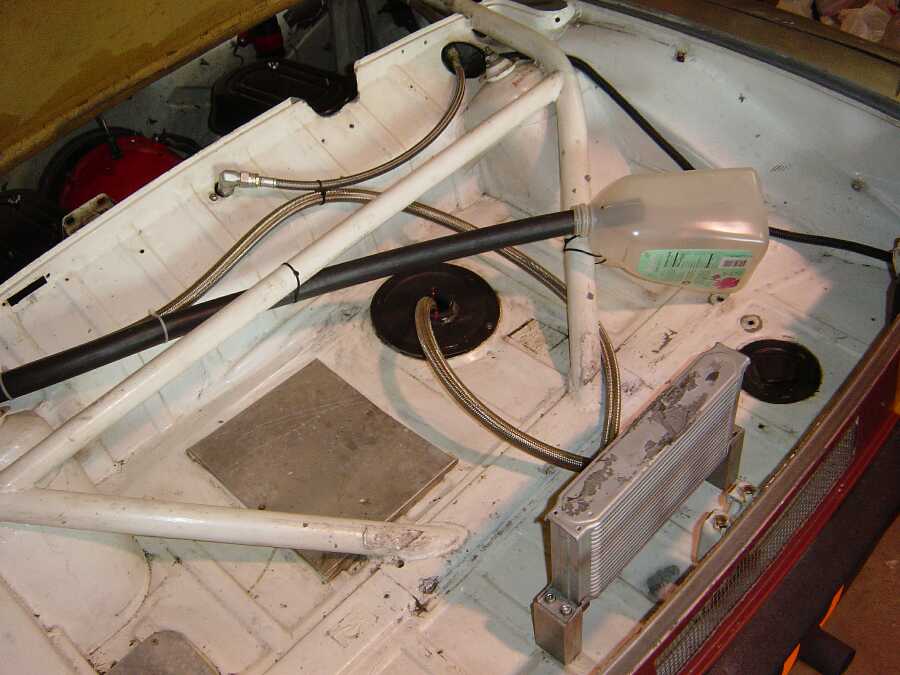

I used to use an old Arizona ice tea bottle
gms
post Sep 8 2015, 05:32 PM
Posts: 2,738
Joined: 12-March 04
From: Chicagoland
Member No.: 1,785
then I re-purposed a washer bottle

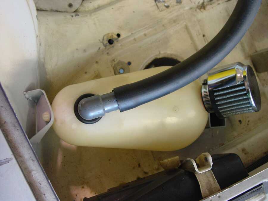

t collins
post Sep 8 2015, 06:41 PM
Posts: 3,270
Joined: 21-March 06
From: Virginia
Member No.: 5,754

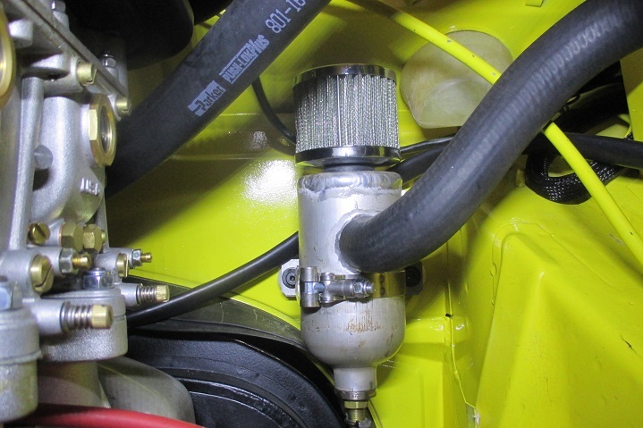

Less that 2000 miles on it and clean operation so far

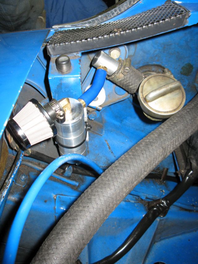

I really wanted to make something small and out of the way, so I got
this motorcycle one and made an elbow and bracket. It screws into the
existing hole that I think would have been used to hold the rain tube.
porschetub
post Sep 8 2015, 08:02 PM
Posts: 5,064
Joined: 25-July 15
From: New Zealand
Member No.: 18,995
QUOTE(t collins @ Sep 9 2015, 12:41 PM) *
Any hassles doing valve clearances etc or do you just move it out of the way?.
Looks great and most likely the way I'am heading.
t collins
post Sep 8 2015, 08:46 PM
Posts: 3,270
Joined: 21-March 06
From: Virginia
Member No.: 5,754
QUOTE(porschetub @ Sep 8 2015, 07:02 PM) *
No clearance issues, I can pull #6 spark plug as is and it's easy to remove if every necessary.

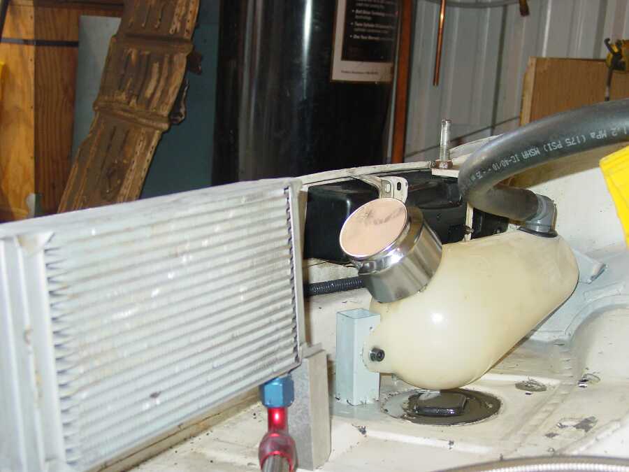

PanelBilly
post Sep 8 2015, 09:43 PM
Posts: 5,950
Joined: 23-July 06
From: Kent, Wa
Member No.: 6,488

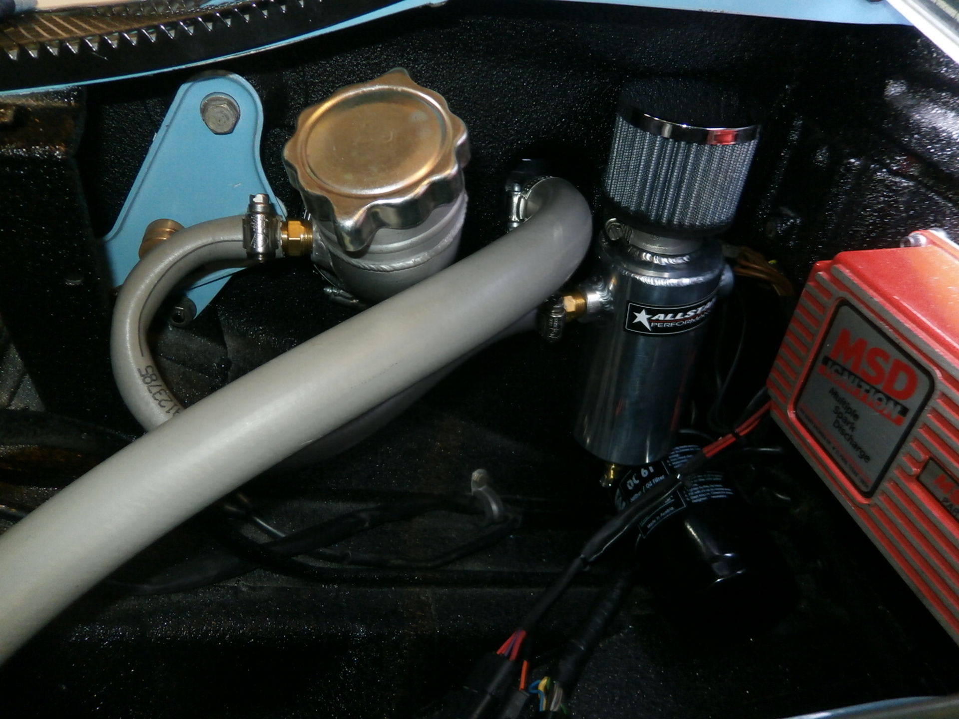

I had the fill neck modified with a threaded bung so I could use a more secure method of attaching the hose line.

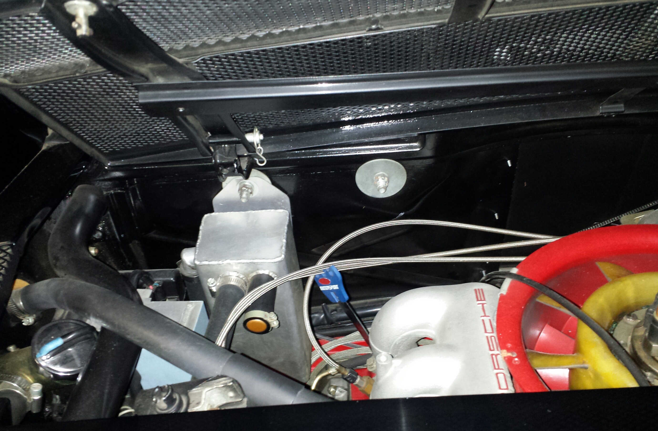

Tig welded aluminum catch can, breather tube to bottom with a small S+B cleanable filter. Also an extra breather input (capped) for any future uses.Attached Image
