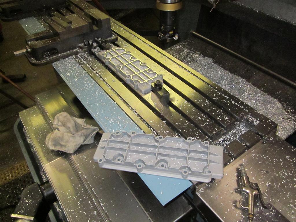

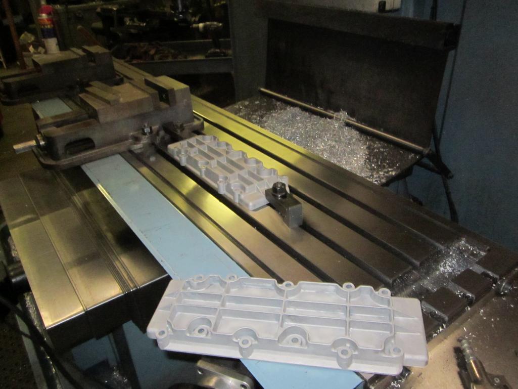

I have a customer who wants to add billet lower valve covers to a 6 conversion. He had one machine shop botch the first pair. Anybody done this and know how much material needs to be removed to clear the suspension point? I drawing showing the area to machined and the finished thickness would be ideal.
Please pm me if you can help
Luke M
post Sep 18 2015, 10:01 AM
Posts: 1,565
Joined: 8-February 05
From: WNY
Member No.: 3,574
Had this done not too long ago. The machine shop shaved all the fins down on the lower turbo valve covers to the same height as the stud mount holes.

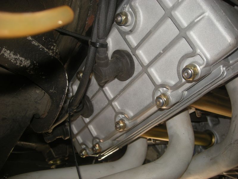

Turbo covers are heavy, you likely could take the fins right off. Mine are also shaved down to the top of the stud bosses, about 1/4" of fin left.

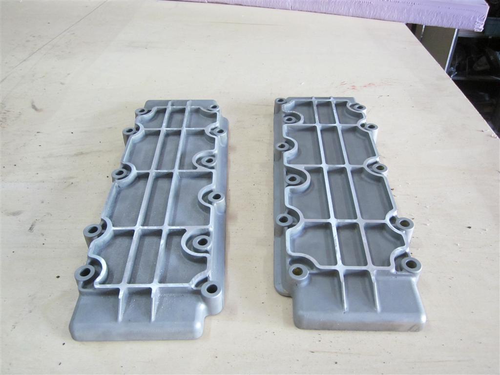

heres what scotty did.
0396

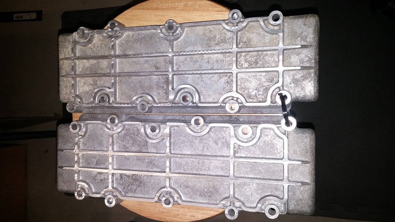

No need to shave the whole valve cover. The extended fins are there for cooling. Based on my little knowledge, all one has to do is to reduce #5&6 cylinder side .
gereed75
post Sep 18 2015, 07:27 PM
Posts: 1,446
Joined: 19-March 13
From: Pittsburgh PA
Member No.: 15,674
QUOTE(396 @ Sep 18 2015, 08:54 PM) *
This is all that needs to be done

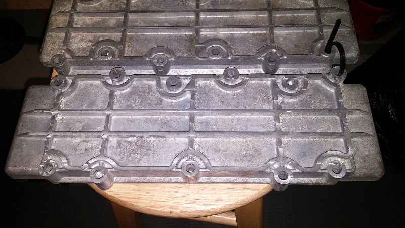

pete000
post Sep 19 2015, 12:08 AM
Posts: 1,887
Joined: 23-August 10
From: Bradenton Florida
Member No.: 12,094
QUOTE(gereed75 @ Sep 18 2015, 06:27 PM) *
This is what mine look like...They did not machine off the whole cover just the corner.

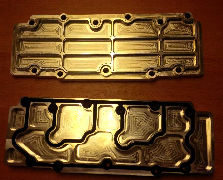

If you are not hung up on the O.E. look I highly recommend these Hargett Precision billet covers, they utilize the later 964 type cord seal. This ended years of leaks on my 914.
