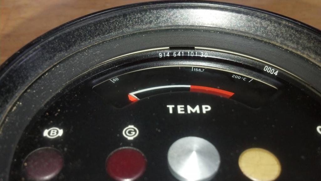

I found that when I tipped my gauge up, there was a range written at the very top.

Exactly what I was looking for, thanks!
So the "redline" starts at 316°F (IMG:style_emoticons/default/blink.gif) Looks like I should invest in a gauge with a little more resolution. Can I use the existing wiring and sender with an aftermarket VDO?

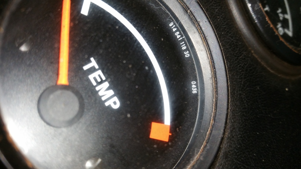

Looking again, my gauge is a different than yours. Here is a pic of mine, there aren't any temp numbers on mine.

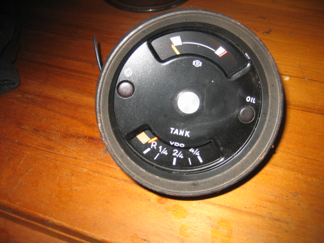

I have been mucking around with these gauges for a while,I think the one you have reads to 150C,this is a pic of one I built;Attached Image.
Yours is unmarked in the upper part of the insert but i'am fairly sure it is 150C max and you can run a 100C sender with it.
Now I have a 77 911 one which is more correct for my -6 conversion,300F and works with 150C VDO sender.
