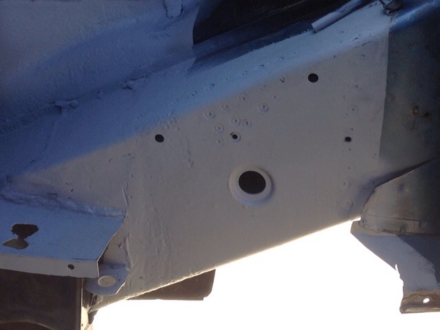

Here's a shot from ndfrigi.
The circle in a circle are the spot weld cutter spots ............
He did good. Only punched thru in four spots.
ndfrigi

QUOTE(cary @ Nov 26 2015, 12:42 PM) *
Actually I credit it to Mark (markesteinhilber) who did the spot weld removal.
Thanks again Mark!

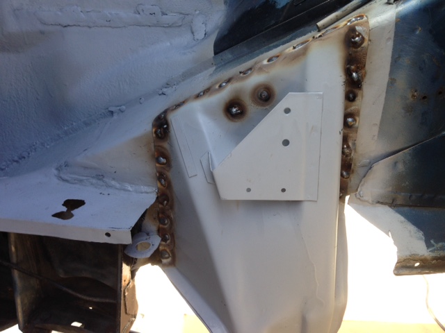

It's really not that bad of a repair. I did one for a friend on his 6 that must have had a battery explosion. It was otherwise a rust free car. Once I removed the old console and engine tray, the new one fit right in. I rosette welded it in and the owner took it for alignment and it was dead nuts on. Go figure!

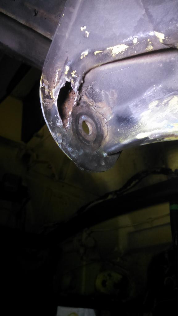

mr2by4
post Nov 29 2015, 04:57 PM
Post #36
Posts: 182
Joined: 9-December 07
From: Fort Worth
Member No.: 8,439

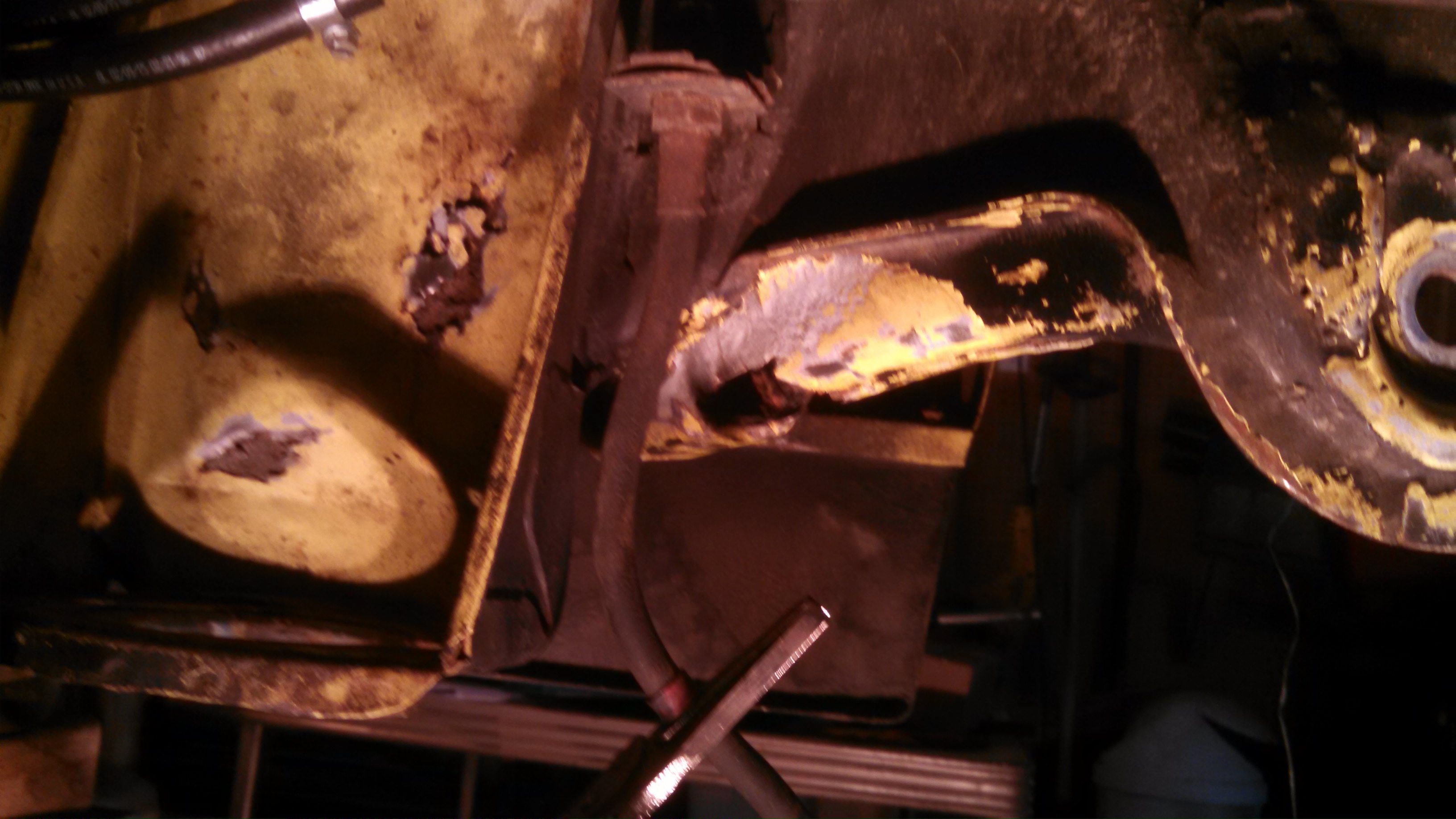

I was on the fence about whether to patch or replace the console. I went over and was cleaning up today and realized that it had been patched previously. I was all ready to patch it.Attached Image
when I saw a little something and cleaned away some surface rust to reveal this.
I will be replacing the console. It will probably be easier than trying to patch that mess.
JoeDees
post Nov 29 2015, 07:34 PM
Post #37
Posts: 515
Joined: 10-November 14
From: Northern Kentucky
Member No.: 18,106
Be ready for some more extensive work. The rust on the motor mount bracket is what worries me. Mine looked like that and I'm having to replace that section of the long. I also had extensive rust in the hellhole though.

mr2by4
post Nov 29 2015, 08:03 PM
Post #39
Posts: 182
From: Fort Worth
Member No.: 8,439
QUOTE(ClayPerrine @ Nov 29 2015, 05:47 PM) *
I have a battery tray and support for you.
Then I should probably get the console with the shelf... I hope to cut no more than required and replace only what is mandated by safety and performance. I am satisfied with my battery tray. It saves weight, like a GT!
This is not encouraging. (IMG:style_emoticons/default/sad.gif)
