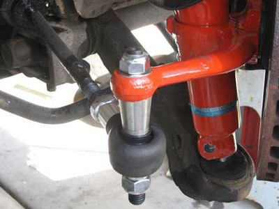

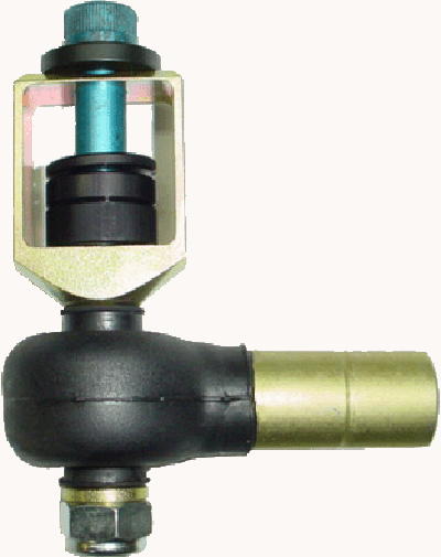

I guess tie rod spacers is the wrong terminology, they're actually adjustable Tie Rod Ends.
Available from many of the usual parts suppliers:
http://www.rennline.com/RSR-Superior-Adjus...-222-RSRBSK001/
(IMG:http://www.914world.com/bbs2/uploads_offsite/www.rennline.com-179-1449280170.1.jpg)
(IMG:http://www.914world.com/bbs2/uploads_offsite/www.rennline.com-179-1449280173.2.jpg)

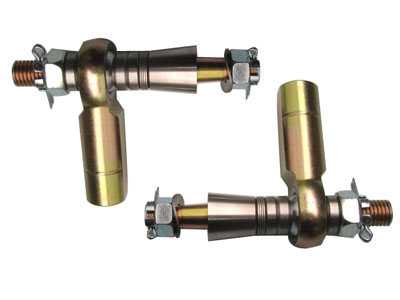

http://www.tarett.com/items/914-products/9...090_-detail.htm
(IMG:http://www.914world.com/bbs2/uploads_offsite/www.tarett.com-179-1449280311.1.gif)
jim_hoyland
post Dec 4 2015, 08:35 PM
Get that VIN ?
Posts: 10,041
Joined: 1-May 03
From: Sunset Beach, CA
Member No.: 643
Good pics, thanks. Seen these before, they make a lot of sense
