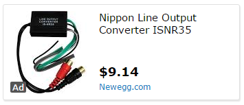

QUOTE(Jeffs9146 @ Dec 8 2015, 11:34 AM) *
You can then add a a/b line switch into the amp and run two different devices into the amp.
Look at the price for the unit at New Egg:
I think we disconnected the output transformer from the Bogen now that I think about it....

QUOTE(Kansas 914 @ Dec 8 2015, 10:41 AM) *
Walmart has it for $4.73

Pretty sure he was commenting on the 9.14 (IMG:style_emoticons/default/smile.gif)

Yep!
