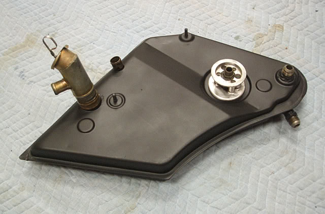

Guys,
I need to have some fittings machined and wanted to know what the factory 914-6 oil tank fittings are suppose to be?

I am going to make stainless steel and aluminum tanks and I want make sure I have the proper fittings

I will probably offer them both ways.. Just want to make sure I can fill the need for everyone

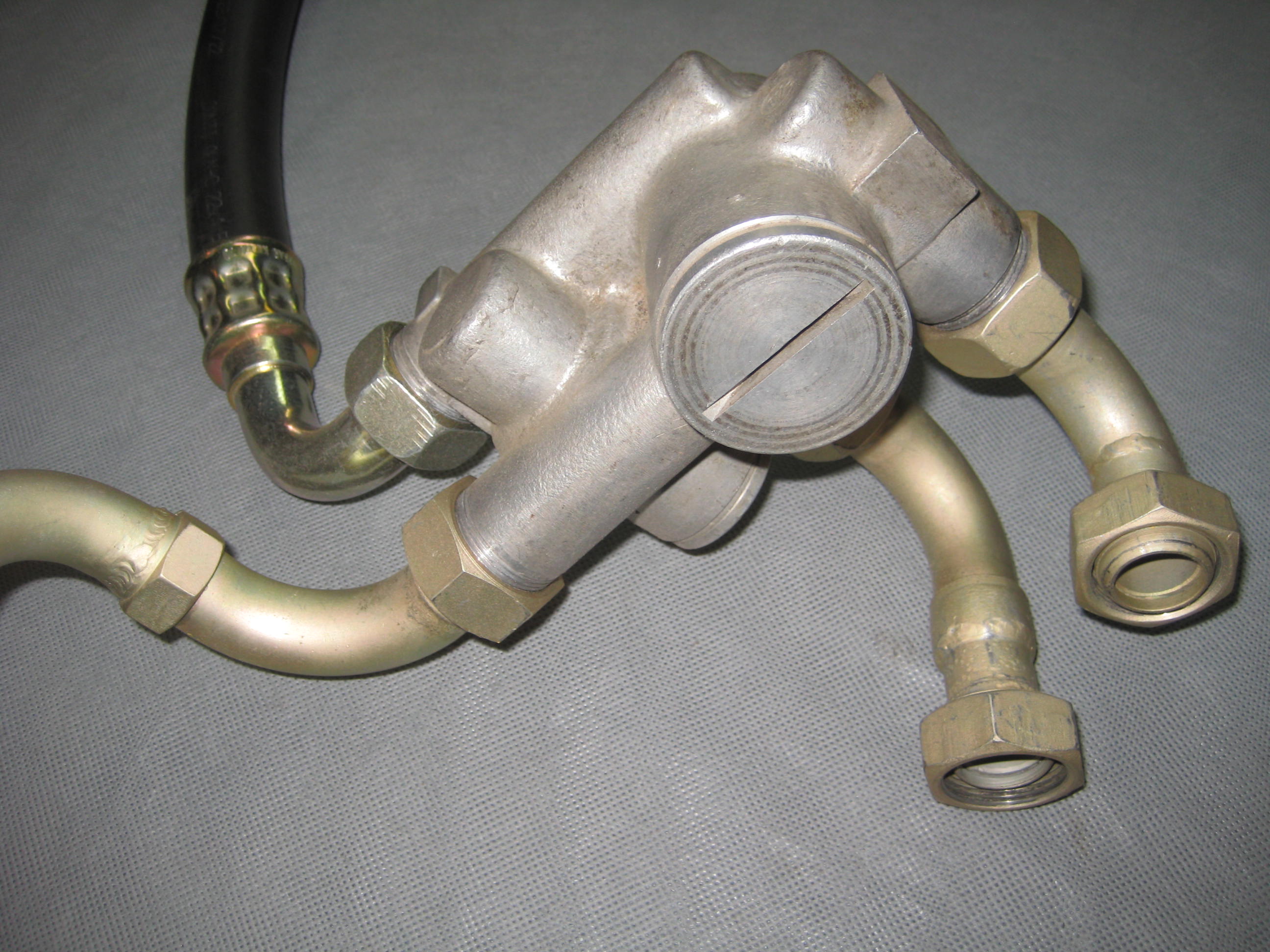

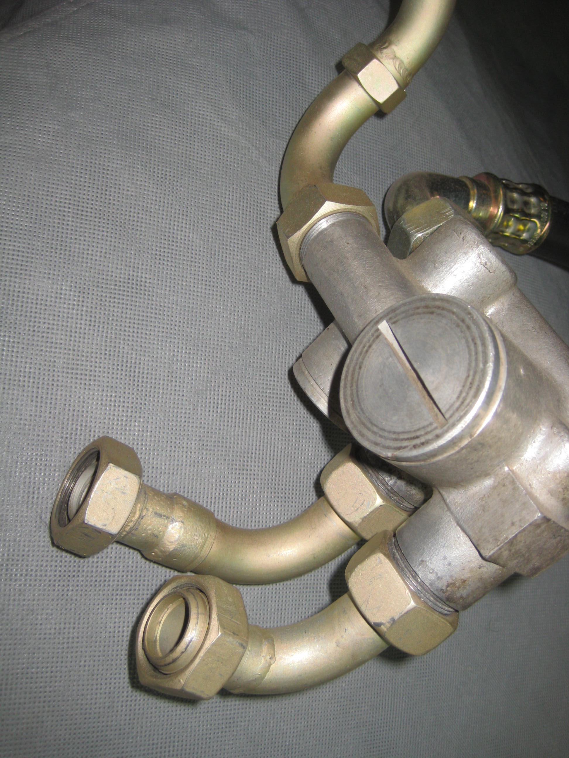

The attached image has non- original fittings to the engine tube and the cooler
