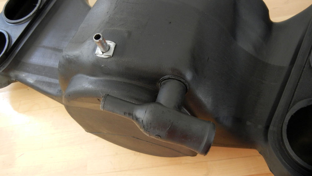

I plan on plugging mine into one of these:
(IMG:http://www.914world.com/bbs2/uploads/post-12094-1373044816.jpg)
But I do have a question, does anything go into the small end?
I've never seen anything on that side, is it just an air outlet?
My spark arrestor is a metal one unlike your plastic one,I can see it has had a hose on the small end @ some stage but wasn't there when I bought the engine.
The Porsche PET shows no rear view of the air cleaner so I don't know,i guess someone could chime it with this info (IMG:style_emoticons/default/confused24.gif) .
At that point there is vacuum so I guess it would serve to draw off fuses after the oil mist has been contained in the catch can.

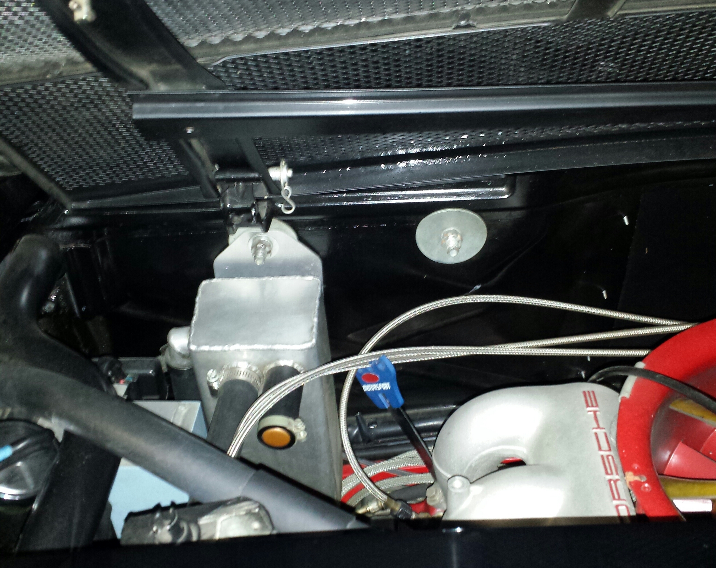

I've had no luck with the K+N on our 2.0 type 4 club racer, the oil residue exits the filter and douses the engine bay with oil. This is only on the sustained high speeds + high rpms at the track. Now I have just ducted back into my cold air filter tube, just before the large cone air filter.
Problem solved.
On my six (pictured below) I just tig welded an aluminum catch can, with a vent and drain nipple underneath. Just check it occasionally. Attached Image

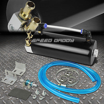

Seriously guys this one is made of aluminum and was only $16 to my door... Attached Image
jmill
post Dec 19 2015, 06:37 PM
Post #30
Green Hornet
Posts: 2,449
Joined: 9-May 08
From: Racine, Wisconsin
Member No.: 9,038
QUOTE(Andyrew @ Dec 19 2015, 06:08 PM) *
It lacks the one off cool factor of a welded piece or a drink bottle with a hole in it. (IMG:style_emoticons/default/biggrin.gif)

The small tube on the factory air filter housing goes to a tube with a rubber fish mouth drain and just drains to the ground.
