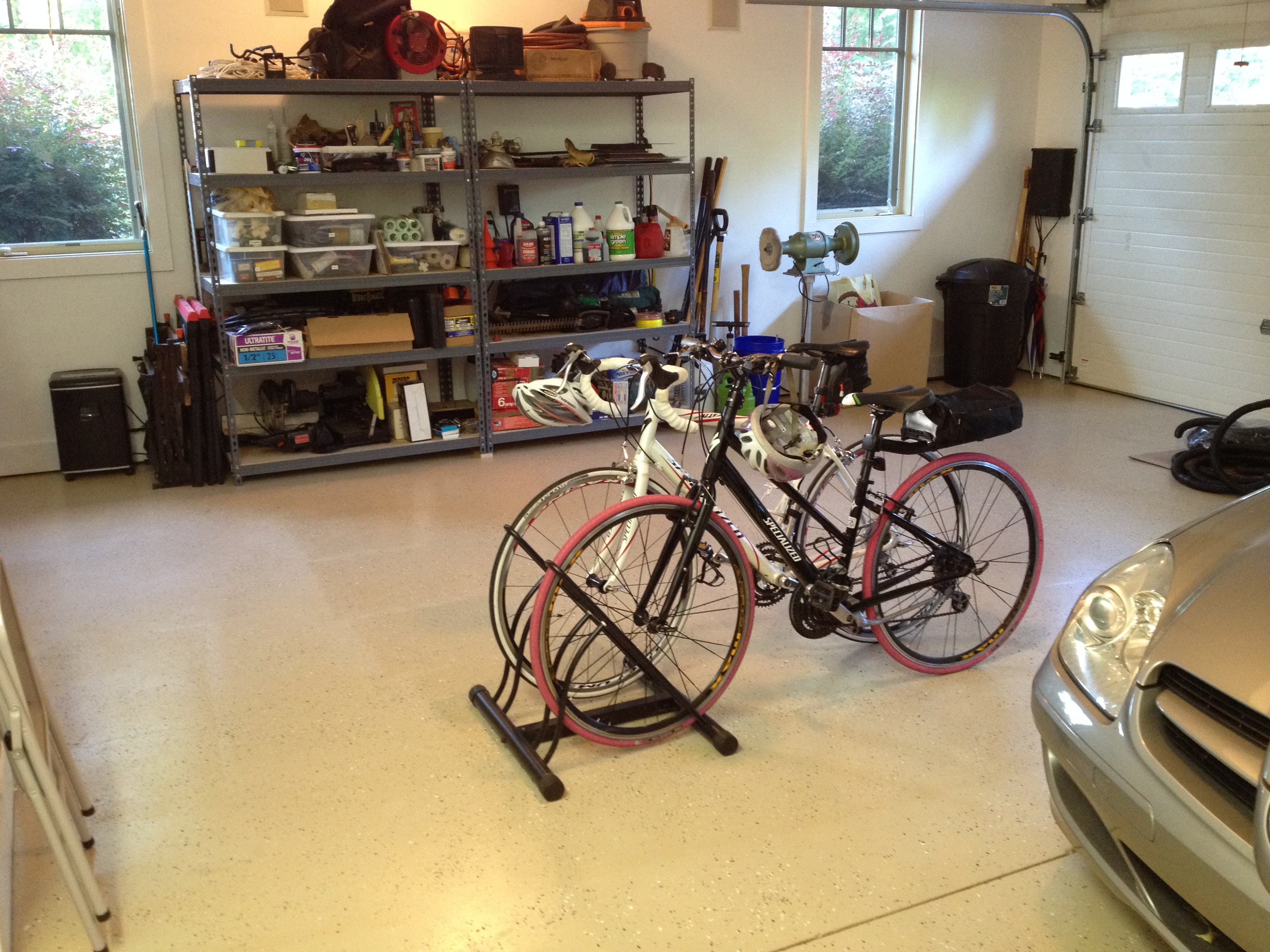

Leaning towards an epoxy product. Any recommendations would be greatly appreciated!!

You'll find 2 types. One is about 40% more than the other. That's the one. If it is an old floor you might consider a pro application w/ a warranty against flaking/peeling or bubbling. A novice can handle a new homes floor but old ones are Hell to properly prep. That being said; get one. It's so nice cleaning up oil spills with a swipe of a rag. (IMG:style_emoticons/default/beerchug.gif) FWIW, avoid parking on it if you just came off the hi way in summer temps. If you do, the epoxy paint tends to stick to the tire if not prepped correctly. (IMG:style_emoticons/default/beerchug.gif)

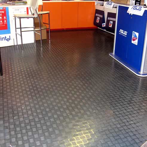

Rubber floor tiles

I used a rustoelum product I got from Menards. I used the solvent based product not the water based stuff. I used the light grey and skipped the plastic flakes. It is an epoxy mix and it was a bit expensive but it did hold up well. I am due for a recoat but it received hard use and lasted several years. Easier to clean than concrete surface. The biggest improvement was light. It was incredible how much brighter the shop became after painting

(IMG:style_emoticons/default/agree.gif) Used the rustoleum product from HD. It is a two part epoxy.
Have used it on two floors now and very pleased. It is bright, durable, easy to clean,
and does not lift onto the tires. And it is affordable.
Proper prep is a must or you will be left with a mess. Follow the directions to the letter. The prep will take two long days of scrubbing, degreasing, scrubbing, rinsing drying, etc. The application goes quick.
The epoxy must be catalyzed properly (the correct time for the temperature). IF not done correctly it will never fully cure and again- a mess.
The color batches vary slightly. Rustoleum advises to mix several gallons in a 5 gal bucket then refill original containers prior to adding catalyst. I mixed enough to set aside a spare gallon for future touch ups.

My .02, Have had several different types over the years.
Straight epoxy single color gloss finish is my favorite.
Reasons: Looks great, easy to keep clean and brooms up the best. Downside when wet can be slippery.
The multicolor flakes look great BUT small parts when dropped onto the floor will disappear into the floor.
A highly textured floor is great for traction BUT is more tedious to keep clean.
In my new garage I am considering no coating but having the concrete polished!

If I can recall correctly, race deck is a plastic tile, with holes in it to allow dirt to go below. Not something I would use.
When I say rubber floor tiles, think commercial tiles like what you see on stairs at large office buildings.
It comes in tiles or 12 foot wide rolls, as long as you need.
It weighs a ton.
It can take your forklift weight.
It is a lot easier to install than paint.

http://www.sears.com/incstores-coin-patter...p;blockType=G25

Looks like it would be a pain to clean and make the room dark.
