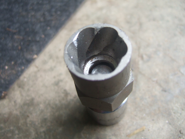

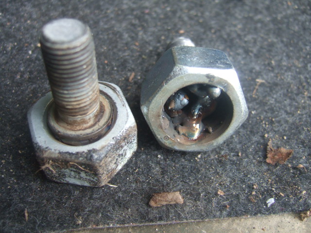

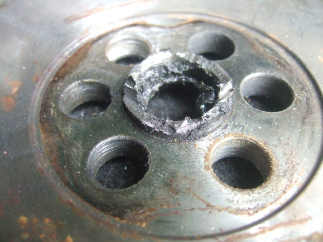

That's IF you can even remove those %#@&king 12 point bolts on a 6 given that I think red loctite is on some of them. Had a hell of a time getting two of them out that stripped the 12 point head, so tried an ez out which required grinding off the outer rim of the pilot bearing first...Attached Image Attached Image
Ended up grinding the threads out of a nut and welding it on to the bolt head to get them out....YecccchAttached Image
Definitely NOT reusable!
