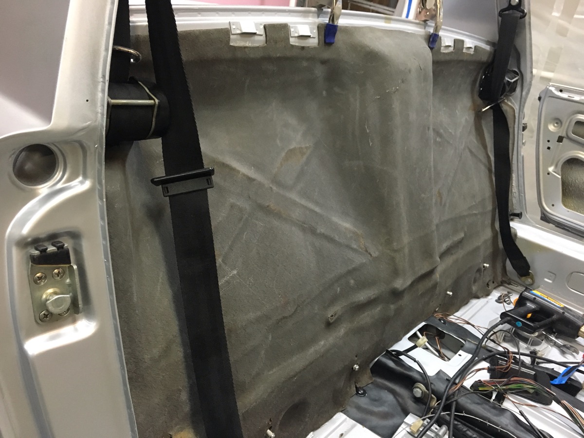

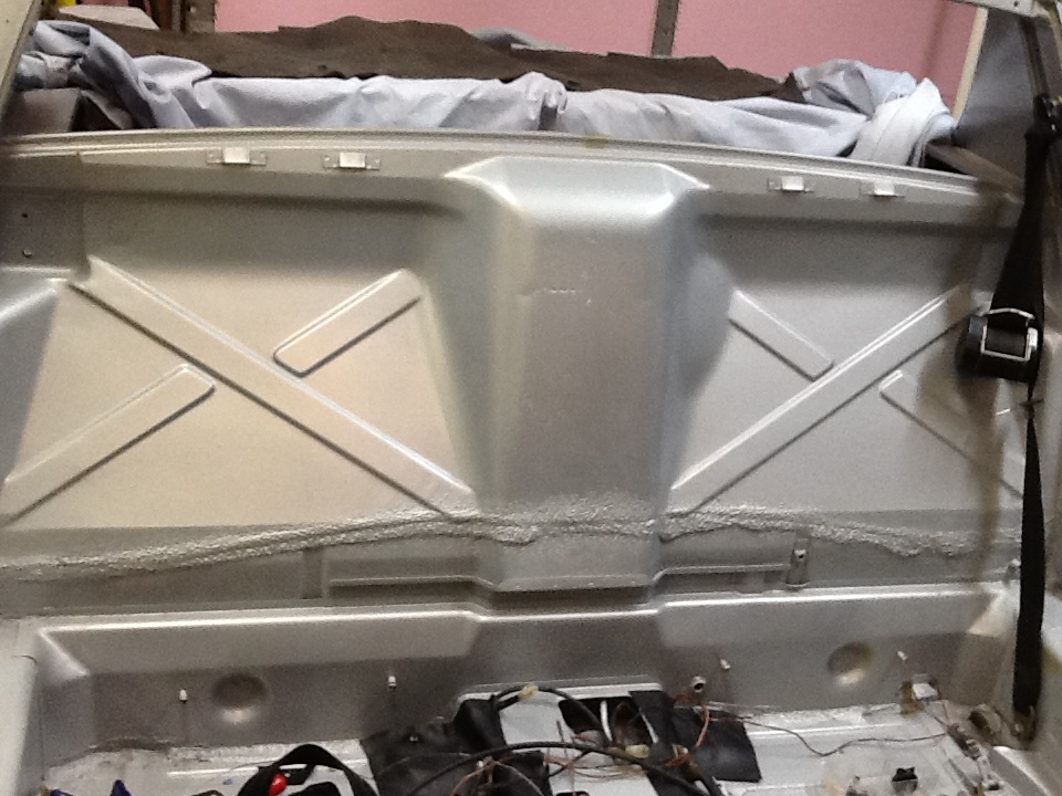

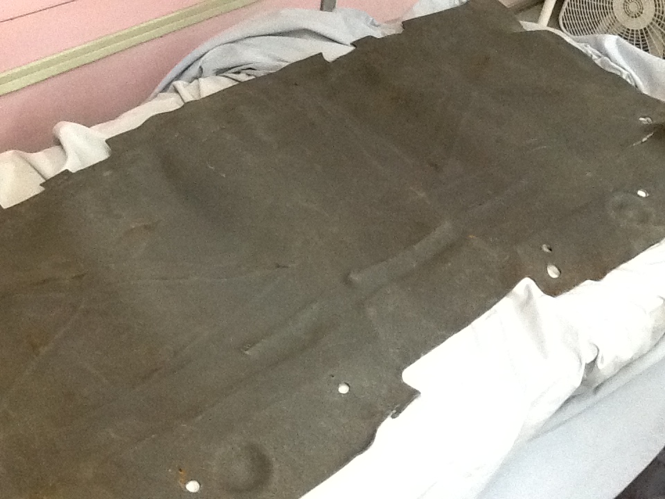

Here's a factory pad. I'm debating what to use to attach it with. I'm thinking something other then glue, any ideas?

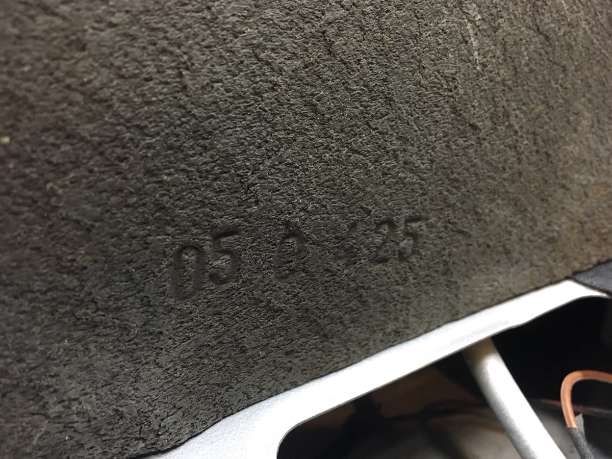

Went ahead and glued it on, used 3M super 77 both surfaces. Wanted It to lay down flat, some areas required a little heat to level out. Even found the part number.
