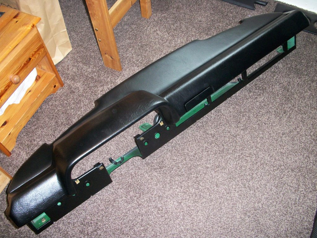

Yep,
As you said you can rebuild the whole dash out of the car. Just leave off the Knee Roll to allow you to refit it.
(IMG:http://www.914world.com/bbs2/uploads_offsite/i265.photobucket.com-18255-1453925534.1.jpg)
It's makes for easier access but it's a big job disconnecting everything, then putting it all back just for trimming purposes. The real benefit is you can glue the vinyl sheet material on well and fold the edges under (along the base of the screen and around the vents) and glue them down for a better job. (You cant do this with it in the car)

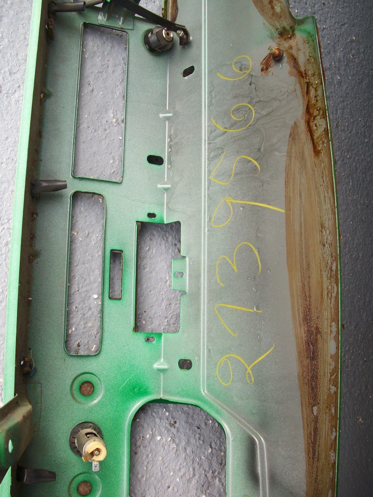

To remove the WHOLE dash....There are 4 x M6 nuts up under the scuttle (access via trunk with vent hoses off each side for more room) and an M6 bolt on a lower support leg under the cigarette lighter, then screws at each side (access with doors open and Knee roll off)
I trawled my photo collection and found this one of the underside of my dash with Karmann body number on.. at the bottom of the last No6 in my body number you can see one of the 4 x M6 studs. They are either side of each vent slot. Be careful as there are tiny plastic packing/spacing washers on these studs that set the height on the dash to screen. They do fall off and get missed when refitting.
In the bottom left of the picture you can just see the "leg" under the cigarette lighter which has a M6 bolt hold it up.
(IMG:http://www.914world.com/bbs2/uploads_offsite/i265.photobucket.com-18255-1454185996.1.jpg)
