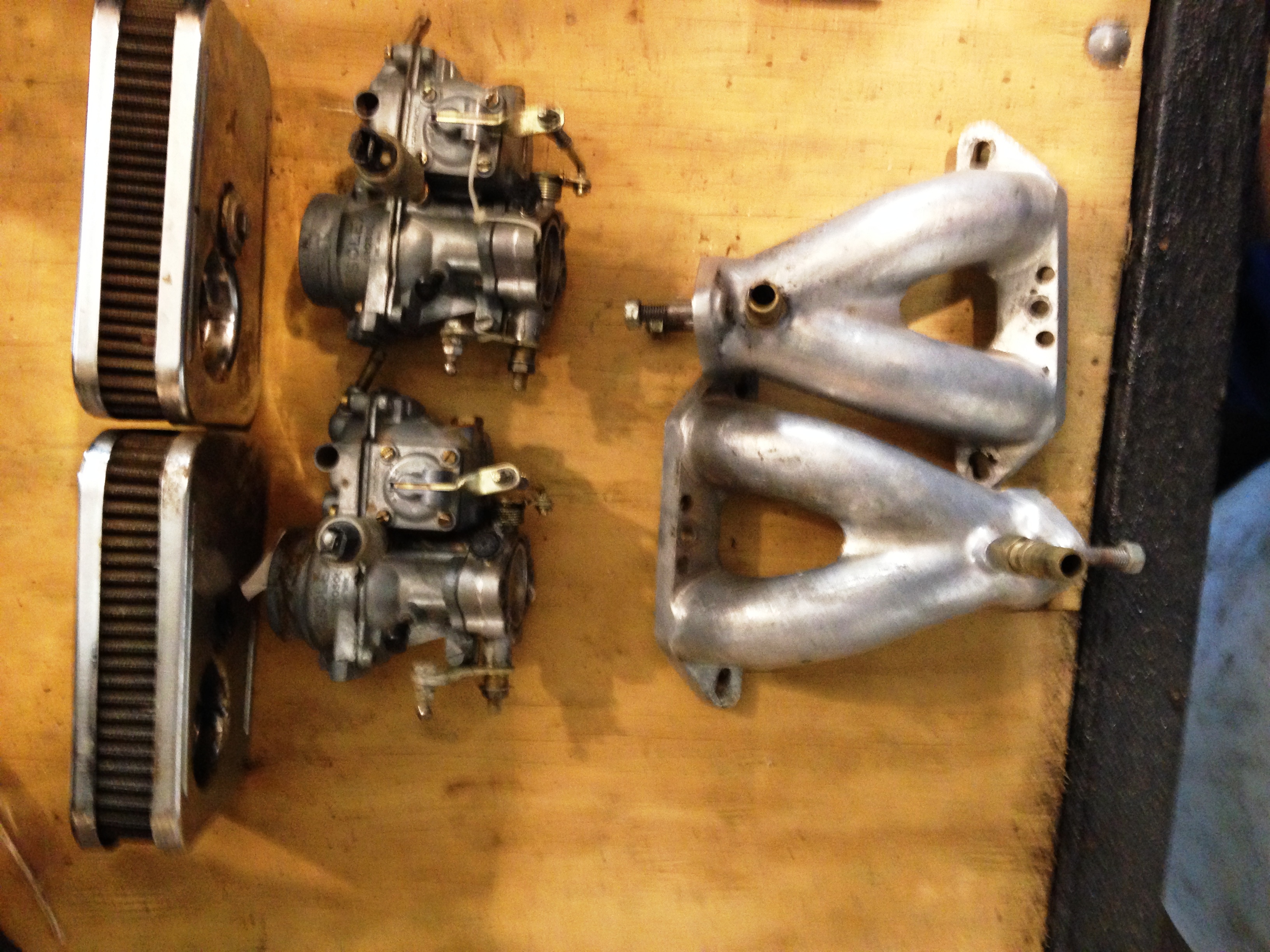

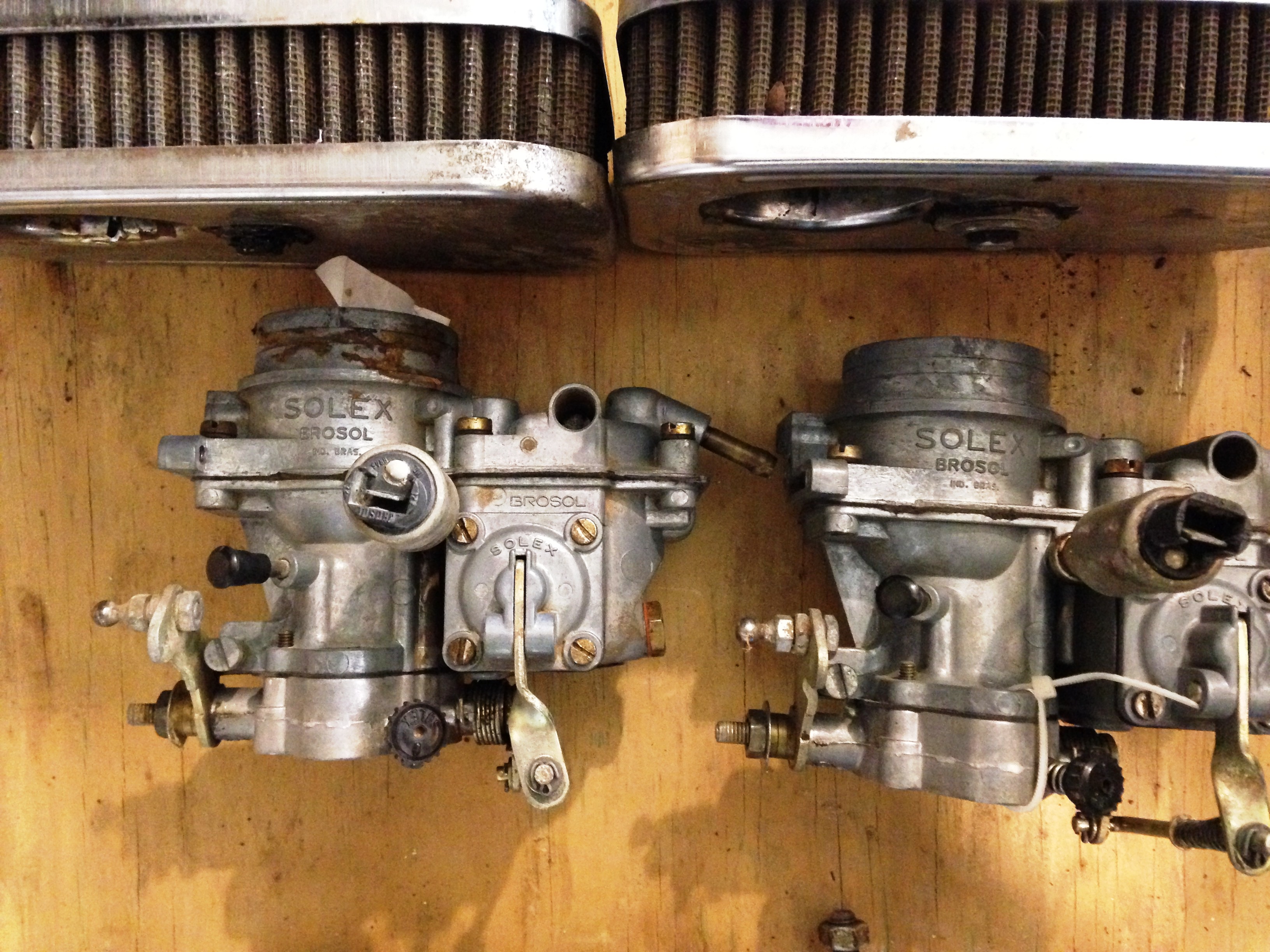

Thinking of putting these on the 1.8 I will be rebuilding. I believe they were on the 2.0 liter I got as part of the package deal.
but from what I have read these carbs are probably better suited for the 1.8 or 1.7 liter rather than the 2.0
Am I thinking right?
Thanks

QUOTE(OU812 @ Apr 28 2016, 07:58 PM) *
QUOTE(Mark Henry @ Apr 12 2016, 07:37 AM) *
Although the kadrons (solex) work good on a type 1 up to a mild cam and 1776cc it wouldn't be my choice for a type 4. Main reason is T4 heads flow way more than a T1 head
BTW I've used kads many times.
Get the dells or webers, better yet keep the FI and do a MegaSquirt brain.
Another better photo
Thanks

QUOTE(OU812 @ Apr 29 2016, 01:00 PM) *
you could but the stock vents are very small,just sold a near new set to a mate doing a 1600 bus engine with big valve heads so that's the range of them really,same as the ICT webers they have small vents also.
If you buy this set-up cheap enough you could go to aircooled.net and get rebuild kits and larger venturi's from them along with a suitable jetting package for your engine they should run ok .
Failing that get some Dellorto's as mentioned.
Thanks

I think now I am starting to get it....These Kadrons (Solex) would work out ok on my 1.7 or 1.8 liter. But the factory EFI in the proper tune is still preferred over carbs and as good as it gets for a stock engine set up.....More desirable too.
