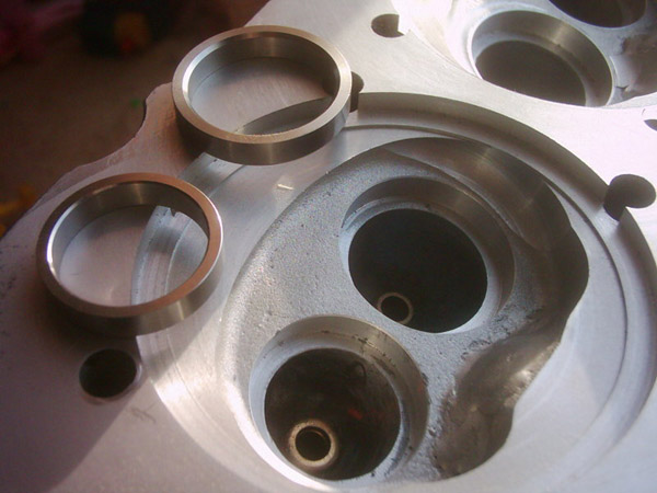

QUOTE(r_towle @ May 3 2016, 10:55 AM) *
I think Chris is right, the 103's just about touch the studs and yours appear to have some room.
I have a set on my motor, but it is not something I could take a picture of at this point.
Maybe
McMark or Mark Henry could show you.....they both have/had 103 mm cylinders.
Rich
Good spotting,no machining gone on there,just plain old AA 96mm kit,most likely has the original Chinese rings also (IMG:style_emoticons/default/sad.gif) .
I use Loctite sealer around cylinder bases never had an issue,this is case/component sealer,never saw RTV in the label,nevermind each to their own,we all know what works for us.
Really hope the owner can sort this with the seller,fraud involved here ...no question.

QUOTE(r_towle @ May 2 2016, 06:55 PM) *
Maybe
Rich
Nickies would be silver aluminum, a magnet will not stick to them, they would also have ARP head studs with 12 point nuts.
(IMG:http://www.914world.com/bbs2/uploads/post-26-1455467774.jpg)
This pic will give you an idea how much material is left when you machine for the 103 register.
(IMG:http://www.914world.com/bbs2/uploads/post-26-1403278590.jpg)

QUOTE(Hans Jan @ May 2 2016, 11:53 PM) *
Thank you Mark.
Of note is how close the studs are to the actual cylinder.
You can see they just about touch.
On your picture there is quite a bit of space between the stud and cylinder.
And of course, the rtv is another clue.
