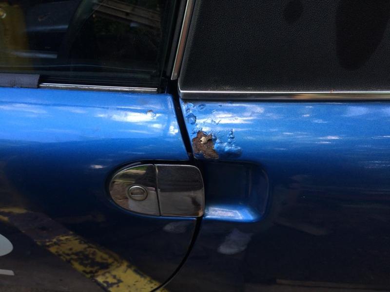

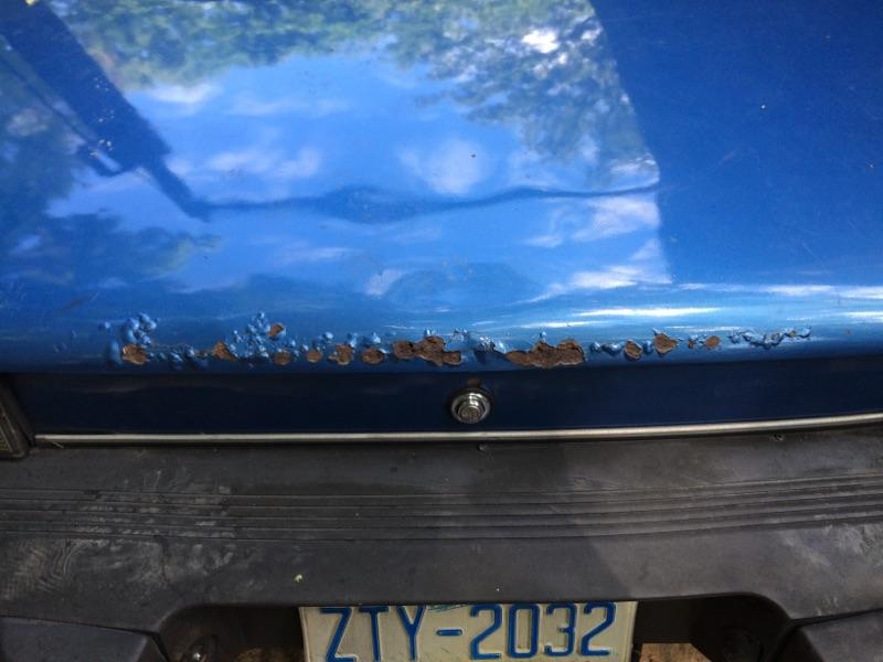

Here are two random spots of rust, not sure how they got there?? Im thinking there must have been moisture in the trunk?.. or it had a bunch of dirt sitting on top?? Just thinking out loud.

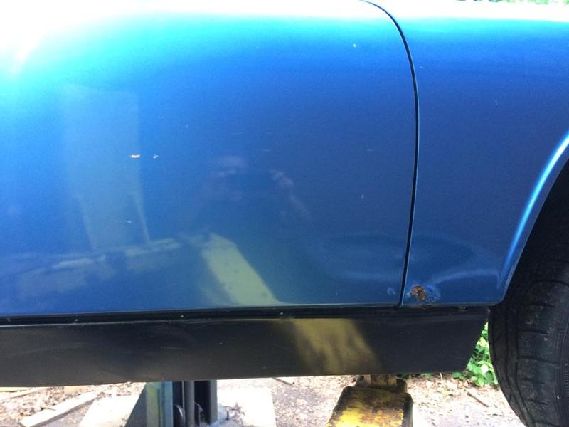

And this, I have no idea, though it kinda scares me as to what would be hiding inside the quarter panel
(IMG:http://www.914world.com/bbs2/uploads_offsite/img.photobucket.com-16644-1464119215.2.jpg)

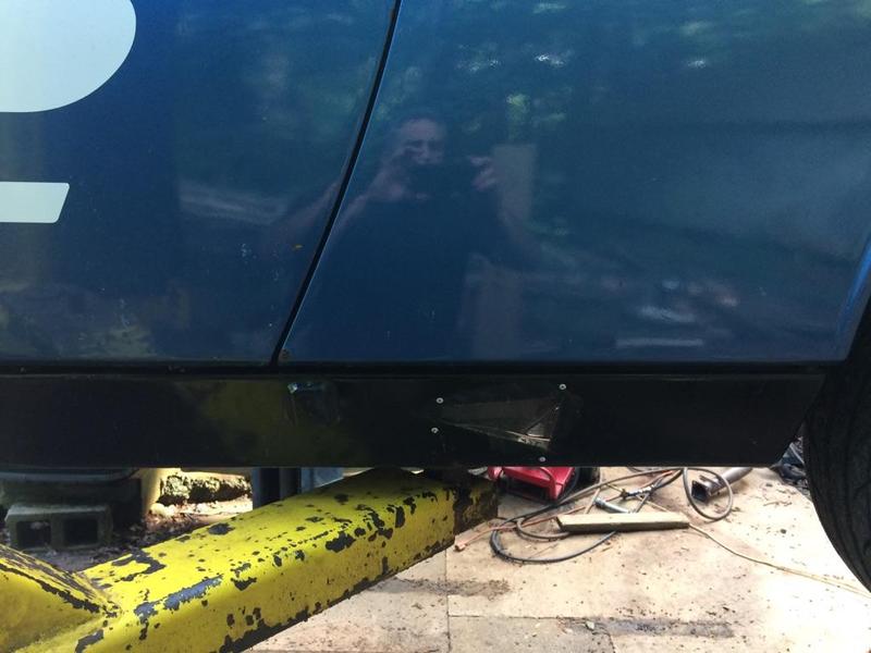

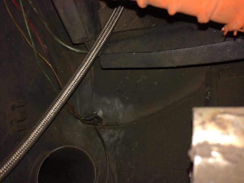

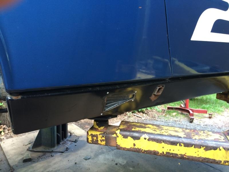

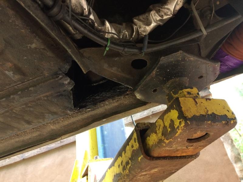

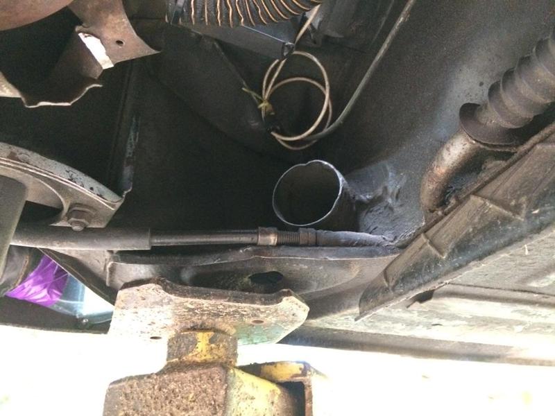

And finally, these are the underside shots I got. He told me they have fixed the hell hole in the past. Honestly, Im not really sure what Im looking at haha
(IMG:http://www.914world.com/bbs2/uploads_offsite/img.photobucket.com-16644-1464119215.3.jpg)
(IMG:http://www.914world.com/bbs2/uploads_offsite/img.photobucket.com-16644-1464119215.4.jpg)
(IMG:http://www.914world.com/bbs2/uploads_offsite/img.photobucket.com-16644-1464119215.5.jpg)
(IMG:http://www.914world.com/bbs2/uploads_offsite/img.photobucket.com-16644-1464119216.6.jpg)
Gaps look good on the door and you can see the naca ducts to direct air into the engine bay

As a general rule, you can only see 10% of the actual rust that is there.
(IMG:style_emoticons/default/icon8.gif)
The hell hole is swiss cheese, you can see the large portion of the the floor pan that is already missing. It'll be *much* worse once you dig in there.
The spot behind the door handle is also a big red flag, that whole sections is toast and the rust most likely already extends into the inner sail panel.
The rear hood indicates a lot of moisture in the trunk, meaning your trunk floor is guaranteed to have plenty of rust as well.
