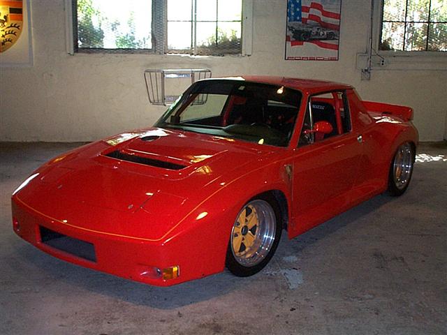

Here is a picture of a 914 I had with hood vent. I never noticed heat. I assumed through the hood would detach air flow, retarding lift, creating down force?
Retro
