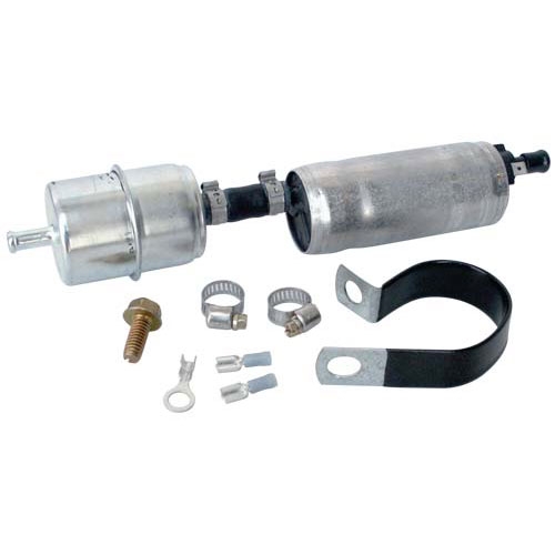

I used this one on my 2056:
http://www.cbperformance.com/ProductDetail...roductCode=3193
Also, there is no real need to relocate it, you can run it in the stock location using the stock wires:
http://www.914world.com/specs/SirAndyCarbFuelPumpRelay.php
(IMG:http://www.914world.com/bbs2/uploads_offsite/www.cbperformance.com-179-1416176797.1.jpg)

I mounted the pump on the firewall in the section where the fuel filter mount is on the early cars. Close to the original pump location but more in-line with the fuel lines.
I used the stock wiring to power the pump, no need to hack any wires (see link in my post above).

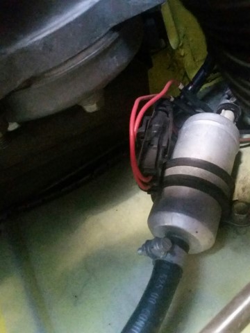

I used the factory wires but the previous owner cut off the plug so I picked up one of those 2 wire Weatherpack connectors for a GM car at the parts store. Makes for a nice water proof connection. Mounted the pump in the factory location I think using the same bolt hole but without an isolator.....nice and quiet. Not much of a photo.
