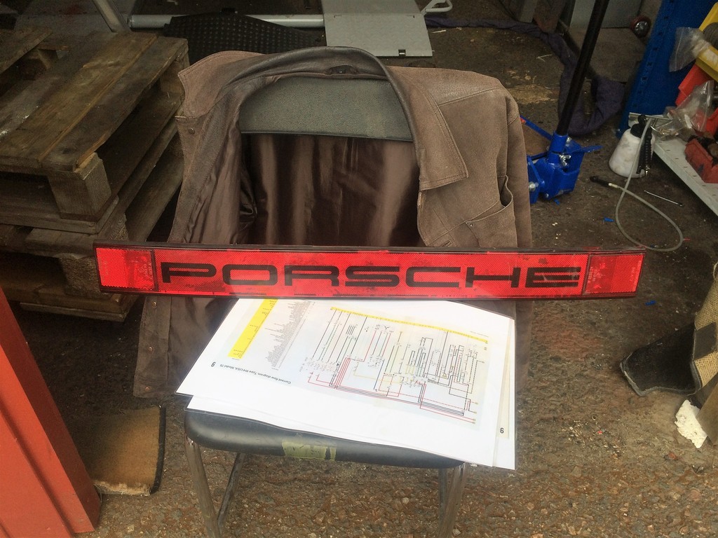

I got myself a 911 reflektor which I was planning on mounting on the back end of my 914. Unfortunately its too long to fit between the tail lights
Did I get the wrong one or do they need cutting?
(IMG:http://www.914world.com/bbs2/uploads_offsite/i1300.photobucket.com-17452-1468086162.1.jpg)

Needs to be cut. They all do.

Custom cut fit by you :-). There were a few back in the 80's made to fit
the 914 (aftermarket) obviously. There a few out there. I sold mine
recently that was made for the 914 with the electric lock. Take your time and seal the ends with epoxy for the 911 ones so
condensation won't get in between the layers of plastic and reflective material.
Good luck.

Thanks,
Have members advice for the best way to cut it and mount it, it was not cheap so I dont want to mess it up.........Maybe i will just mount it on the garage wall instead

If you cut off the mounting studs you might be able to just glue it on with double sided tape instead of drilling holes in your panel.
Not sure how that would work with the curvature of the reflector, might need some heat and pressure to get it straight first.

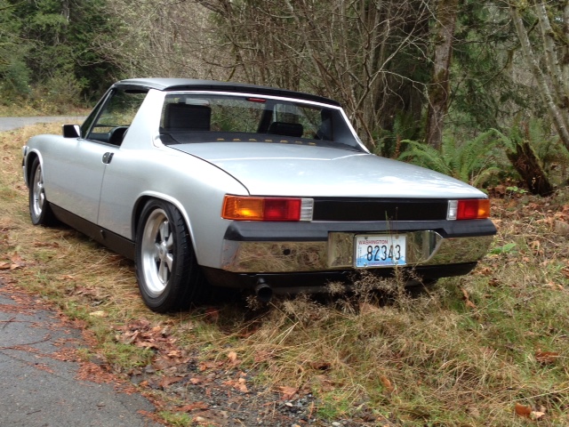

Couldn't agree more, but since I am a cheap bastard, I just blacked it out.
But different strokes and all that.
