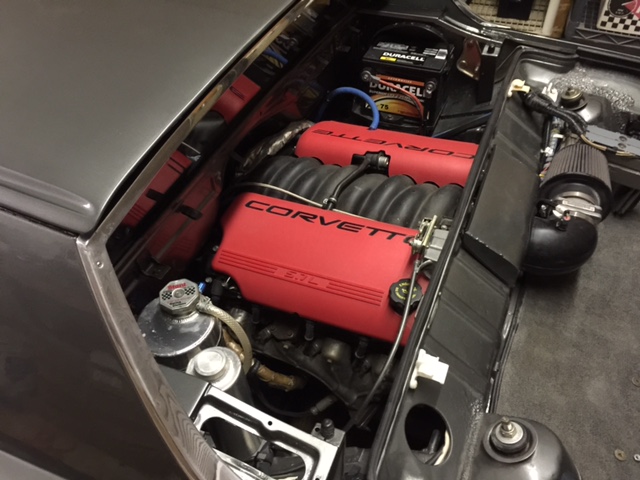

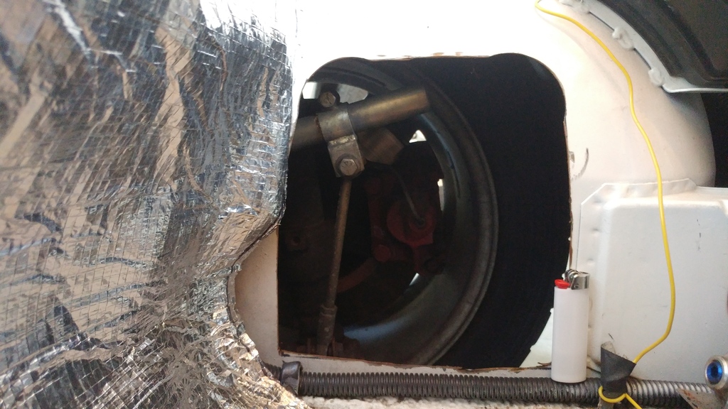

QUOTE(1stworks @ Jul 27 2016, 08:43 AM) *
Heres my in and out on renegade set up.96 deg I run 200 to 225ish.
That's a lighter for ref.
(IMG:http://www.914world.com/bbs2/uploads_offsite/i1315.photobucket.com-15718-1469634194.1.jpg)
(IMG:http://www.914world.com/bbs2/uploads_offsite/i1315.photobucket.com-15718-1469634194.2.jpg)
5.3 Ls electric water pump.
LS run hotter than old school small blocks. 210-220 normal.

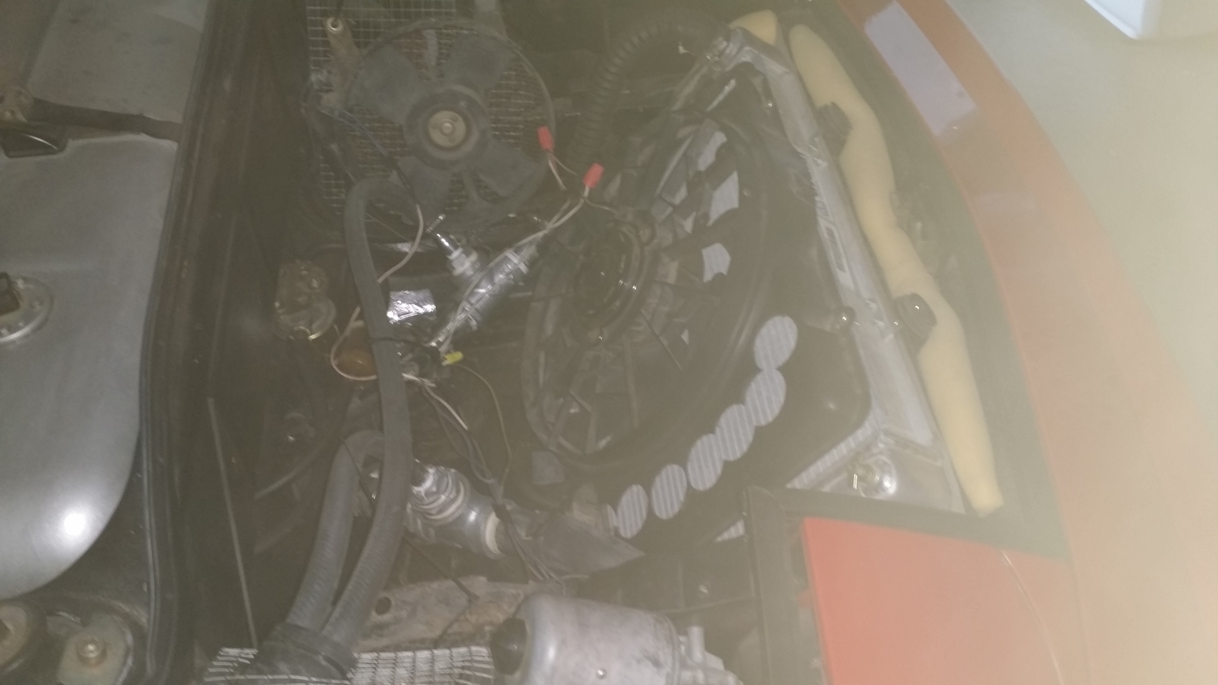

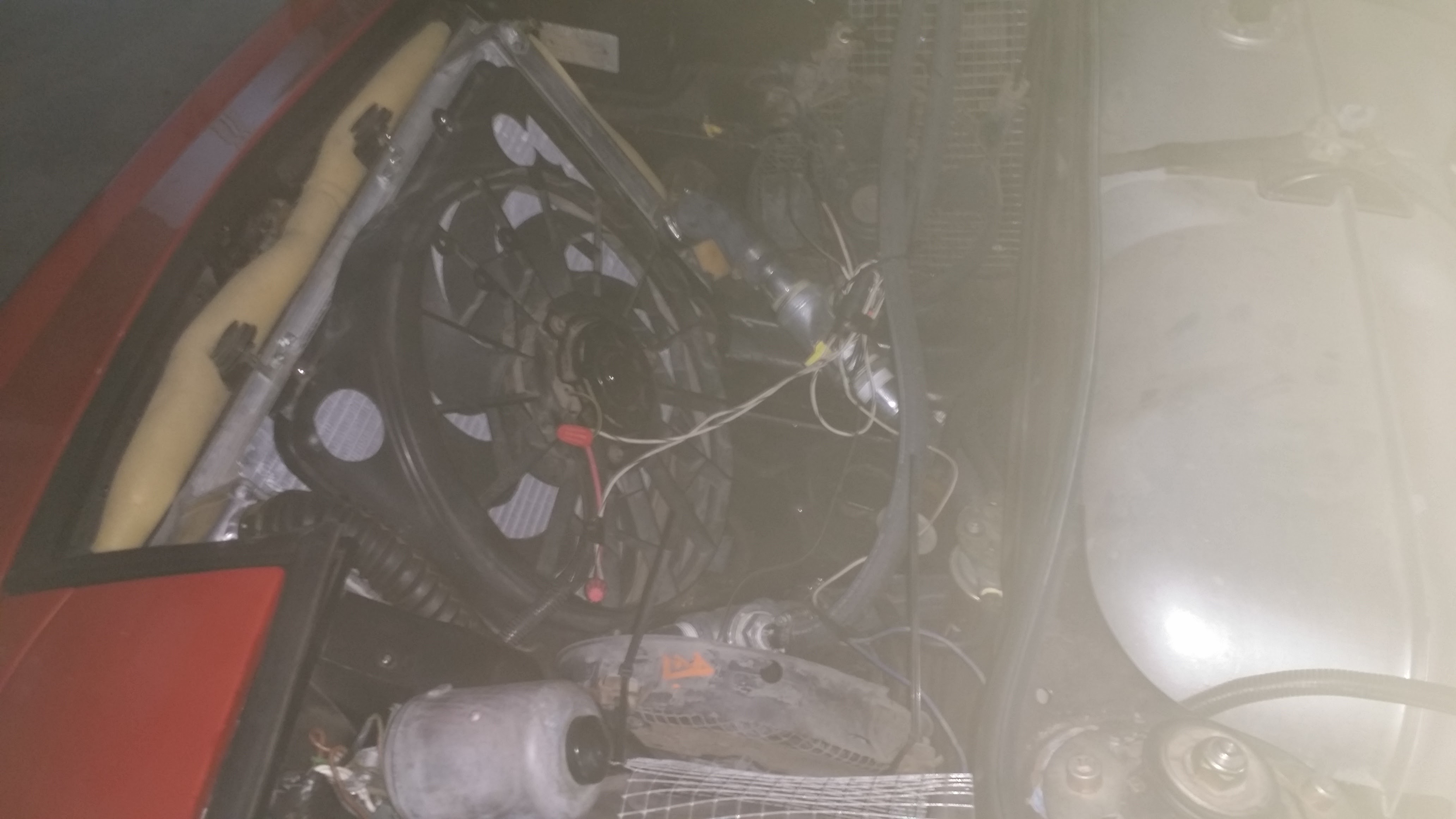

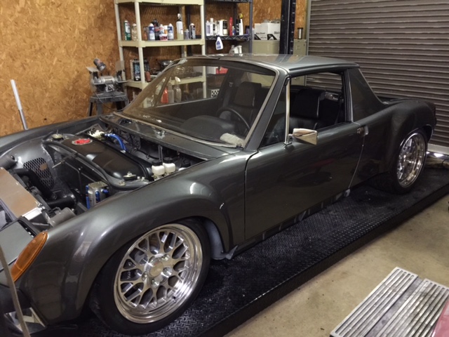

Here are some pictures I took today.
The holes in the shroud are new... as a test top see if it made a difference. I think it did because in the past (with no holey shroud), it did not matter how cold it was outside; the temp would always go to 200 and beyond (have a 160 t-stat with bleed holes drilled and the fan is set to turn on at 180). After cutting the holes in the shroud, the temp would stay at around 180 (acceptable) although it was when it was cooler outside. Now in this 100 degree weather... it does not matter... it still get to 200 and beyond).
The extra fans are from a Toyota 4-Runner AC condenser units and were mounted there temporarily to see if they made any difference in assisting the main fan exhaust air from the front area (they were wired to push air out). They did not work.
What if I could place the radiator more vertically to allow a larger area in front of it (then shroud it too). Would that help any?
Also; my temp sensor is mounted in a port right next to the t-stat/intake manifold.

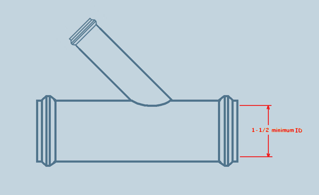

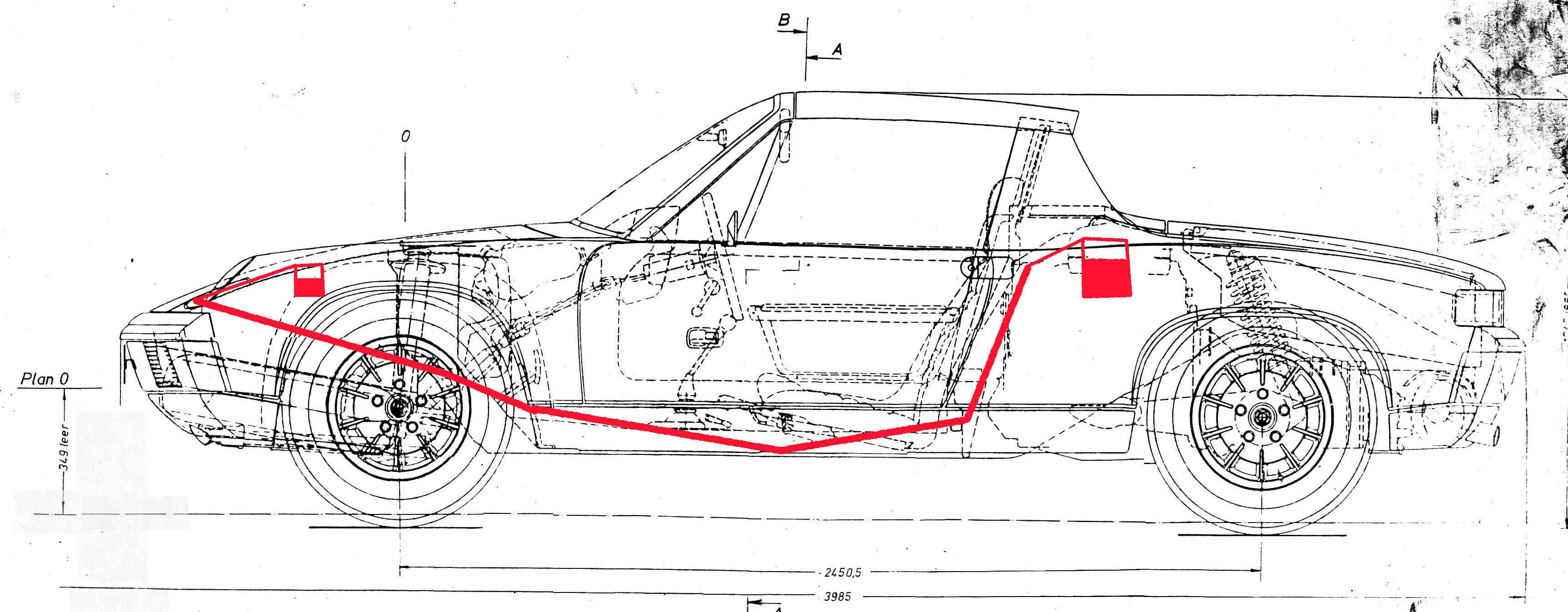

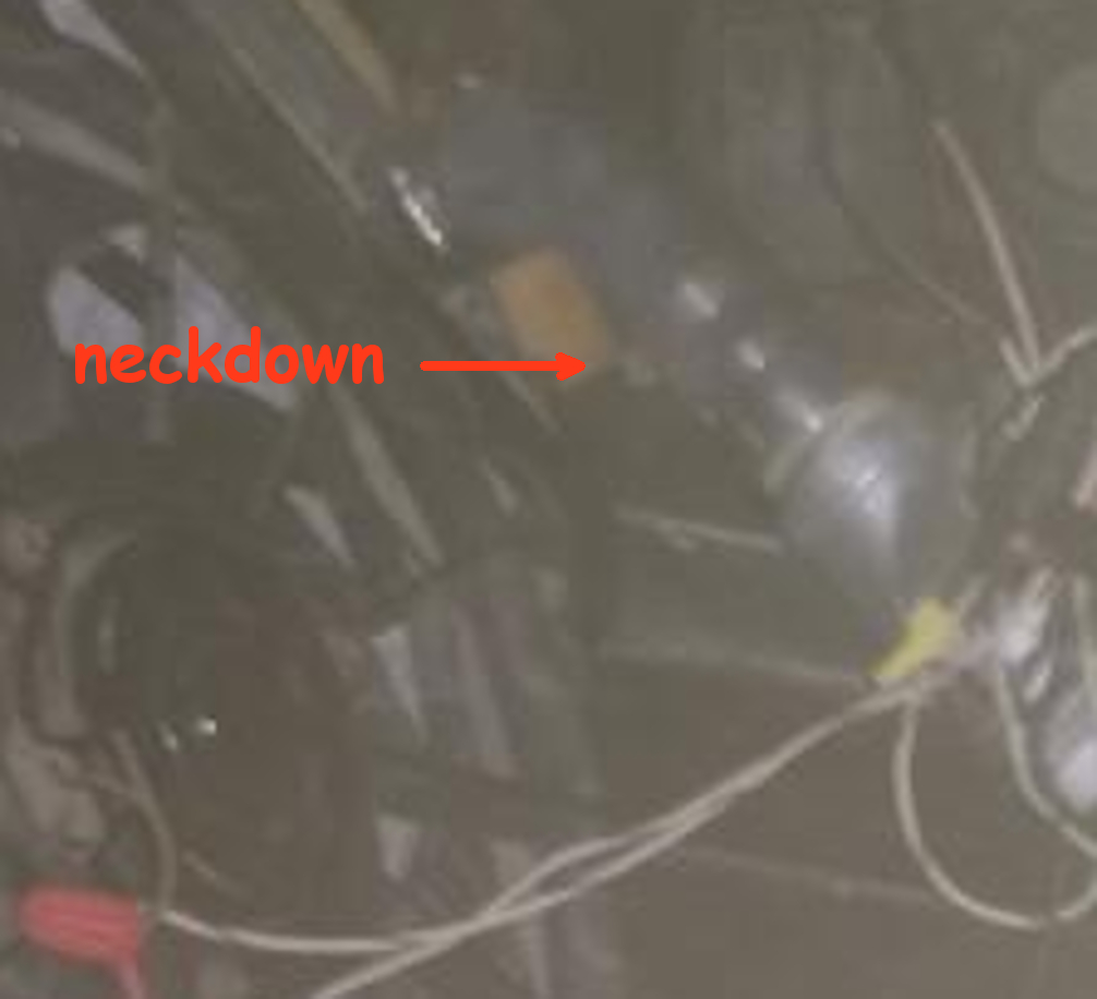

Restriction to 3/4"id?
Neckdown to 3/4"?
Likely,the rad is air trapped,as it rises to the top,displacing the coolant.
Venting to header and overflow tanks will solve the problem.
Custom fittings for your heater-core lines will open the restrictions.
A plumber's nightmare,reducer's and tees,in a Porsche.
(IMG:style_emoticons/default/headbang.gif) keeping it cool.
A local weld shop can make these 'vees',in ss or ally.The id is important for flow.
ABS plastic cut,glued and machined,has been used as well,labor intensive,to get right.

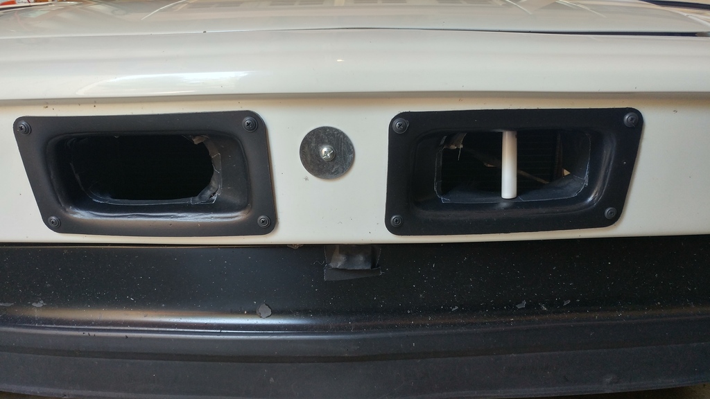

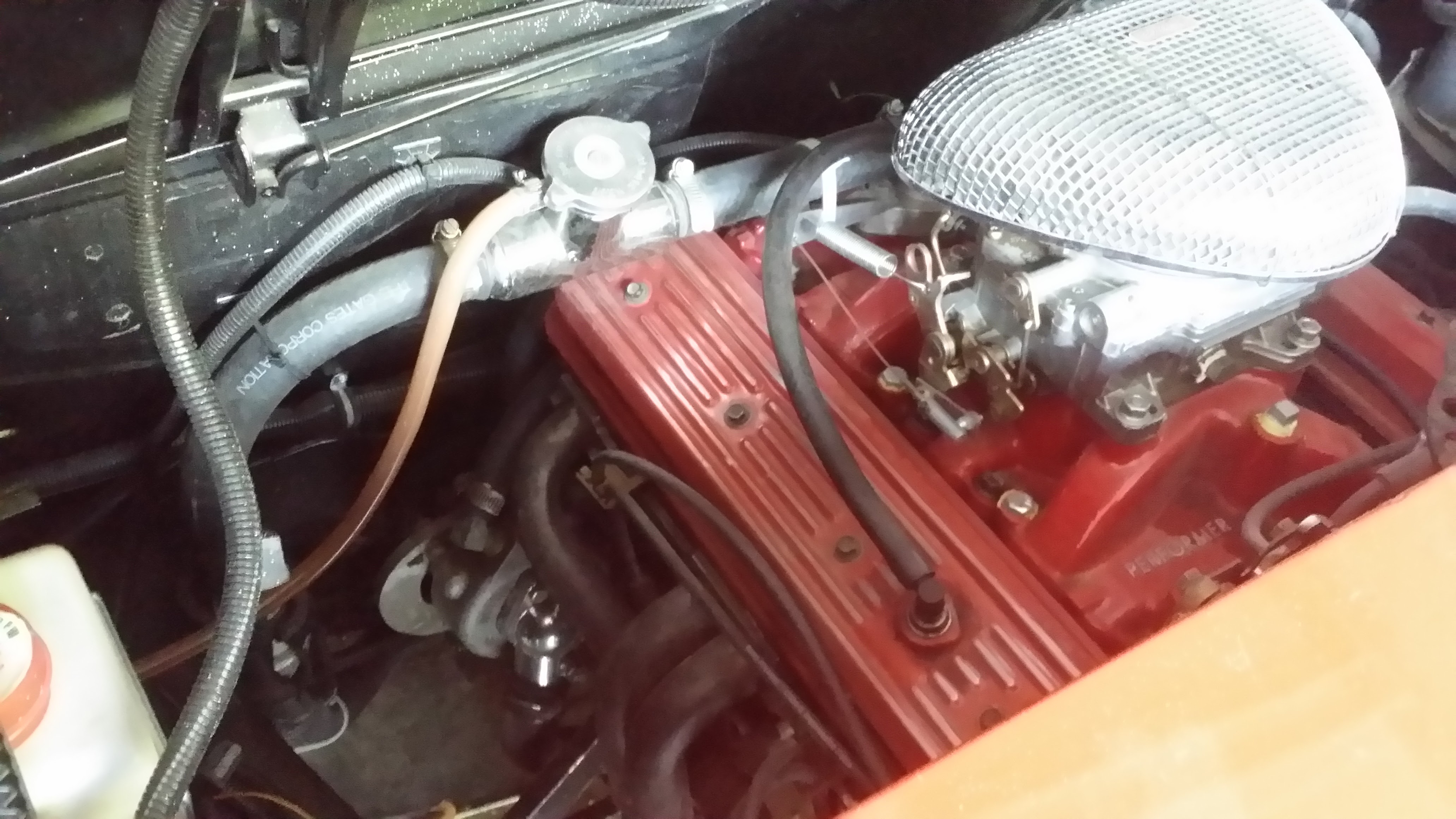

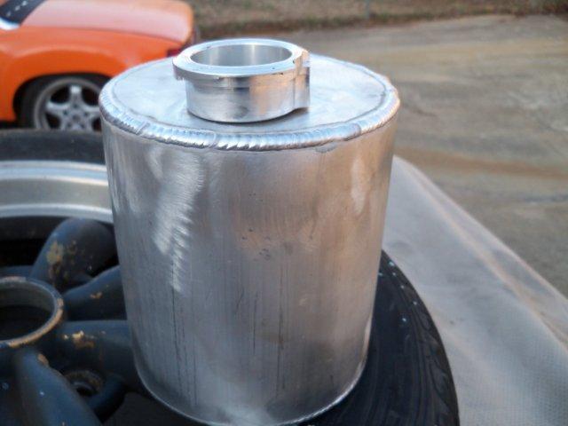

Here are a few pictures of my radiator install. The front opening is a GT Bumper and lower valance. You can see in the picture the smaller sized wheelwell openings.
Homemade header tank
