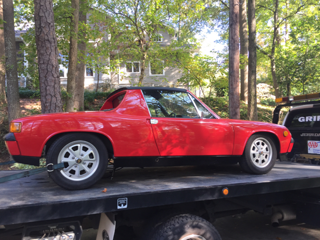

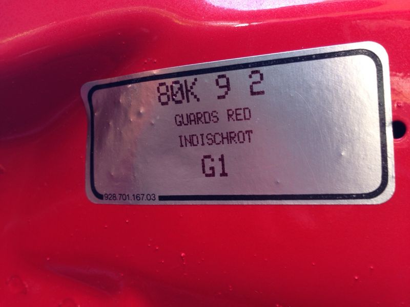

Don't think Guards Red was ever a factory color on a 914... but having said that, my car was painted Guard's Red a long time ago by a previous owner. He said it was the factory Porsche color L80K, also known as India Red (or Indischrot in German). I love the color on my 914!
Here it is (or course, on a flat bed tow truck...!)

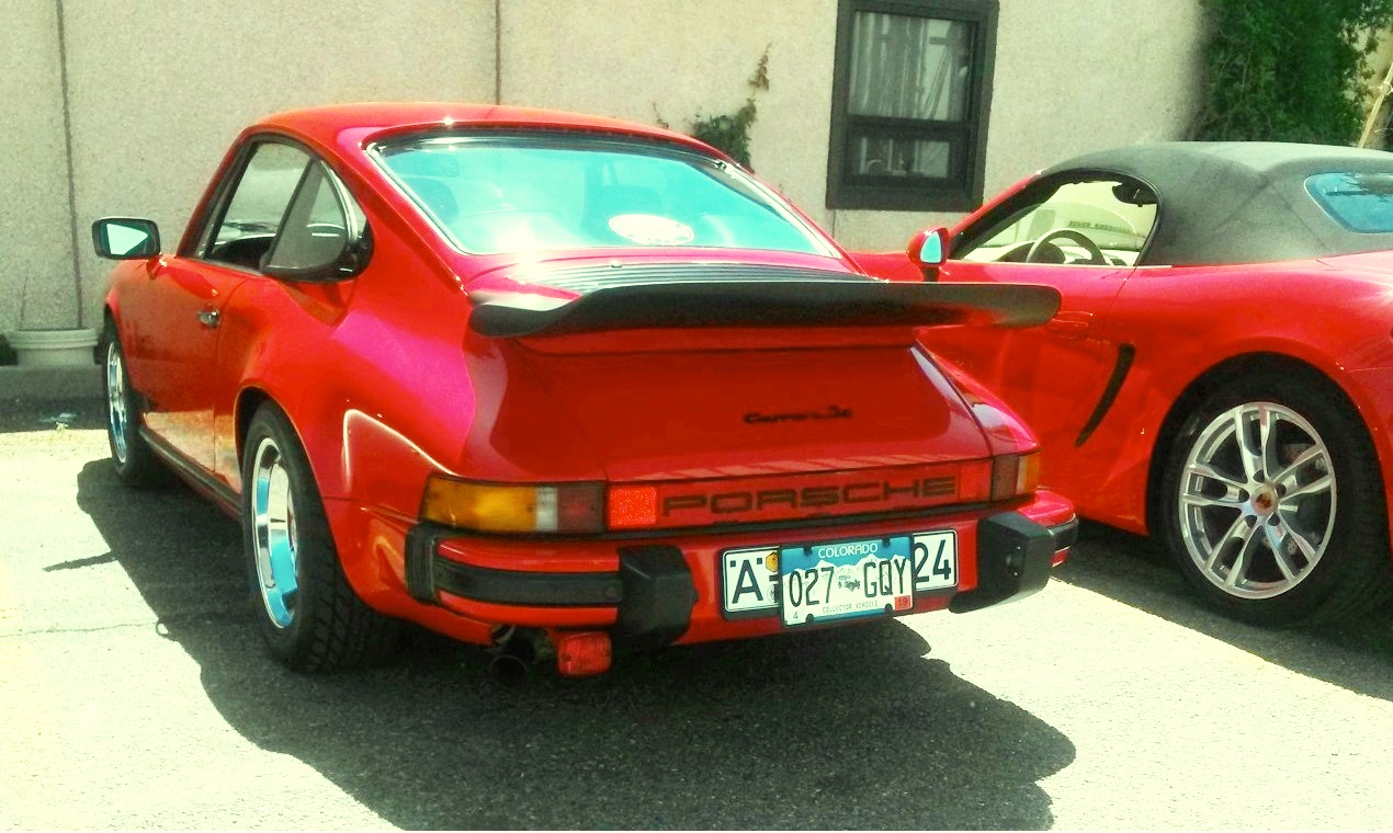

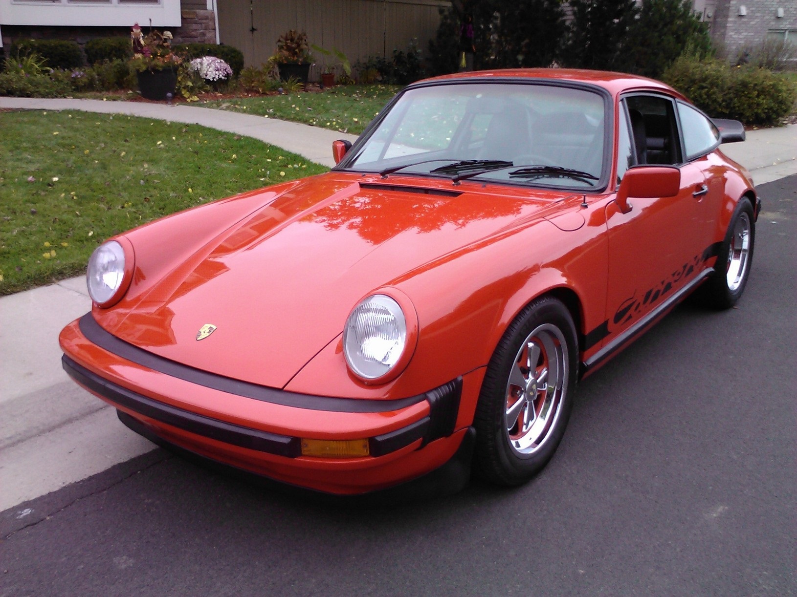

my 911 looks way more orange in the pic than it is in real life. Here is next to our '13 boxster.
