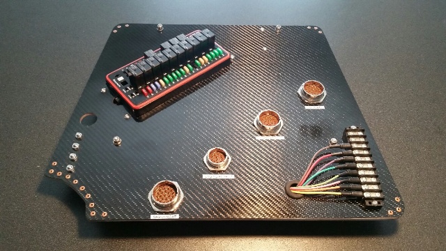

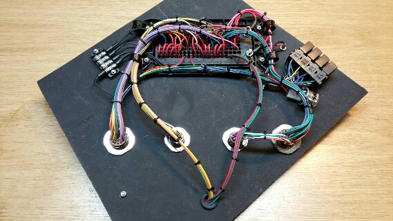

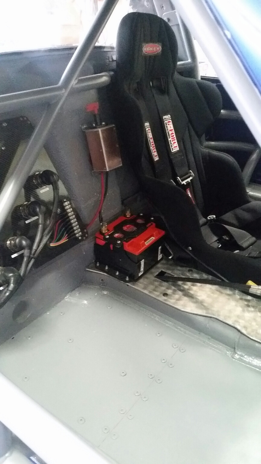

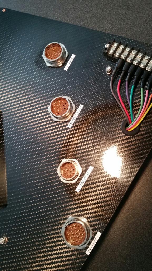

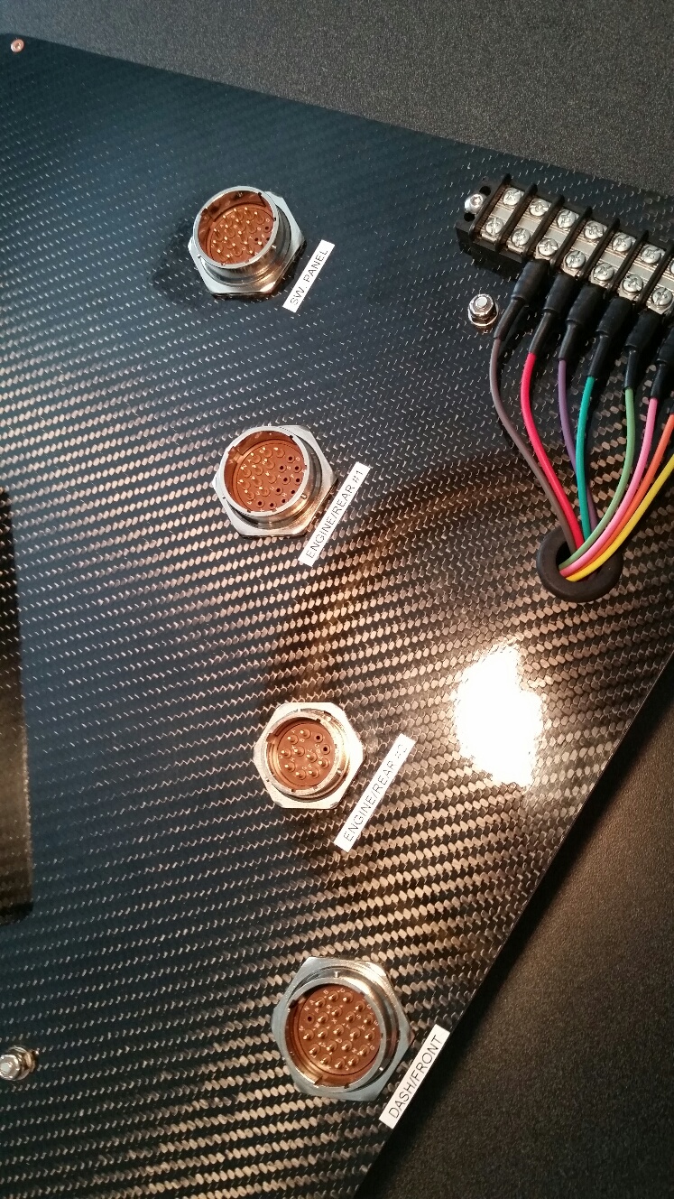

Tony, got any build pics of your wiring? Really interested in seeing that.
Not your solution...just another approach. Here you go Zach.
Tony
zach914v8
post Aug 24 2016, 11:10 AM
Post #28
Posts: 216
Joined: 26-November 10
From: Houston
Member No.: 12,426
QUOTE(Cracker @ Aug 24 2016, 12:03 PM) *
QUOTE(zach914v8 @ Aug 24 2016, 09:14 AM) *
Wow Tony, that is seriously spectacular work. Truly stunning craftsmanship. (IMG:style_emoticons/default/pray.gif) That's what I want!!!! Did you by chance build 2 of everything? lol

Thank you Zach...only made one set and hopefully never again! Matt has a good idea - reach out to FH and pick hi brain. All the best!

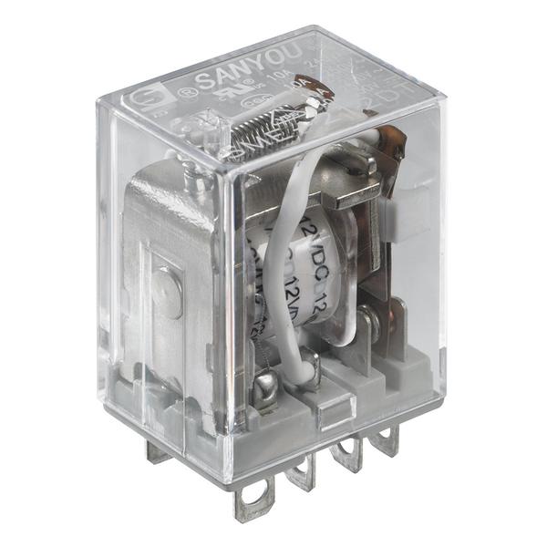

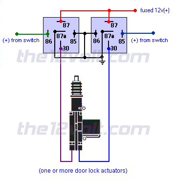

This from c contact? So is this like a monetary relay that switches polarity? Something like this maybe? 12 v dpdt switch rado shack # 2750043Attached Image
zach914v8
post Aug 24 2016, 01:27 PM
Post #34
Posts: 216
From: Houston
Member No.: 12,426
or is it something like this?
Mike Bellis

A simple DPDT relay can operate the pop up lights. They need a ht signal to go up and another to go down. Very simple to do if you have the skills.

QUOTE(Mike Bellis @ Aug 24 2016, 06:33 PM) *
A momentary on off on toggle switch can do it. Piece of cake.

QUOTE(zach914v8 @ Aug 24 2016, 05:12 PM) *
momentary might not work. The factory wires are constant. You would need to try it.

Member No.: 12,426
QUOTE(Mike Bellis @ Aug 24 2016, 07:27 PM) *
I think im going to have to bring my power probe home from work and test the stock functions of the headlights out and go from there.
