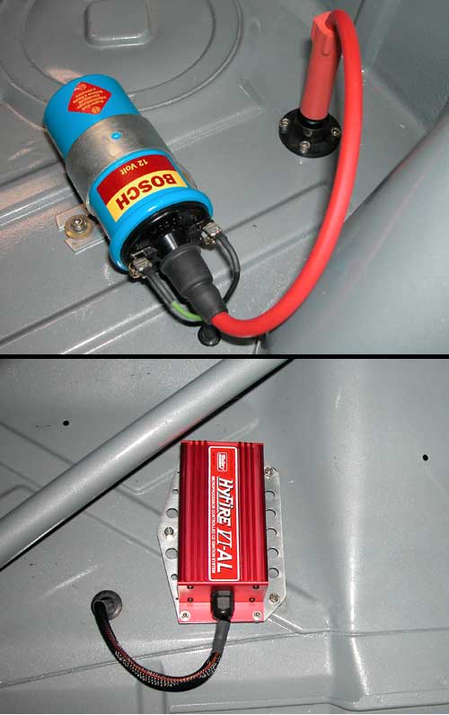

One of the pics on jake's site shows the trunk of the race car with a coil in it. Why is that?
And, where is the battery?

The rear trunk of my 914 is filled with my accusump, oil filters, Hyfire box with Safeguard knock retard system as well as the coil and even the engine breather box..
In the floor of the trunk I have cut a nice hole and tig welded an aluminum shroud to force air through my double Setrab oil cooler as well. The trunk looks like something out of an F 18...
The targa top still fits though!

QUOTE(brant @ Oct 14 2004, 07:03 PM)
I'd love to hear about the trunk coil too...
is it for air flow purposes, or heat to the coil?
yes the shifting, knew I forgot something.
The deal with the coil is just to get it out of the engine bay to keep thins uncluttered. Also, its not exposed to as much heat, Used a bulkhead fitting in the floor of the trunk and the wire from the coil to the dizzy has a pretty nice straight run.
Just hope the wires to the coil from the hyfire box are not too long.
The ignition box is inside to the drivers right.
Also going to mount the breather tank in the trunk.

but its always been my practice in building 914 race cars to keep all weight possible out of the rear trunk. (for corner balancing purposes)
I know there are cost and weight penalities for plumbing etc, but we always mounted coolers and accusumps in the front trunk for better Center of Gravity and better weight distribution..
