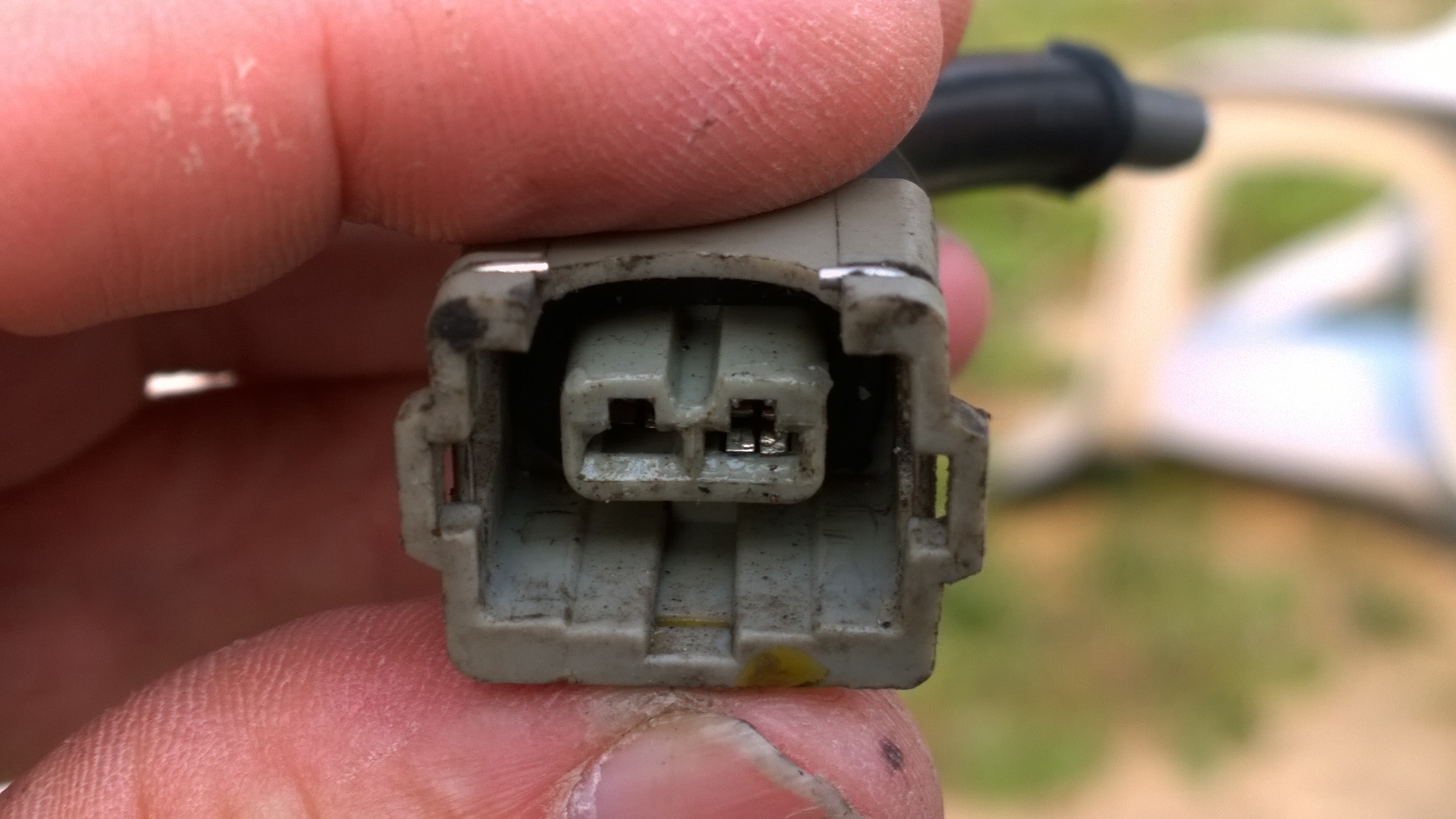

catsltd
post Sep 23 2016, 11:39 AM
Post #65
Posts: 181
Joined: 7-June 15
From: Calgary Alberta
Member No.: 18,814
http://www.914world.com/bbs2/index.php?act...t&id=514695.
I know this is not his problem,but this is why I wanted him to look at the connectors to the injectors.It fixed my miss,that I was unable to find.
Good Luck:
