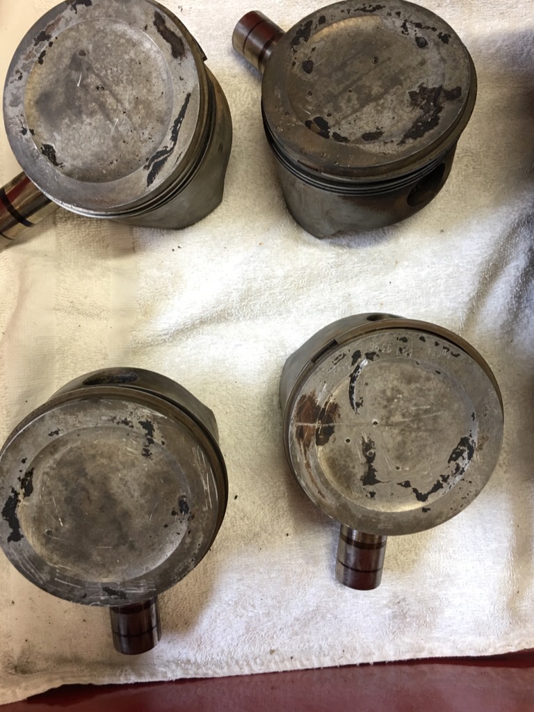

I had the Mahle 94 mm P&C pulled and replaced with 96mms
The pistons were cleaned with oven cleaner; now there are a few black carbon remaining. How should I proceed with removing them before looking for a new home ?

Will probley just use the oven cleaner on these too
toolguy
post Oct 12 2016, 11:39 AM
Posts: 1,276
Joined: 2-April 11
From: San Diego / El Cajon
Member No.: 12,889
Be careful, oven cleaner can have lye [sodium hydroxide] as the active ingredient. . It
eats aluminum fast. . better to soak them in a solvent or bead blast.
If you want them to look like new, bead blast with plastic bead medium.

I have a gallon of Berrymans carb/parts cleaner that comes with a basket. Drop the pistons in one at a time and let them soak for a day or two, they'll come out and with a little scrubbing most of the junk should wash away.

See if you can find a drill pad that looks like a green scrubbing pad, mount in drill press and hold piston while running drill press fast. Not a lot of pressure so you don't scratch the aluminum too much.
