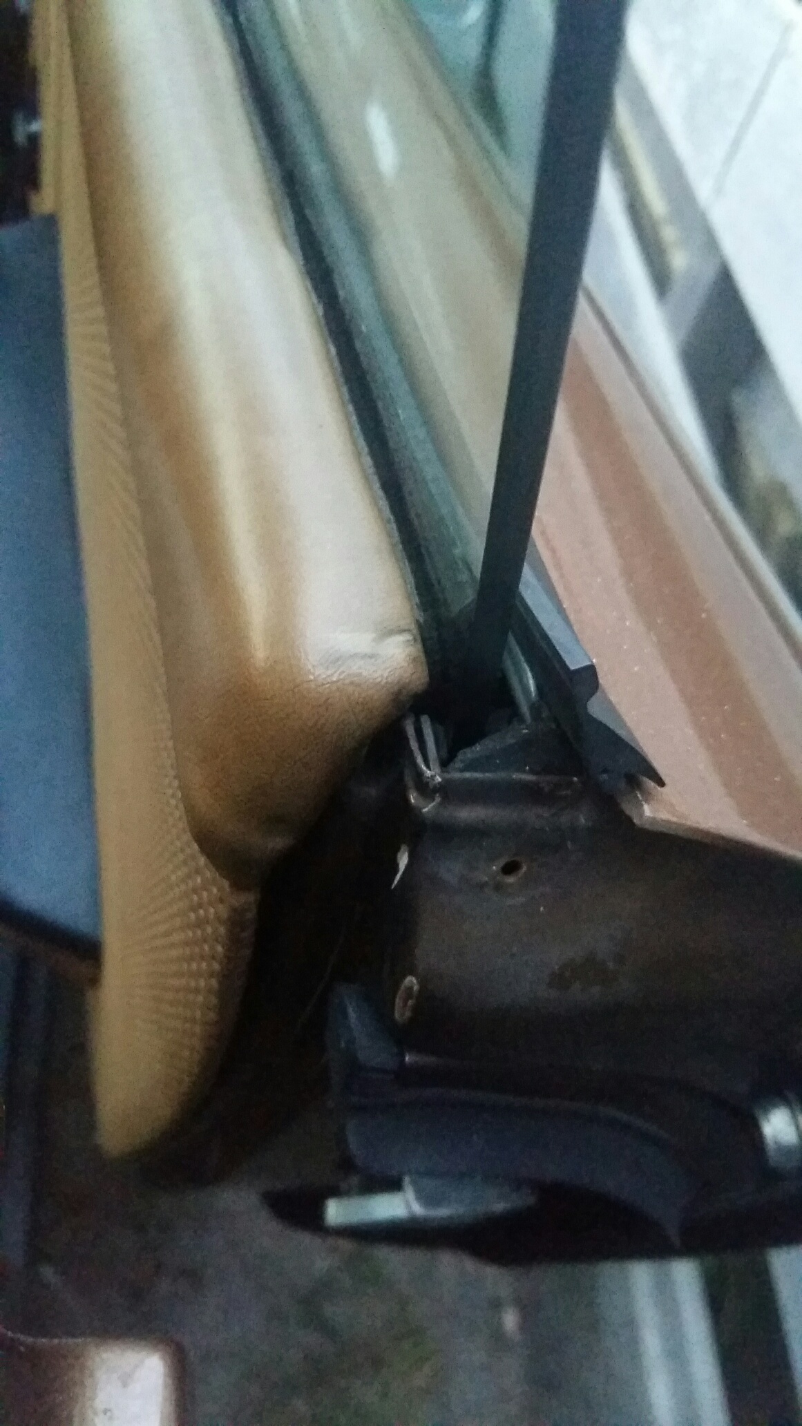

Hi, I miss the door end caps on my 1973 1.7
and the other side as well
I found two types online as replacements, I am not sure which one I need since that is not clearly stated on the different sites I find them?
Can somebody tell me which ones should be installed on my 73 ?
Thanks a lot for your feedback!

Pretty sure you'll need the later version.
The attaching screw is on the outside of the door and the glass slot is round.
The earlier one is fastened inside the glass slot and the glass slot is square.

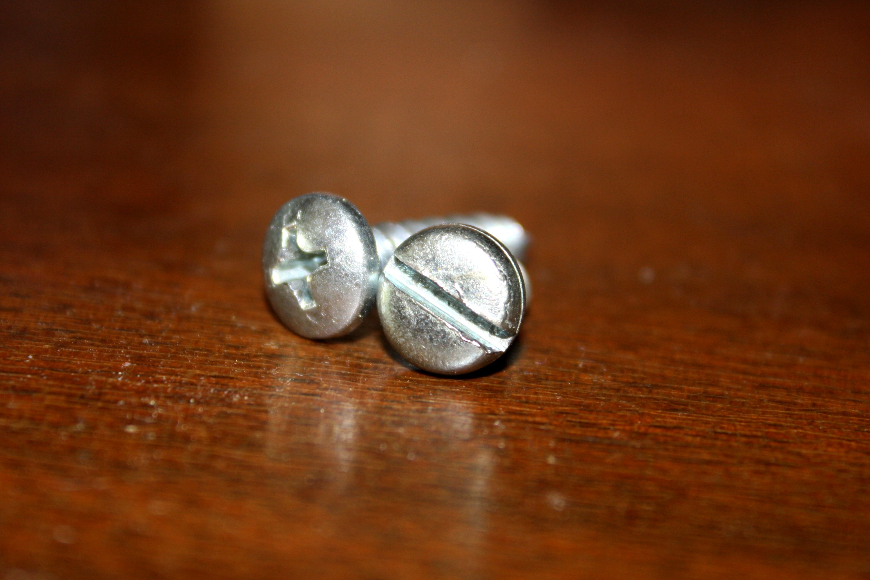

....dumb question....are the attaching screws for the end caps phillips head or flat head type? I've seen both types on various cars.

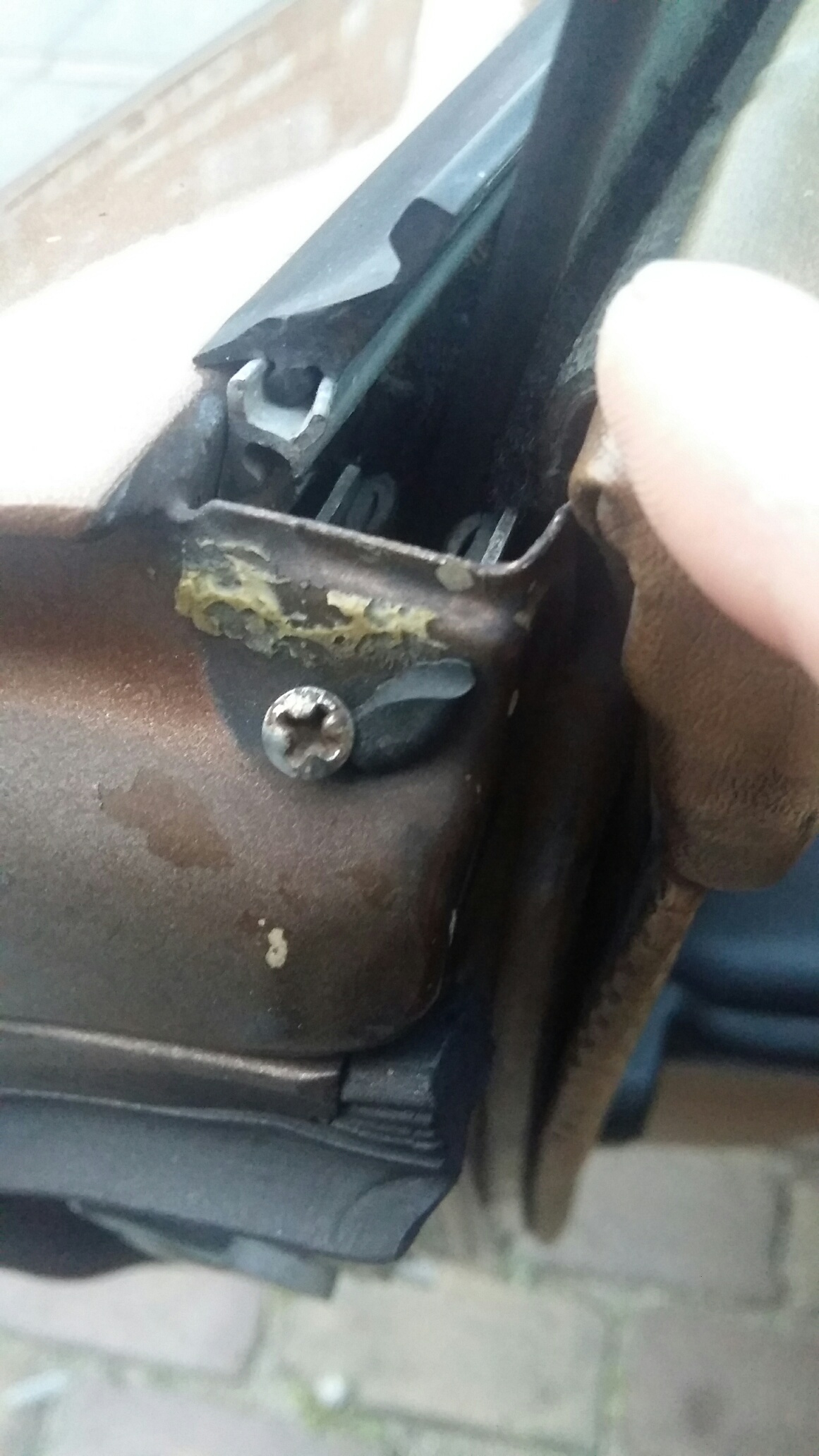

I have a philps scew in there. Not sure if that is correct...
@rgalla9146:
"Pretty sure you'll need the later version."
That would be the left one in the pic?
Thanks in advance!

Late
You need these
http://shop.914rubber.com/914-Late-door-en...ght-914LDEC.htm
Also pick up the correct scrapers while you are there.
http://shop.914rubber.com/914-Early-Outer-...ion-914ODSE.htm

Also screw should be phillips
Also made mine out of rubber not plastic so they will not break like the OEM

Your old Cap at the Car are the later one.The correct srew is B2,9x6,5 with a oval head.
(Linsenkopfschraube in german)

Interesting....these two low mileage cars are showing flat head type.

Mine is stock. Original owner. Phillips head.
