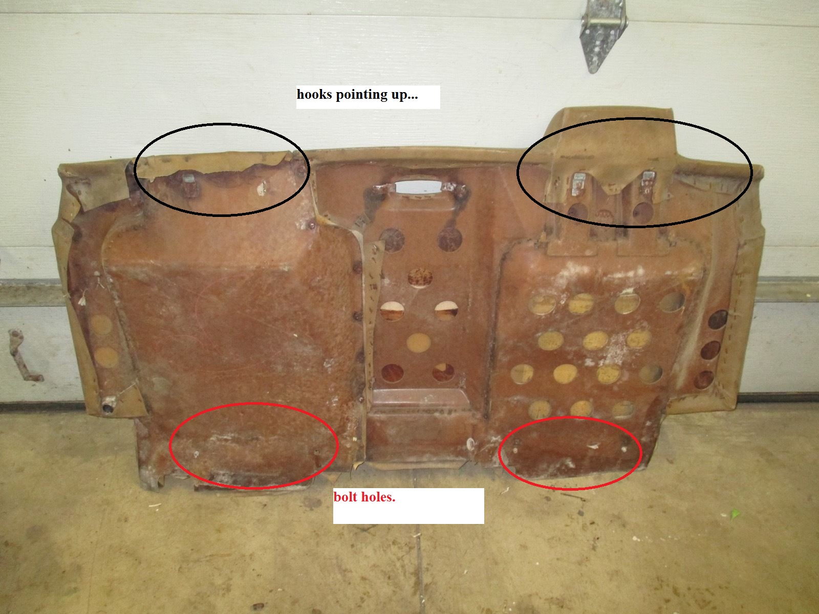

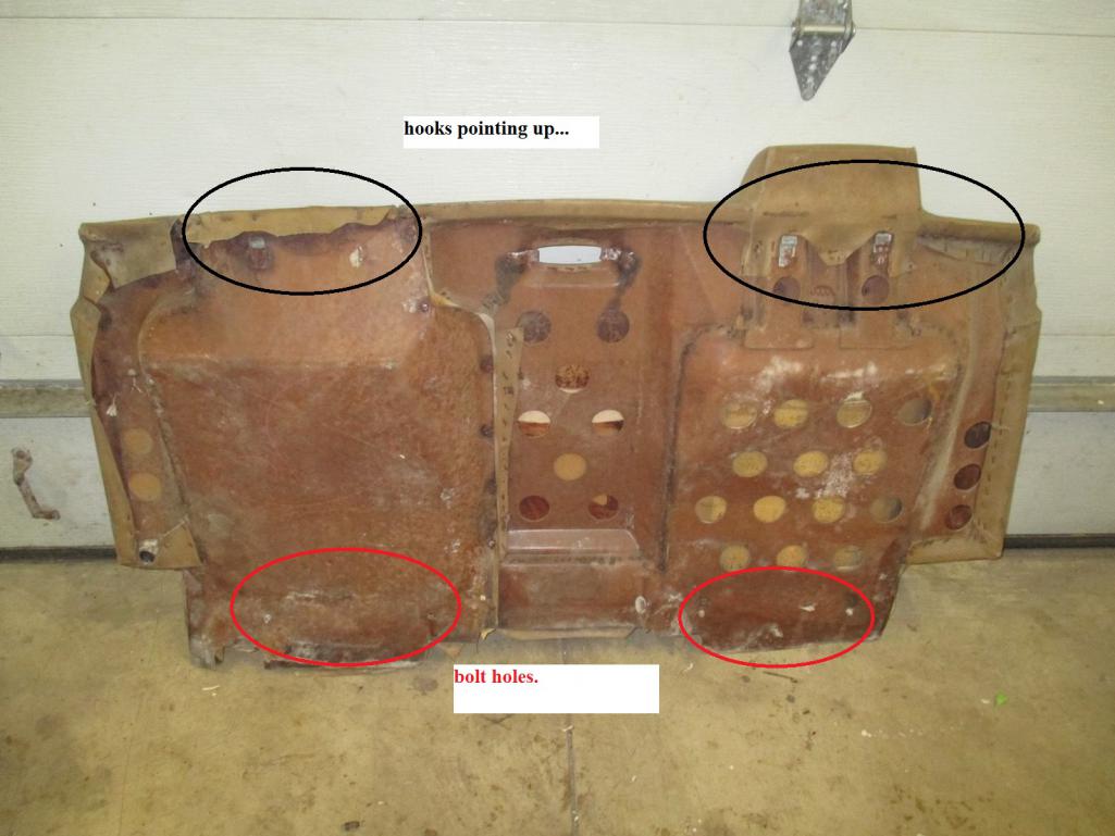

QUOTE(pbanders @ Oct 13 2016, 11:25 PM) *
QUOTE(rdauenhauer @ Oct 13 2016, 08:42 PM) *
Tougher on the early cars as the back wall has no recess for them, but you probably new that.
I've got the later back pad with the cutouts in it, I assume that helps. I'd need to remove the back pad, but it's attachment to the firewall that has me wondering.
Maybe you got your back pad off already. But if not and for anyone else that happens to wander by....
the attachment of the backpad to the fire wall is with small bolts that screw into plastic sleeves inserted into the fire wall. But you probably saw that cause the bolt heads are visible.
The crazy thing is the pad has hooks that point UP. They go in loops in the firewall. So once the bolts are removed, you have to pull the pad DOWN to get the hooks out of the loops on the firewall.

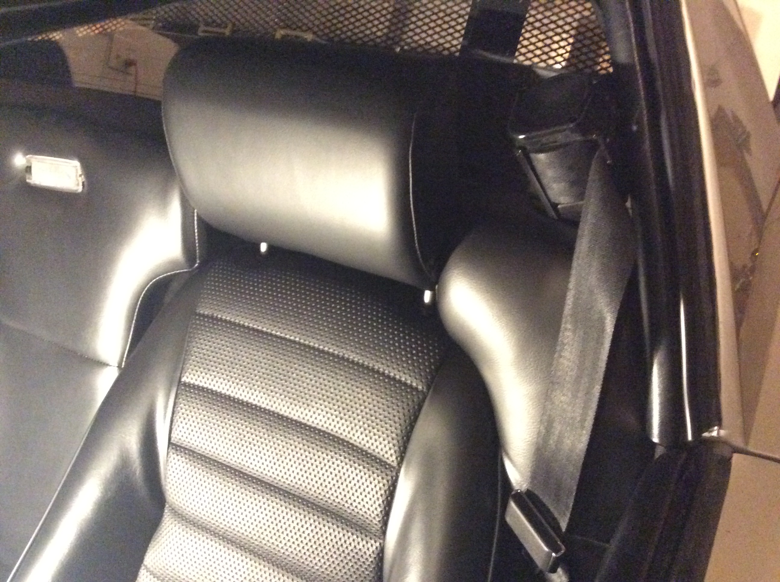

I must be one of those f******g lazy types since I added inertia reels to both seats. Besides wearing 4 or 5 pts in this state is illegal. I believe the reasoning is in a side impact situation you can't move the upper torso/head away from the impact.
After initially adding, I removed the driver side and after a few months got fed up with not being able to reach the radio and passanger side window crank, etc, so went back. Only regret on a 71 is the clunky appearance, but they do work.

QUOTE(malcolm2 @ Oct 26 2016, 08:44 AM) *
Thanks, actually, I haven't removed the pad yet, so that was really helpful.
