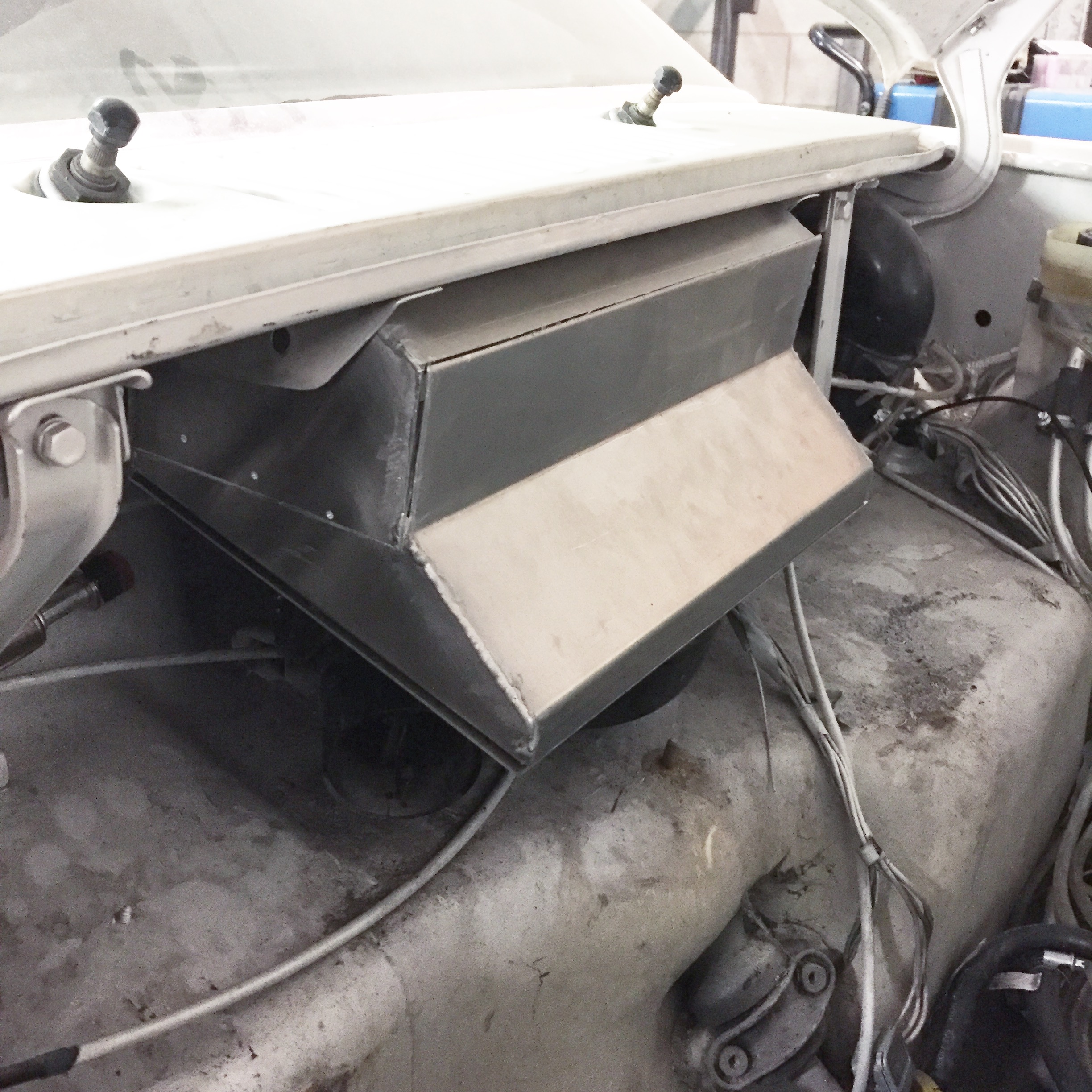

Nearly finished with the second incarnation of my air conditioning air box. Stock location, stock vents, stock fan, and no body mods.
This is the continuation of the A/C compressor project thread.

Is there any concern with the stock fan not pushing enough air for this to really be effective?

QUOTE(dlee6204 @ Nov 14 2016, 01:30 PM) *
Awesome! (IMG:style_emoticons/default/thumb3d.gif)
No idea. How would I know? (IMG:style_emoticons/default/wink.gif) We'll see soon enough, and don't forget while the car is in motion there is a high pressure zone pushing air into the air box.
This is how designing custom parts works. You gotta put down the pencil at some point and just build it, then see how it works.
Steve

Is there an option to recirculate the air through it? Otherwise your always competing with the outside air.
Awesome job though!! Are you going to sell any of this ala carte?

Also, could you make it big enough to stuff a heater core in?

QUOTE(timothy_nd28 @ Nov 14 2016, 02:17 PM) *
I'll bet his design is for an Air Sucker so he'll probably keep the stock heat. (IMG:style_emoticons/default/beerchug.gif)

QUOTE(timothy_nd28 @ Nov 14 2016, 05:17 PM) *
It's possible. But I have a different, and better idea for that.
