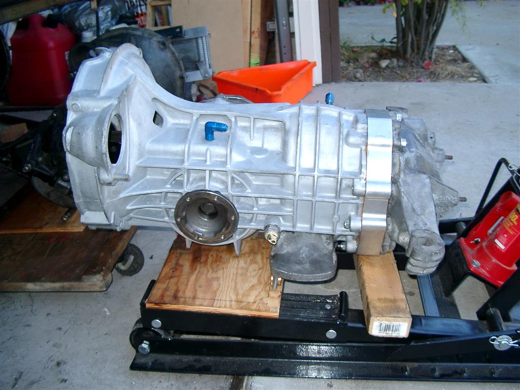

My equipment: race prepared 901 with AFNSY gears and billet intermediate plate. 335 HP 3.4 l twin plug six. Track only 914.
My experience: after 16 years racing with this configuration, I have had two failures - 3rd gear and ring/pinion. Both failures happened I believe because I was trying to eeke out little faster lap time by riding the curbs and gators at the track. I think that the severe loading and unloading of the drive train when driving like I did prematurely caused the failures. I don't drive the curbs much anymore and consequently have not had a transmission failure in more than 10 years. I do change gear oil regularly and look for evidence of problems and I tear-down and freshen (bearings/synchros) about every three seasons. I use first gear to get moving and never use full throttle in first. The billet intermediate plate is important in high HP cars, in my opinion.
Your experience may vary.
Best,
Steve

I should add to my previous post that I do use a cooler that directs cooled gear oil to the gearset and the R&P.
