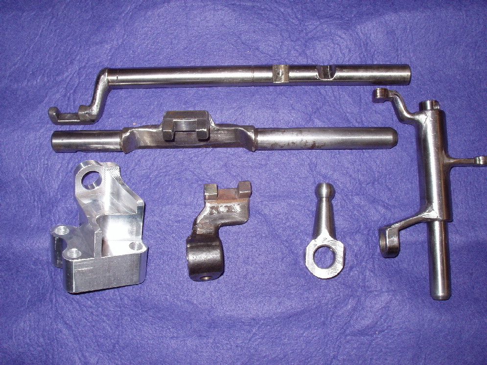

916 is only a Porsche project name for this gearbox. It means that a 915 gearbox was adjusted to fit the 914 with own Porsche manufactured parts. It was only offered in a very small qty. that days. Nowadays it´s become more common and necessary if you install a big 6-cylinder to your 914.
Important is that you don´t need a different exhaust system and that the shift mechanism is going directly into the gearbox (like the 914 2.0 version). It does not have an extra turn of the shiftrod like the 914 1.7 had. That means it´s as precise as the later 914 gearbox (compared to the older type).
See one more picture of the mechanical components (Porsche OE repros also):

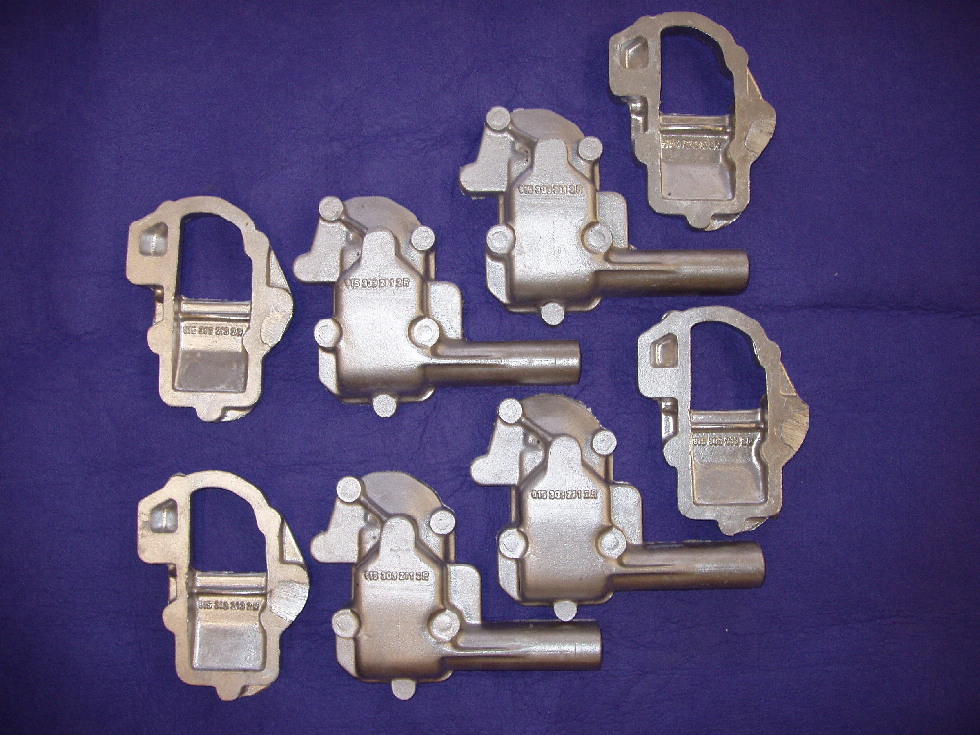

today I received further casted parts from the faundry. These parts sit on the underside of the gearbox and contain the shiftrod and the shift rocker. They still have to be milled, but currently I suffer from a cold I caught outside. Only the mechanical speedo drive still has to be finnished. I´m currently designing it with CAD. For those who use electronic speedo drive the kit will be available by the next two weeks.
Look at the pics!
Martin

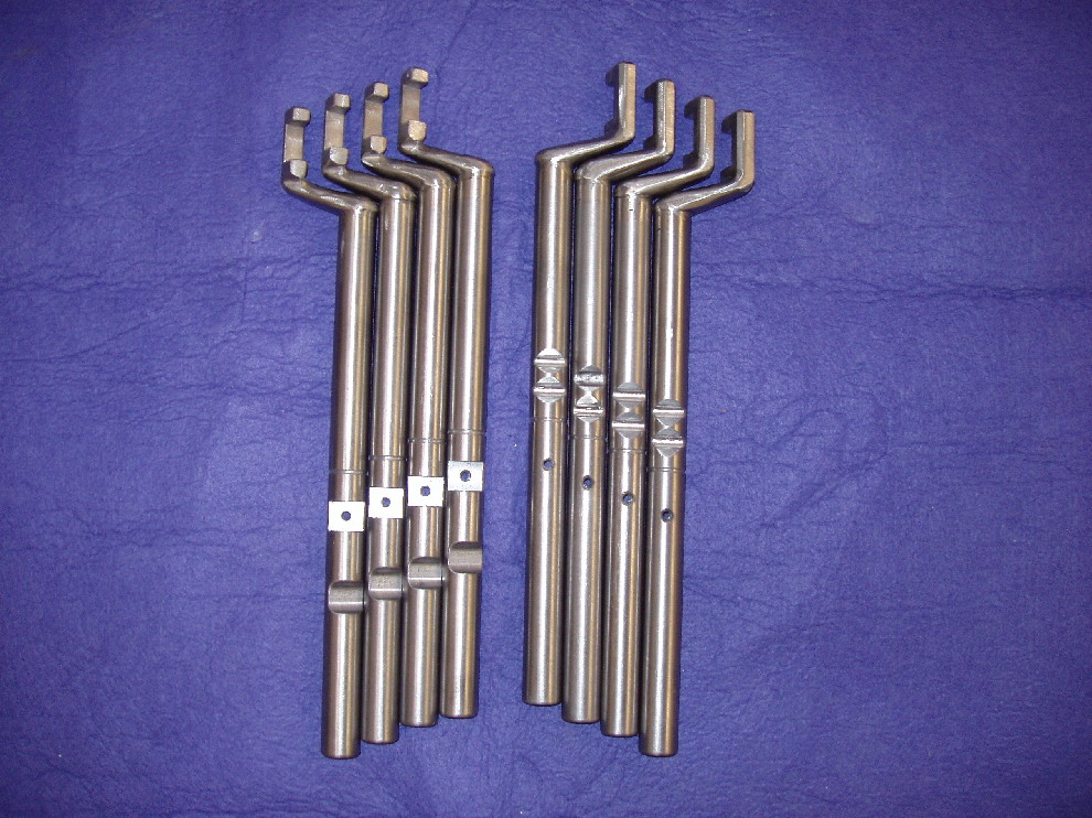

Hi,
finally received the other 4 sets of the shift housings yesterday. Now we can start milling the first 5 sets of these cases. Additionally received the first batch of 8 shiftrods from the fellow that works for me. They are very good and it´s not easy to see a difference to the origianl part. Lot of work with these shiftrods, but result is good.
Martin Bott

post Feb 12 2010, 12:11 PM
Posts: 92
Joined: 1-August 06
From: Germany
Member No.: 6,554
picture of the shiftrods:

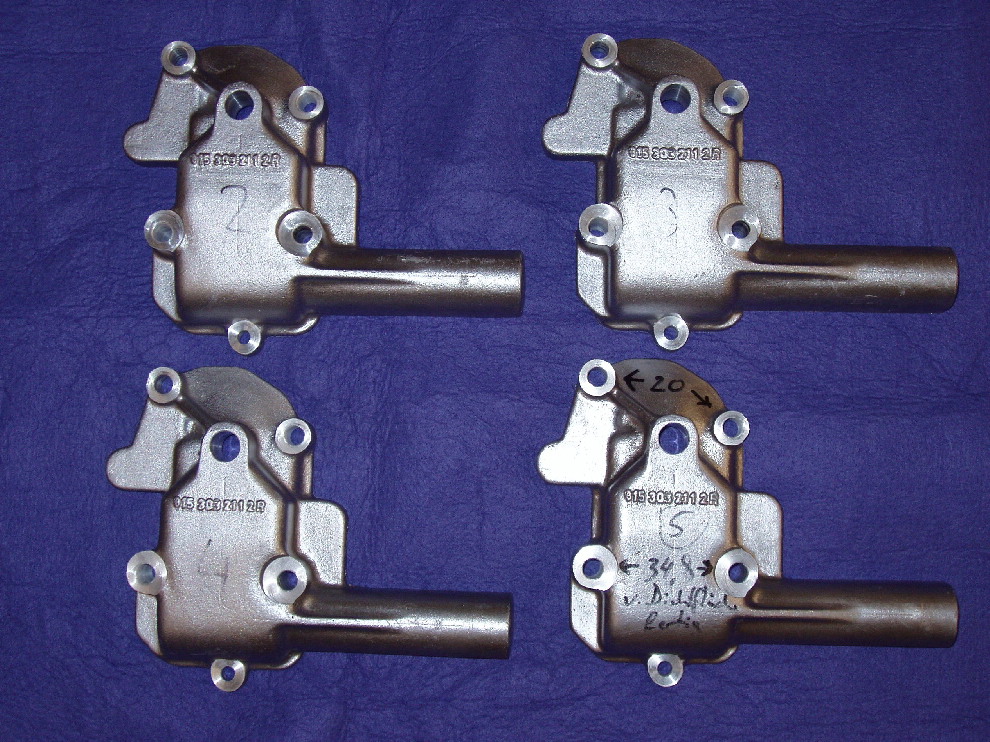

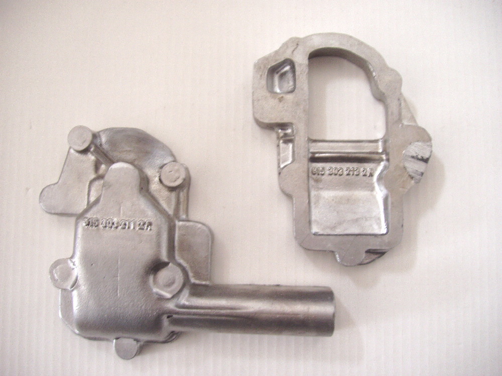

23.2.2010:
pictures of the milled shift housings. The long drill for the shiftrod still has to be done. Have to do an external order on the mill first.
Martin Bott

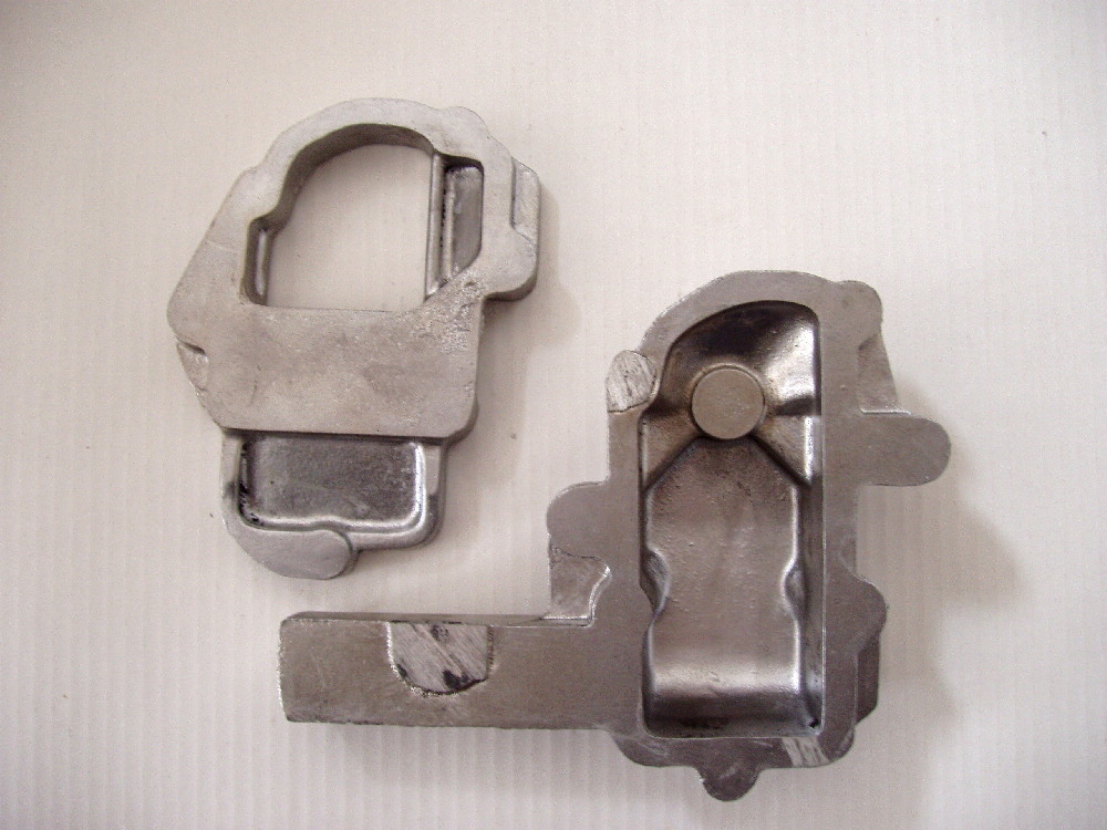

post Feb 23 2010, 02:12 AM
Posts: 92
Joined: 1-August 06
From: Germany
Member No.: 6,554
picture from the other side:
