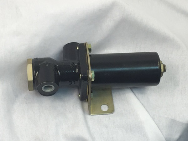

So is this just a date code thing? early/late. Here are the early/late images from PMB site http://www.pmbperformance.com/914-brakes.html ( he uses the same photo for both early/late) and mine from my six and they all look the same as your photo... (IMG:style_emoticons/default/confused24.gif)
* except for your rust and my dirt/filth (IMG:style_emoticons/default/biggrin.gif)

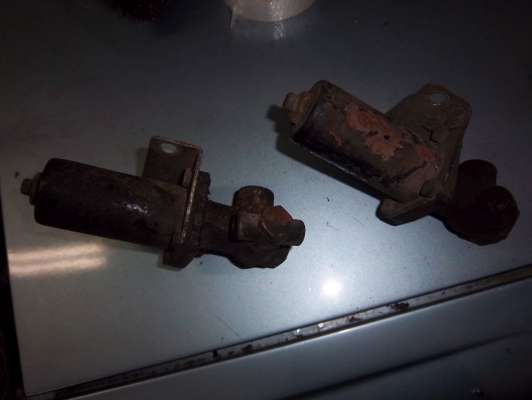

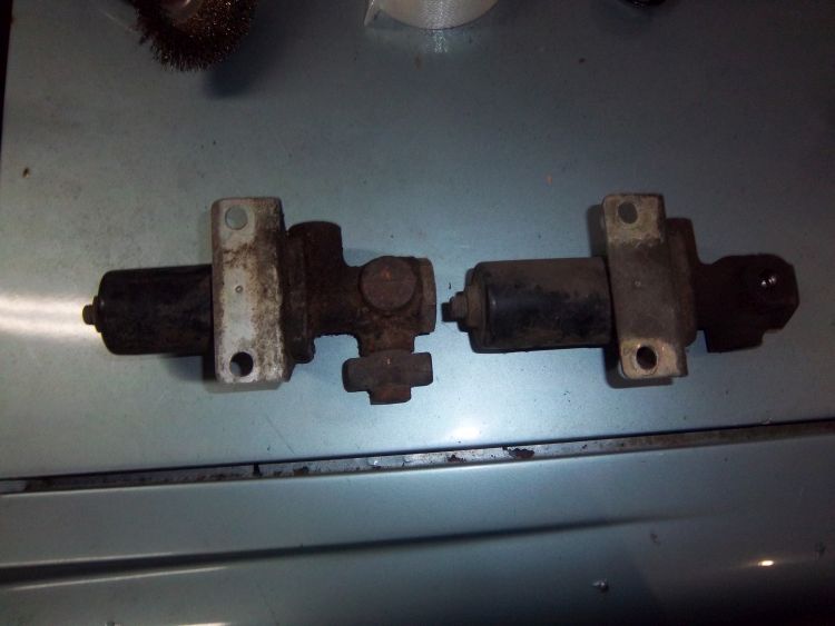

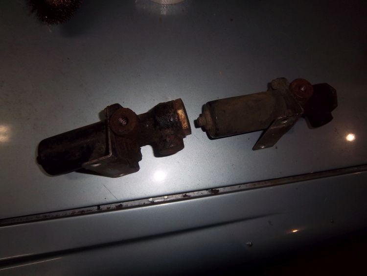

Here are the two different styles. Haven't cleaned these up yet, but you get the idea.
Mark sent you a PM

Mark, the picture you have is of an "Early" not a late (T-fitting).
Here's the skinny, and, think "economies of scale"
Early pressure regulators had a fluid inlet at the bottom and a fluid outlet at the top. A single inlet was fine but, the outlet now needed to go to the left and the right sides of the car. A brass "T" fitting with a banjo bolt was employed to do the job.
The valve had always been bossed for multiple outlets but, only the one at the top had been tapped to 10x1. In Garold's picture above you can see the boss on the early regulator on the left (circled in green).
Later pressure regulators were simply tapped on the top "and" now the back side facing the firewall. The right side line went into the back and the left side went directly into the top. This did away with the more expensive components (brass T fitting, banjo bolt and copper washers). You can see the later one with the same boss tapped to 10x1 on the right (circled in red). Eliminating the T was a cost saving measure.
So... the down and dirty; early ones have the brass T, later ones do not. If your pressure regulator is missing you can tell by the VIN or, by your lines. Early ones have straight line ends that go directly into the T. Later ones have 90 degree bends at the end of the lines.

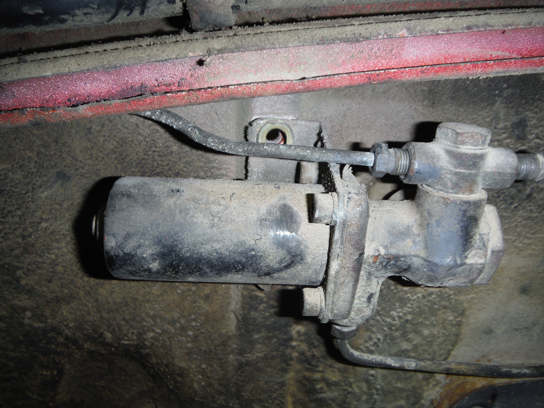

One last question E - when was the transition to late?
I thought my '74 would have a late regulator on it but I guess it's an early one as well.
