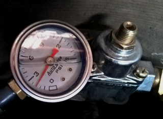

QUOTE(Junebug @ Mar 3 2017, 03:07 PM) *
Depends on Carbs, I use a Holly at 2 psi for 10 mm ID line and dual Dellorto 40's
That's odd,I have the same regulator (12-804) and can't get 2psi its not in the range if the adjustment,anyway 2psi is low,I run 3.2psi and have no issues.
I see in the pic your regulator is screwed right out ,not sure how you get 2psi....just asking (IMG:style_emoticons/default/dry.gif) .

QUOTE(porschetub @ Mar 3 2017, 12:38 PM) *
I know this thread is old, but I want to answer this. the 12-804 has a range of 1-4 psi @ the spec sheet ( https://www.summitracing.com/parts/hly-12-8...a/instructions), and I run a 1-7 psi pump. I run at 2.5 psi now and at 4000-8000 feet altitude. At sea level aggressive driving will starve the car so I turn up psi then.

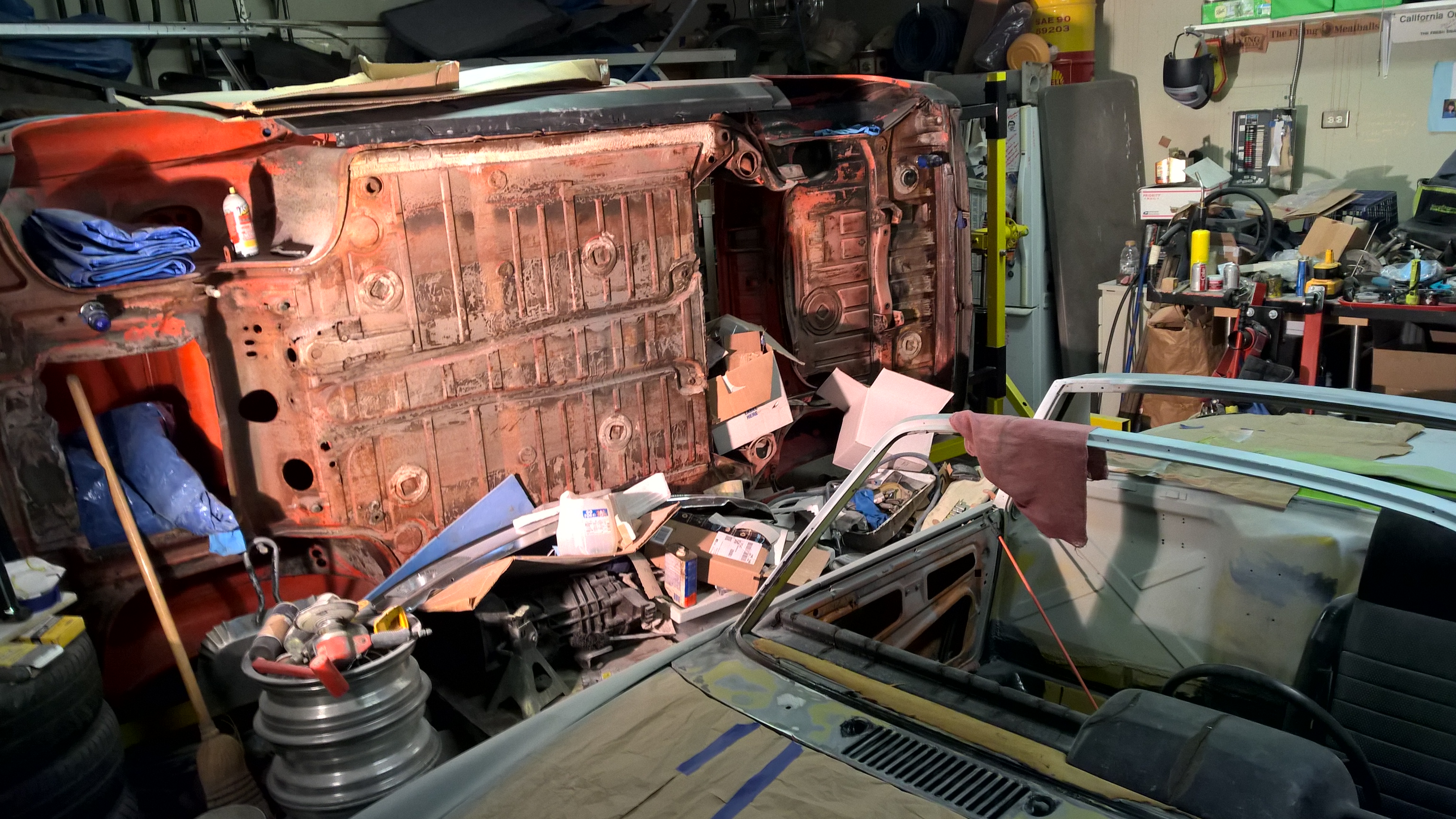

Oh here's that car "Tang" on the rotisserie. There has been no movement in that garage from that day 2017 until this year 2019 around July..Attached Image
