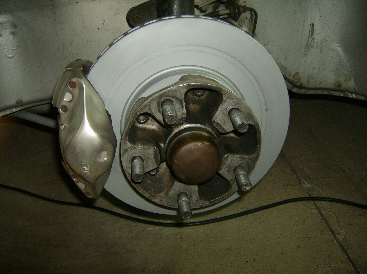

Going faster means I need to scrub off more speed too. As I mentioned in another thread, this resulted in warped rotors. The low front air dam does its job well keeping air from under the car, but unfortunately blocks airflow to the front brakes. It was amazing how hot the front fenders got!

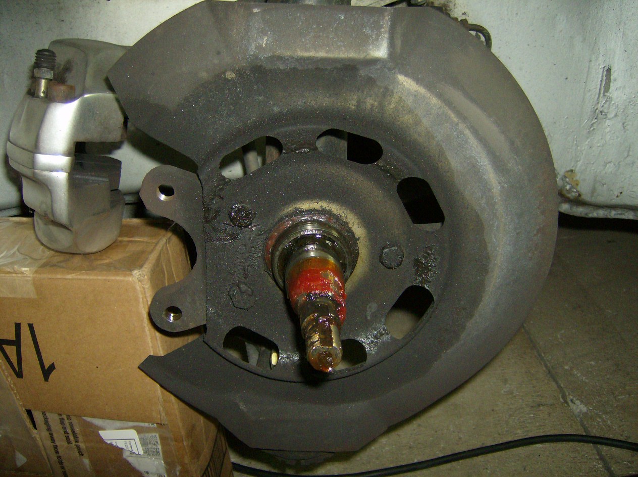

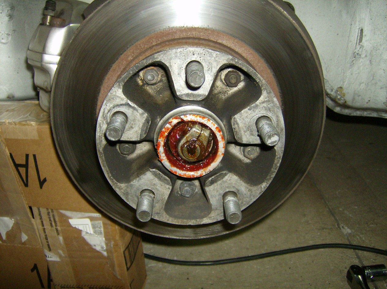

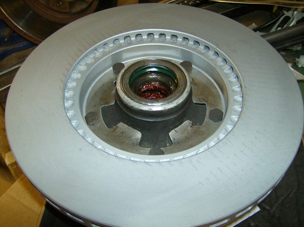

So first, get the old rotors off
Clean up the spindle and remove the original backing plates

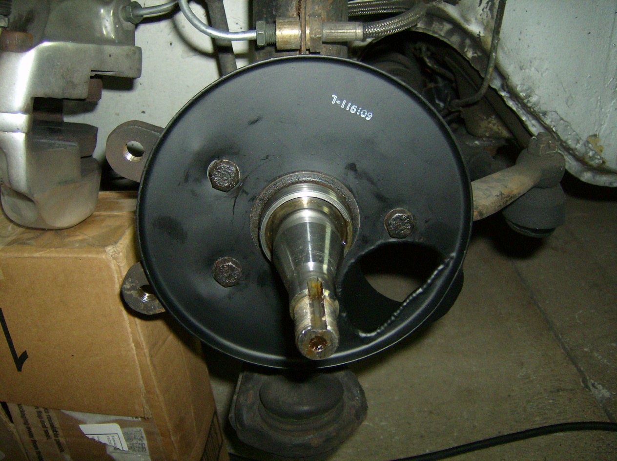

Put the new AJ ducted backing plates on

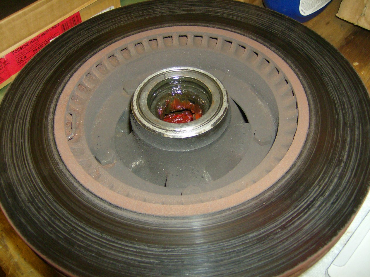

Disassemble the rotor from the hub

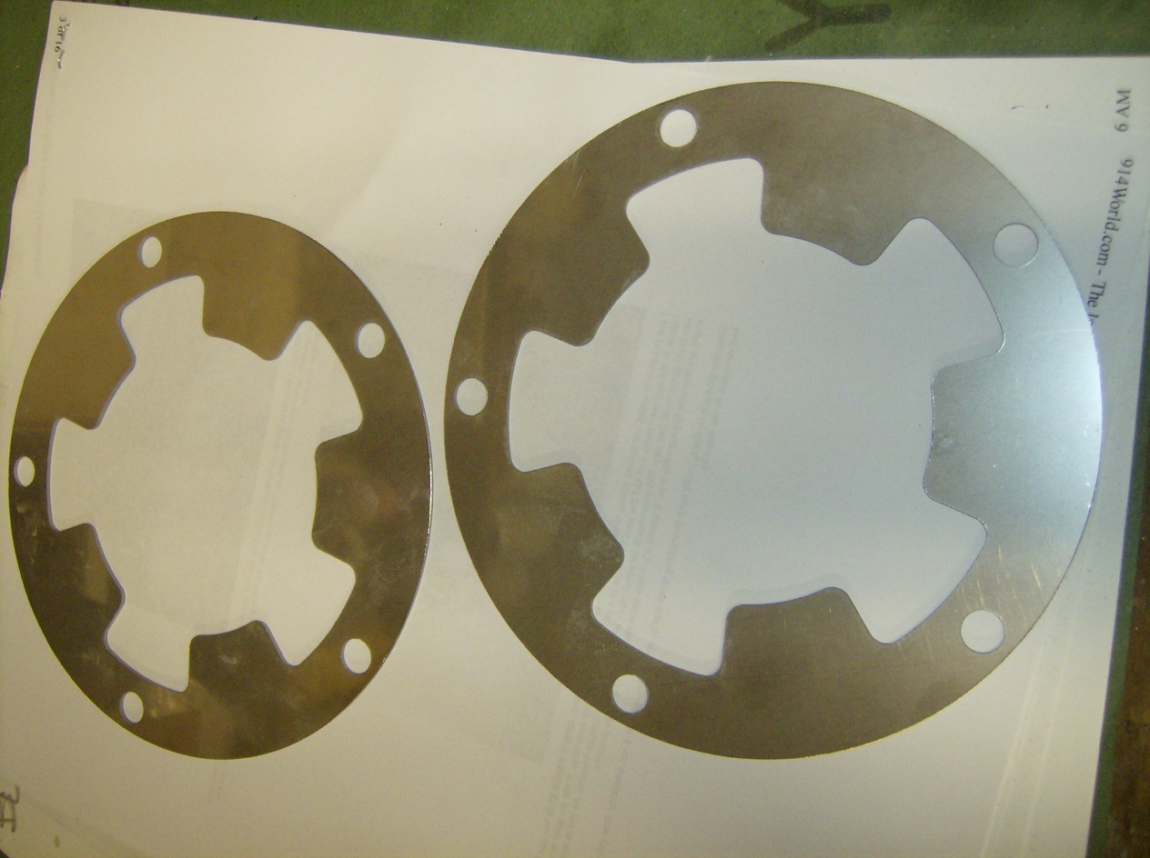

Smart racing is no longer and I couldn't find the air blockoff plates so I drew my own on AutoCAD from dimensions found online and had them waterjet locally out of stainless.
Install the blockoffs and massage them a little to fit just right
Put the rotor back on and massage the ducted backing plates to fit just right. BTW, the DAPO put the front wheel bearing seals in backwards. I didn't have new ones to put in so those pictured here are installed incorrectly!
Put it all back together and drive it
I found Zimmerman rotors on www.partsgeek.com for a decent price and free shipping.

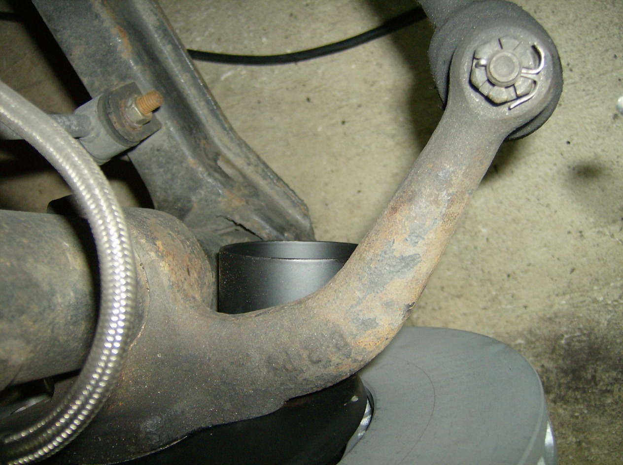

Next is to fabricate some duct manifolds for the A-arms and purchase some not so cheap silicone or neoprene duct.

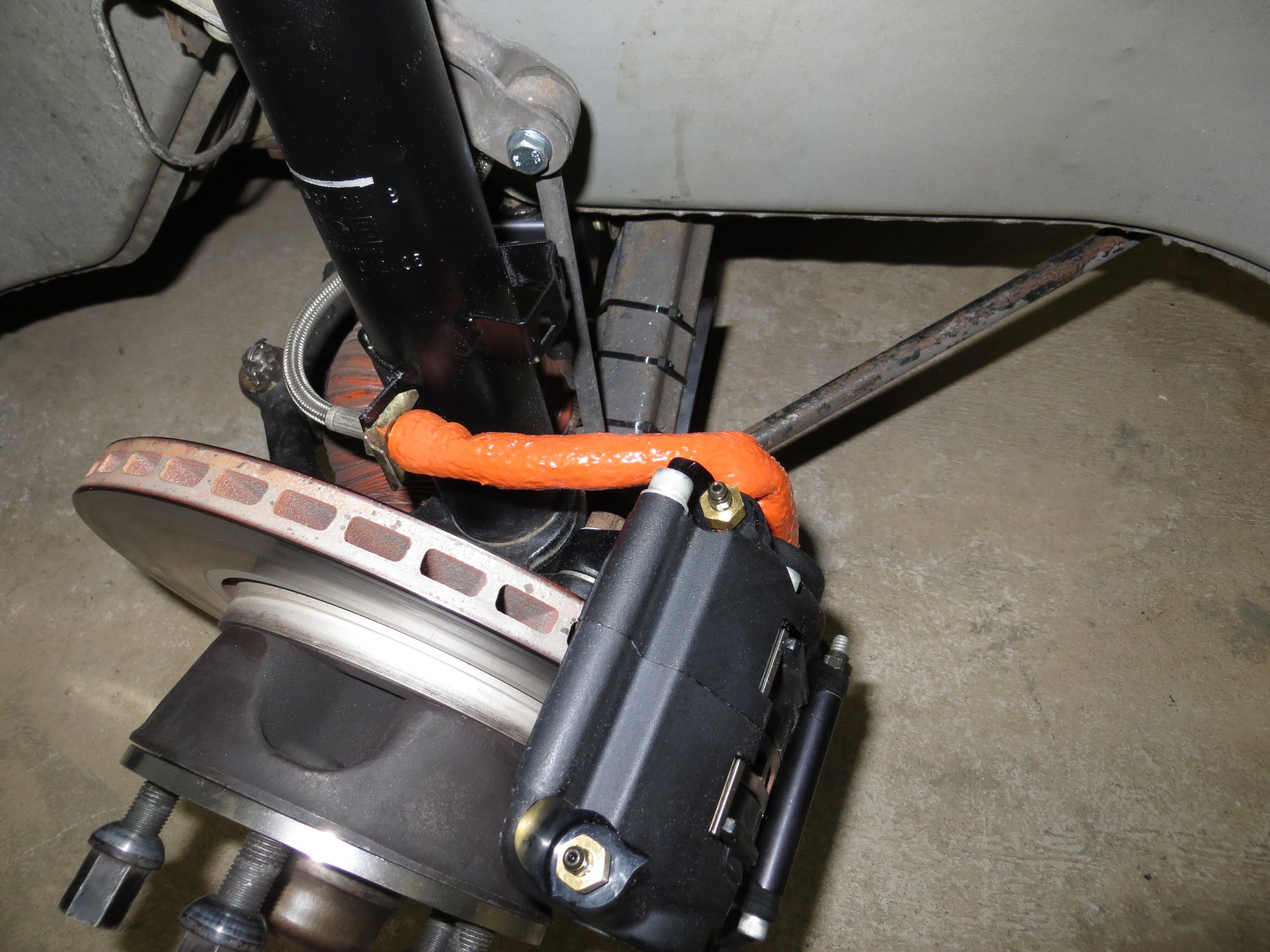

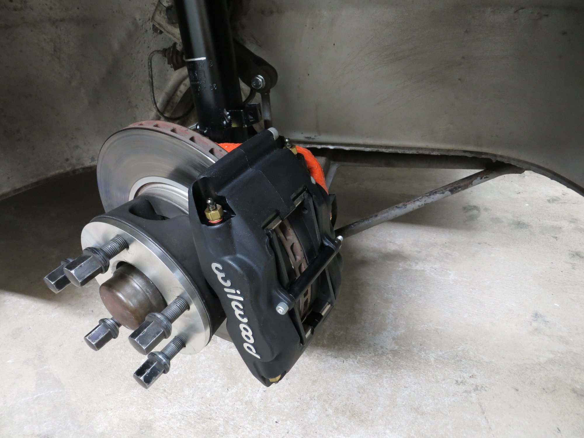

As well as swapped out my awesome Brembo AM calipers from Eric at PMB for a set of 4 piston Wilwoods with a lot more pad area and thickness. The Wilwoods were literally a bolt on with a 2mm spacer. Why more pad area? Mainly for better longevity and a slightly better heat sink. Of course this required a strut housing swap to go from 3" spacing to 3.5" spacing. Consider that thread your winter time entertainment (IMG:style_emoticons/default/chair.gif)
I also insulated the hard line which runs about an inch away from the rotor face with fire sleeve.
...and "while I was in there" I swapped out the stock bushings for Rebel Racing Teflon RSR setup.
Anyways, a couple of pics for your enjoyment!

Forgive my ignorance Tom , what was the "blockoff" plates installed on the back of the rotors for blocking off ???
GR8 thread man !!!! (IMG:style_emoticons/default/piratenanner.gif)
Jack
tomeric914
post Apr 6 2014, 09:41 AM
Post #65
One Lap of America in a 914!
Posts: 1,321
Joined: 25-May 08
From: Syracuse, NY
Member No.: 9,101
QUOTE(jaxdream @ Apr 6 2014, 10:14 AM) *
Jack, no problem! The blockoff plates force all of the air through the radial vent holes inside the disc. Without the blockoff, the air would blow past the vent holes and out the 5 big holes in the hub. Those 5 big holes correspond with the stud locations. The blockoffs are only needed when air is ducted to the rotors like I have done.

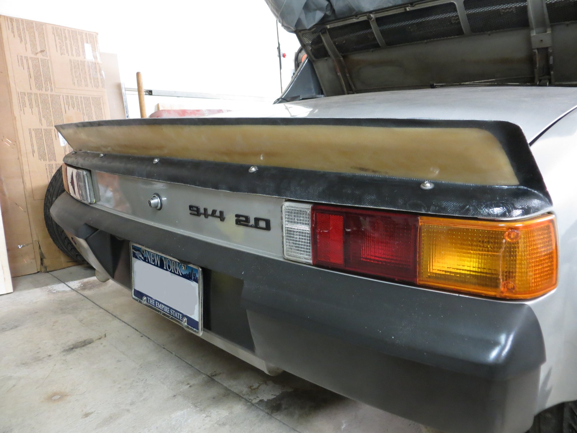

Finally added my Sheridan rear spoiler. One of the nicest aftermarket fiberglass components I have purchased.
Link to the "How-To" portion of installing the rear spoiler: http://www.914world.com/bbs2/index.php?s=&...t&p=2022462

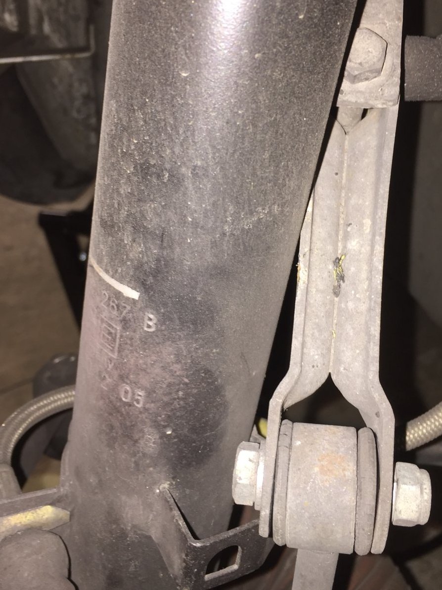

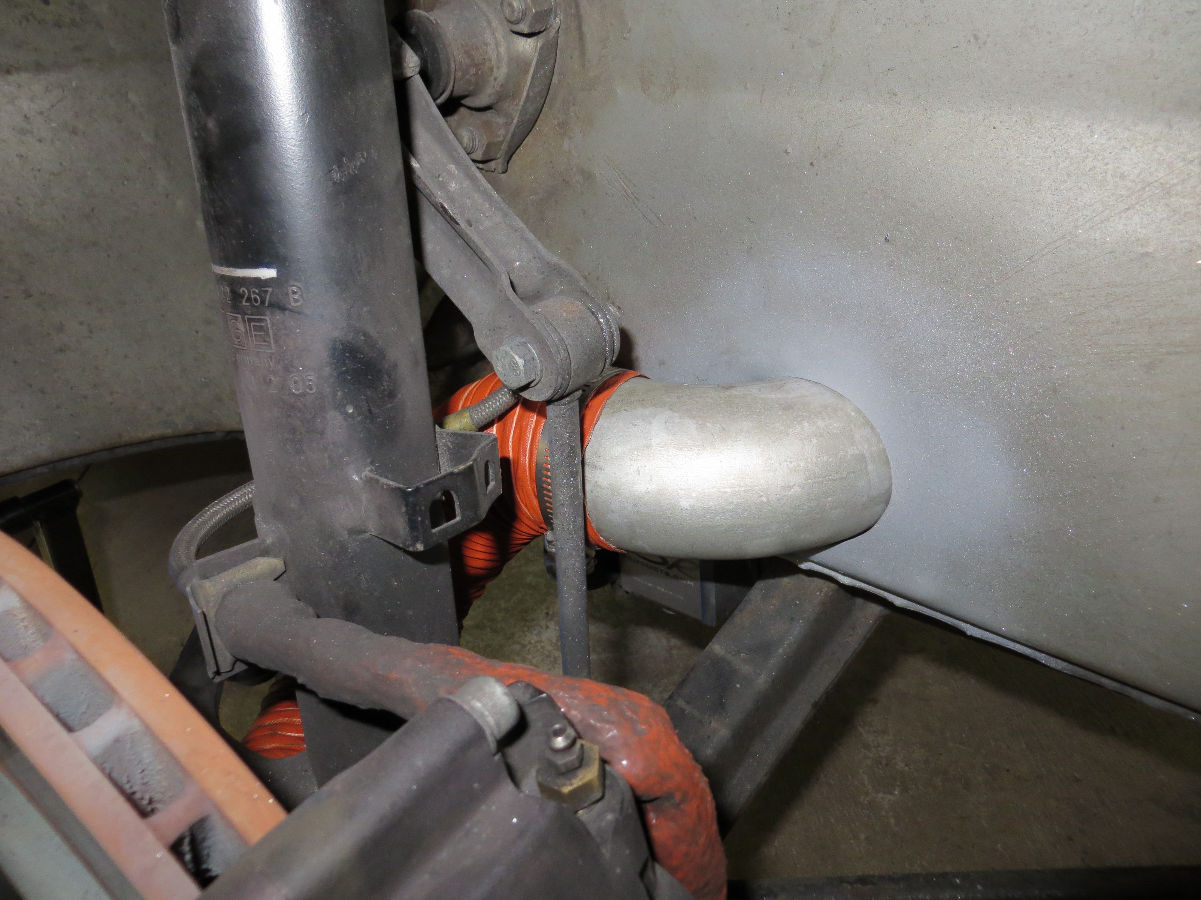

With the Christmas break, I finally took the time to relocate my brake ducts from the A-arm scoops underneath to an integrated location within the oil cooler housing. The trick was finding a location where they did not interfere with the suspension or steering.
I found a couple of 2.5" aluminum elbows off eBay and fit them just above the A-arm behind the sway bar links.
I also discovered that my sway bar had shifted itself to the right and was in contact with the strut housing. Weird that it hadn't happened in the past 10 years.
This is the stock 15mm sway bar so I picked up a couple of split clamps from McMaster along with a couple of nylon washers to prevent future squeaking.
First, I re-centered the sway bar. I drilled the 1/2" washers to 5/8", since the local hardware store only had 1/2", and then slit the washers so that they could be installed without removing the bar. They cannot be slipped over the ends of a stock bar because the bar is tapered to a square which engages the sway bar arms. Then, I installed the split collars next to the washers on each side.

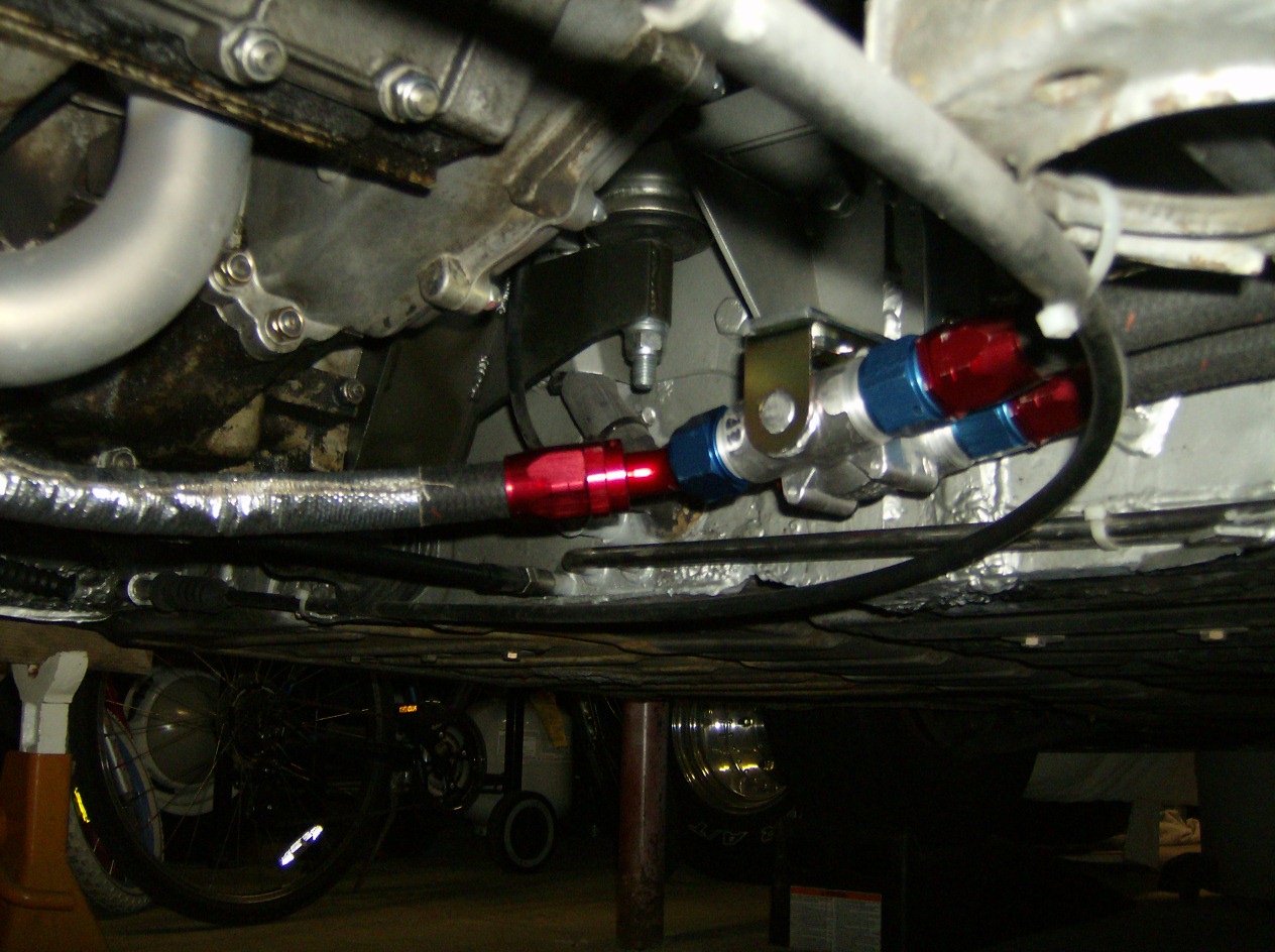

Tomeric, can you please share a picture of how you routed the oil lines into the tunnel from the engine side?
Great build thread by the way.

QUOTE(totle @ Sep 7 2018, 04:18 AM) *
...can you please share a picture of how you routed the oil lines into the tunnel from the engine side?
Post #53 has all of the important views as far as where I cut and what I used to line the sharp edges with.
http://www.914world.com/bbs2/index.php?s=&...t&p=1670785
From the engine firewall side, I fed the lines in through the heater duct. I don't have any pics of that, but it should be self explanatory.
I did connect the two lines going to the heater duct to a 200 deg F Mocal thermostat.
