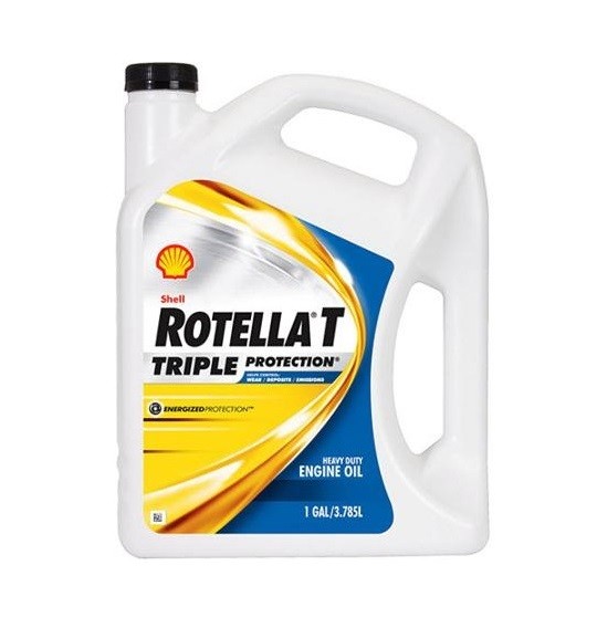

Which Shell Rotella do you use?

I would assume Mark's shop uses the original dino (pic below).
I've also used T6 and like it, but it's synthetic, so never use it on a new engine till break in is complete and synthetics have been known to make leaks in aircooleds worse.
(IMG:http://www.914world.com/bbs2/uploads_offsite/www.ruralking.com-26-1501503284.1.jpg)

Does it come in 20-50. I couldn't find it on the website
Nope, 15w40, 10w30 and a couple of single weights.
