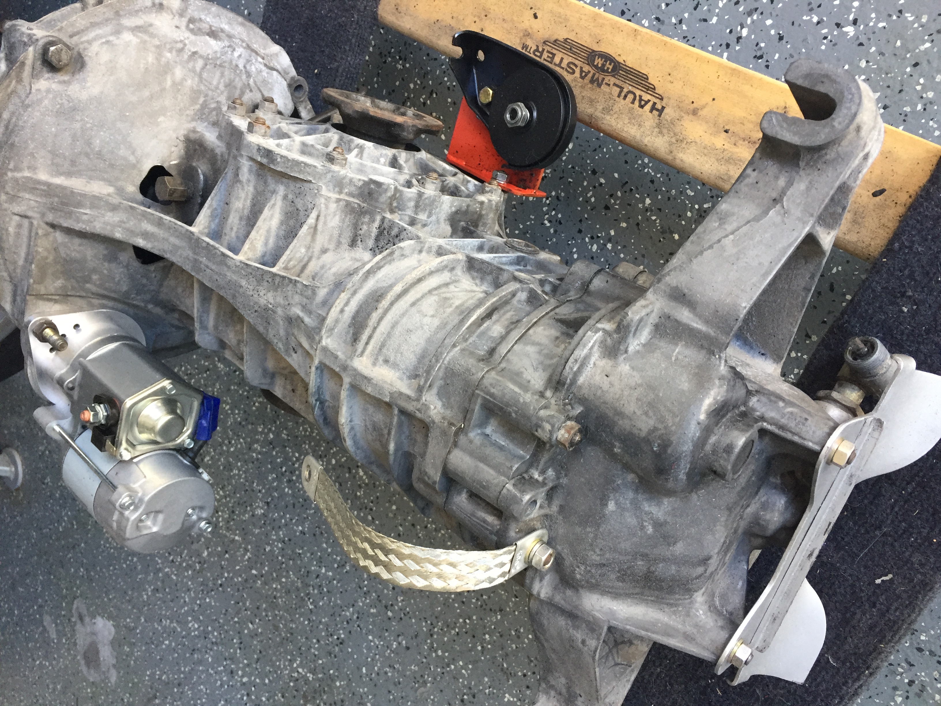

Here's a pic of the ground strap I'm using. I think it's 1 ft and 2ga.
