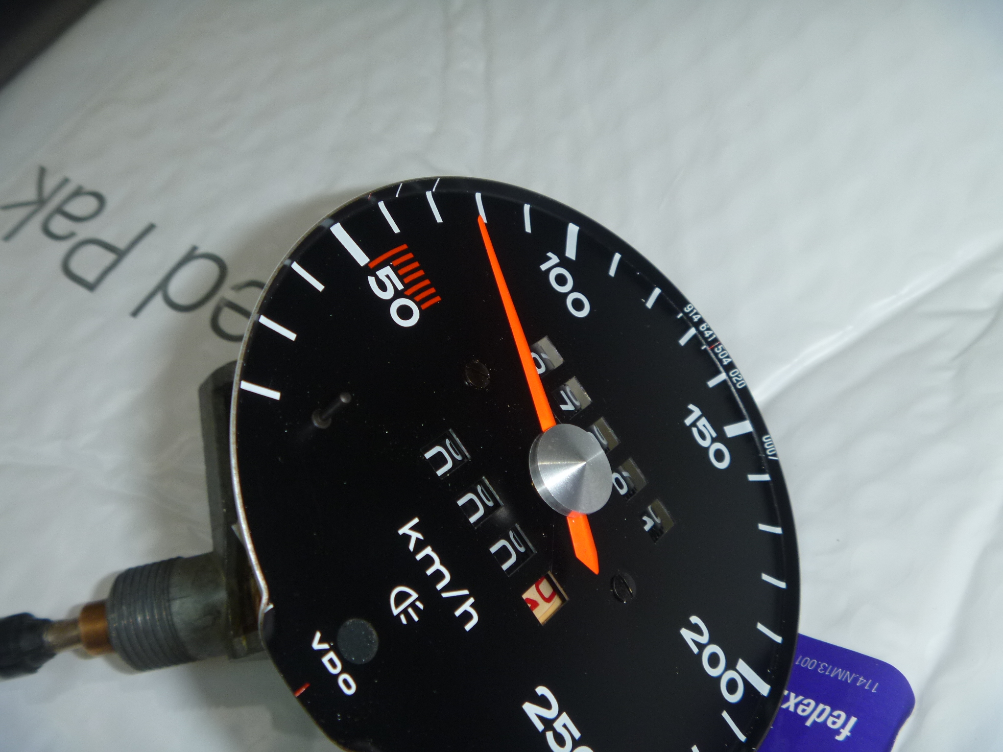

Hey, are there no gauge faces left down under? Not even one??
I just finished my gauges with heiler-tachodesign faces. I choose the silver buttons for my electronic speedo and the 911S tach for my mfi. Also I put the old style temp face in.
The surface is perfect the letters almost the same, with small deviations - very small. But... it is a 2mm polycarbonate disc. This is not deep dished like the original. You will have some different lighting in the night -
So it is better illuminated than the other old ones.
I put also a set of led`s in.
If you need a face with mps and kmh it is absolutely tooo expensive at heiler-tachodesign.
Sorry, I haven`t left one for you. My old one is a 260kmh and won`t fit.
