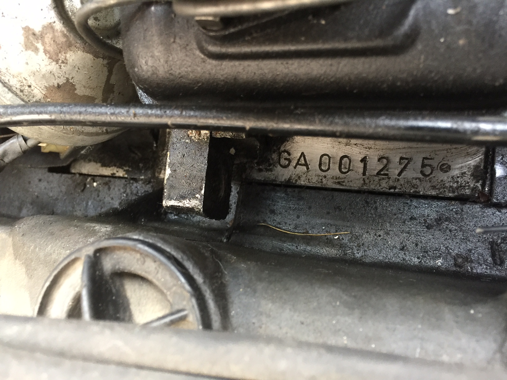

1976 2.0L.
Engine is not original, not sure what year it is. Paint code on door is Ivory White if I remember. Am I missing any info or can someone break down the codes more than that?
914_7T3
post Sep 4 2017, 10:48 PM
Posts: 1,894
Joined: 3-April 17
From: Los Angeles, CA
Member No.: 20,991
GA001275 falls within the number range of a 1973 2.0
(GA000001-GA006765)
The Karmann plate is your chassis # and not the Vin.

carcus
post Sep 4 2017, 11:15 PM
Posts: 223
Joined: 16-March 16
From: Colorado Springs
Member No.: 19,760
Thank you very much kind sir. 1973 2.0 engine it is then. I knew it was not a matching numbers engine on my 76.

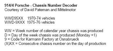

QUOTE(carcus @ Sep 4 2017, 10:15 PM) *
Can the chassis plate be broke down to year and month of manufacture?
Almost. The VIN will give you the year and the chassis number will give you the day of the year.
However, note that the VIN year doesn't start on the 1st of January. Your '76 chassis was build in '75 and the chassis number will give you that day.
There's a decoder here somewhere, let me look ...
post Sep 4 2017, 11:20 PM
Resident German
Posts: 42,469
Joined: 21-January 03
From: Oakland, Kalifornia
Member No.: 179
QUOTE(SirAndy @ Sep 4 2017, 10:18 PM) *
Found it:
(IMG:http://www.914world.com/bbs2/uploads/post-10181-1489268098.jpg)

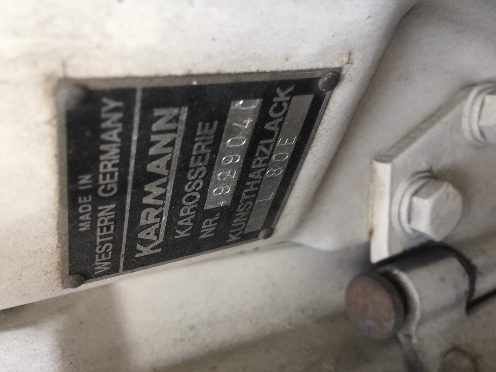

QUOTE(carcus @ Sep 4 2017, 11:46 PM) *
VIN 4762903845
What I get from the decoder is April 1976 build, not having the day or month. I know the last year was 1976 and numbers were very low. Using the vin pictures posted, am I off? I did not see a DDMM in my vin so I take it MYY then build number.
4 month of April, 76 year of vehicle, 2903845 left over numbers I have no idea.
For my engine number posted it is a 73 2.0
Chassis number posted I have no idea.
I want to decode to add to the website history. Thanks all for your help.

Your chassis code from the door is 4929040,
The decoder says that this was built on Tuesday of the 49th week of the year, and was the 40th chassis made that day.
If I read it correctly...

QUOTE(carcus @ Sep 4 2017, 11:01 PM) *
No, like i said, your car was build in '75. The Model Year (MY) for '76 started in August of '75. As far as i know, all 4000+ '76 cars were actually build in the second half of '75.
QUOTE(BfloRandy @ Sep 5 2017, 03:42 AM) *
This ^^^
WW
D
9
(X)XX
49
2
9
040
Week 49, Day 2, 040 chassis build that day
Week 49 = December 1, 1975 to December 7, 1975
Day 2 = Tuesday, December 2nd 1975
