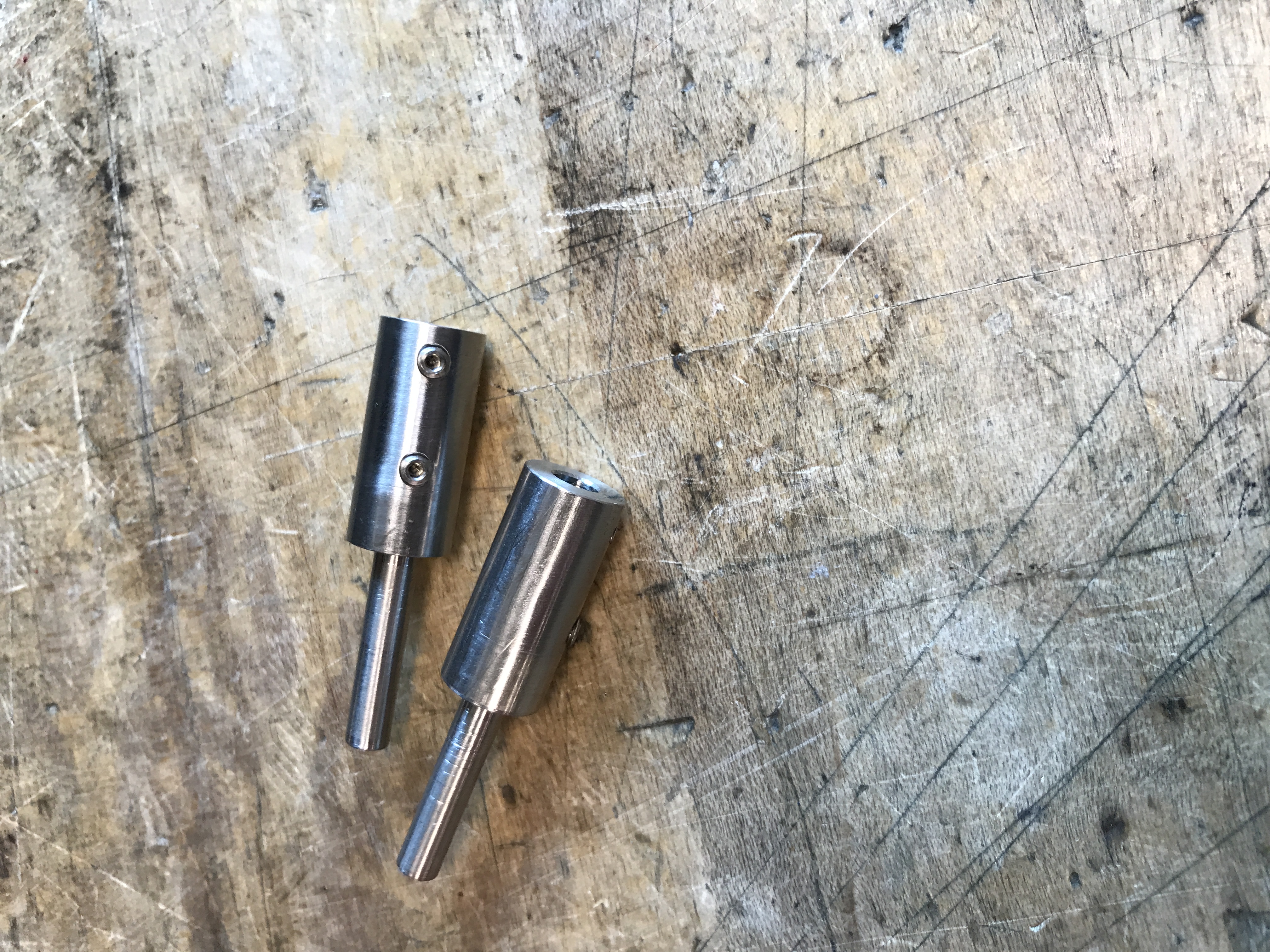

Two sizes? Learned something new. Mine came up short with the aftermarket six heat exchangers and I thought they were wrong. Went thru the process of making extensions. Guess I'll have to give Mark a call. Attached Image
Making cool stuff while some of us can barely assemble cool stuff is sort of unfair. (IMG:style_emoticons/default/biggrin.gif)

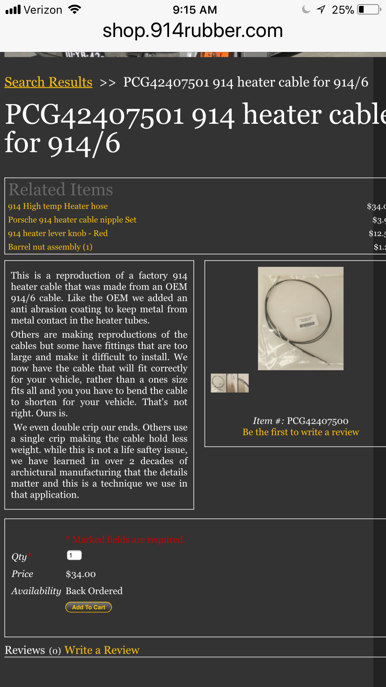

Matty900
post Oct 7 2017, 08:29 AM
Posts: 1,302
Joined: 21-February 15
From: Oregon
Member No.: 18,454
QUOTE(mepstein @ Oct 7 2017, 06:13 AM) *
QUOTE(914Sixer @ Oct 7 2017, 09:10 AM) *
There is 3 DIFFERENT cables. One for the -6, one for all the 70-74 engines and a third set for the 75-76.
I don’t know if Mikey made the 6 version. I hope so.
Edit - he has it listed but not in stock. I need a couple.
We make them so, don't worry about the inventory count on website. We also make the "nipples that go on the end of the tubes comming out of the firewall too. Along with related items http://shop.914rubber.com/searchquick-subm...keywords=Heater
It's the only small advantage I have in this world. So I'll try not to feel guilty about it. Hehe

post Oct 8 2017, 02:54 PM
The rubber man
Posts: 12,772
Joined: 27-December 04
From: Hillsboro, OR
Member No.: 3,348
A benefit of actually being a manufacturer is if yon need a custom length it's easily done. Also when you see stuff is out of stock, it often means we haven't updated the inventory and we can easily confirm with a call.
We don't charge extra for custom lengths, but will need you to call out how long you want the cables.
