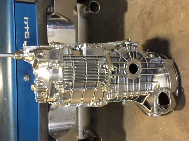

Playing with cerakote at the shop.
mgphoto

Rory secretly covets our chrome trans. (IMG:style_emoticons/default/laugh.gif)
