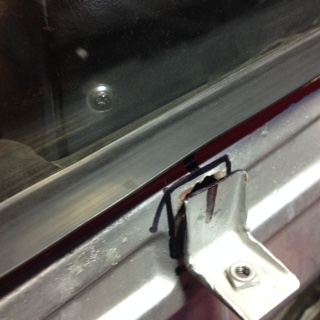

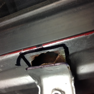

I can think of a couple ways to fix this. Can i hear more ideas?
You can see that there are 4 weld impressions. 3 have pulled a hole in the firewall. Attached Image Attached Image Attached Image

Tape & mask window. Wire brush to metal. Tack weld left side, tack weld right side. Careful with heat due to window. Fit lid. Good? Hit with 2K epoxy rattle can. Unmask window. Refit lid. Done.

It will need to be patched. Most of the time the spot welds just pop.
Now it's a time vs. money thing.
Is the engine in the car ?

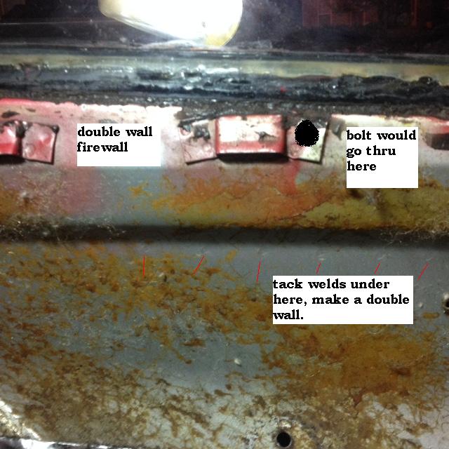

One method I was thinking about was to remove the seats and back pad. Make a weld repair to the inside.
Then maybe drill a hole thru the vertical section of the bracket and the firewall and add small, sturdy plate inside (10 ga or thicker) and bolt it all together. I suppose I could also tack each side in the engine bay, as suggested above.

How about doing a combo of your two ideas. Lets use the bolt to pull the skin and the hinge back to the firewall, then weld the sides. 3 to 4 tacks on each side. Let the metal cool to the touch between each weld. Then one tack on the top.
Then get a can of EverCote brush-on seam sealer, remove the bolt and nut and seal it up.

looks like cary's combo idea might be the way to go. I was planning on leaving the bolt, but this area of the firewall is doubled. So i can't cinch the bolt down tight like I wanted to do since it is double walled. Everything will collapse. everything below the visible tack welds is single wall.

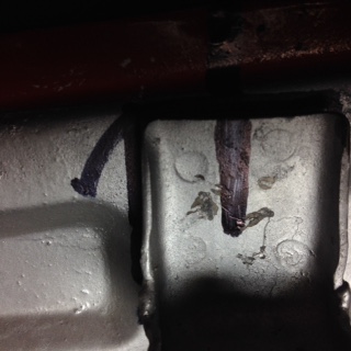

QUOTE(windforfun @ Nov 2 2017, 08:16 PM) *
You might want to pull out the pad behind your seats too. BTDT.
that yellow goo in the picture is what factory sprayed on in 1975 and used to hold that pad in. I pulled it all out in 2011. Just out of view of the above picture is B-Quiet stuck to the fire wall. You can just see a bit of it in the btm left corner of the picture.
The car used to be silver. My guess is that the PO pulled the back window and layed the crappy pad down and painted the car red.

neither pad is installed. There is very little room in the engine bay. So that crappy pad was pulled too. The only pad in my car is B-quiet. On the interior firewall behind the seats and on the floor.... the metal floor that I welded in. Any remaining floor that had goo on it, had the goo removed.
If you look under the 1st few pix you can see that no pad is under the hinge. The pic above is inside. the funky loops are what holds the vinyl back pad to the firewall.

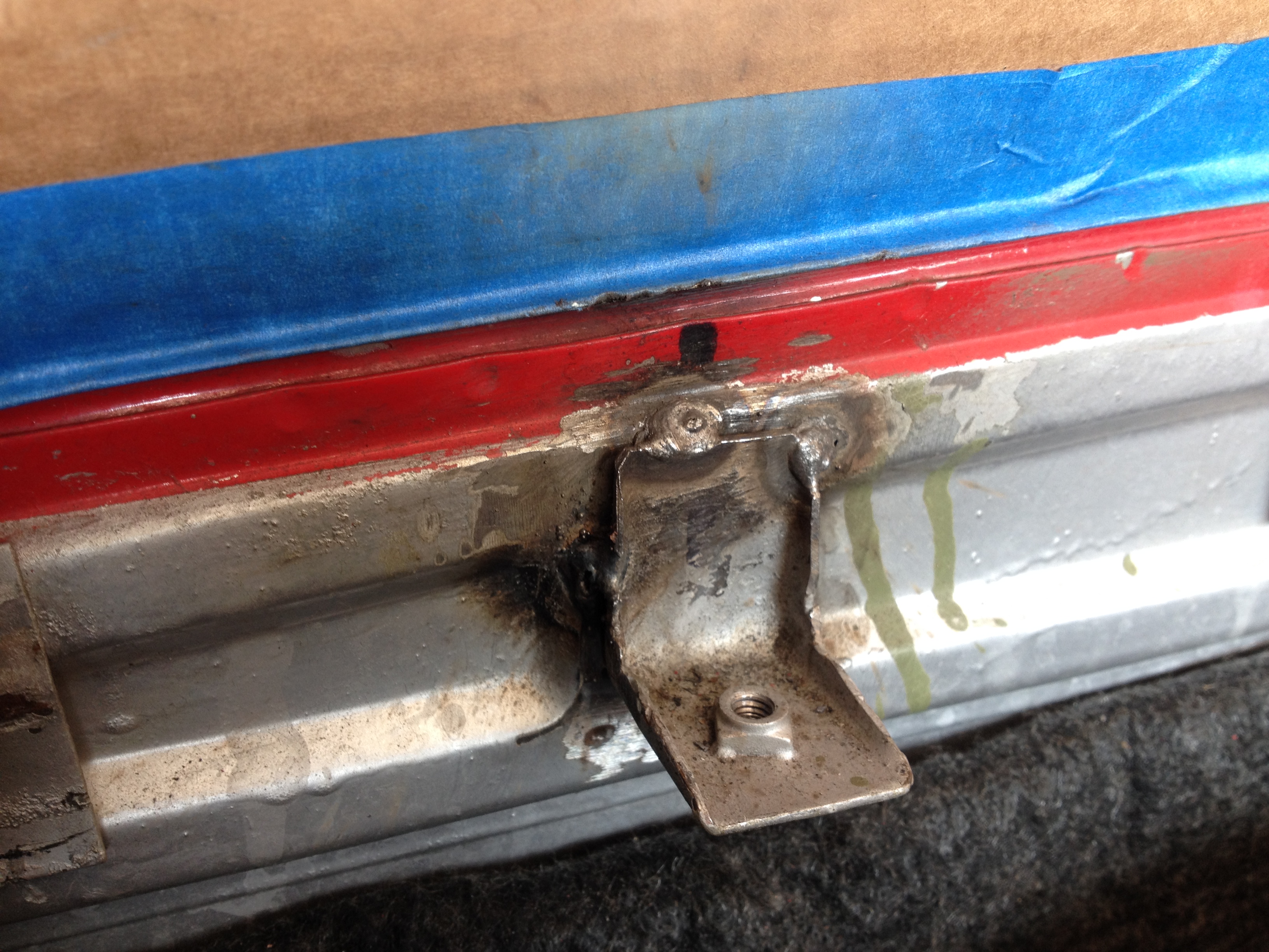

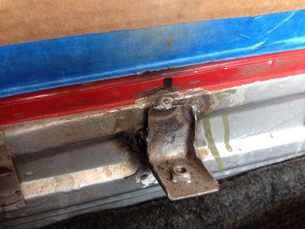

Well I finally got around to finishing this project. As recommended I tacked a few places then re=fit the lid. Here is the pre-fit tack job.
That ended up taking some time. My bolts were stripped. Once I got that straight everything fit and I tacked and tacked and tacked.....
Good enough for driving to Walmart....
cary
post Nov 11 2017, 08:05 PM
Posts: 3,900
Joined: 26-January 04
From: Sherwood Oregon
Member No.: 1,608
That dog will hunt ...............
Mask it off and spray with Rustoleum of your choice.
