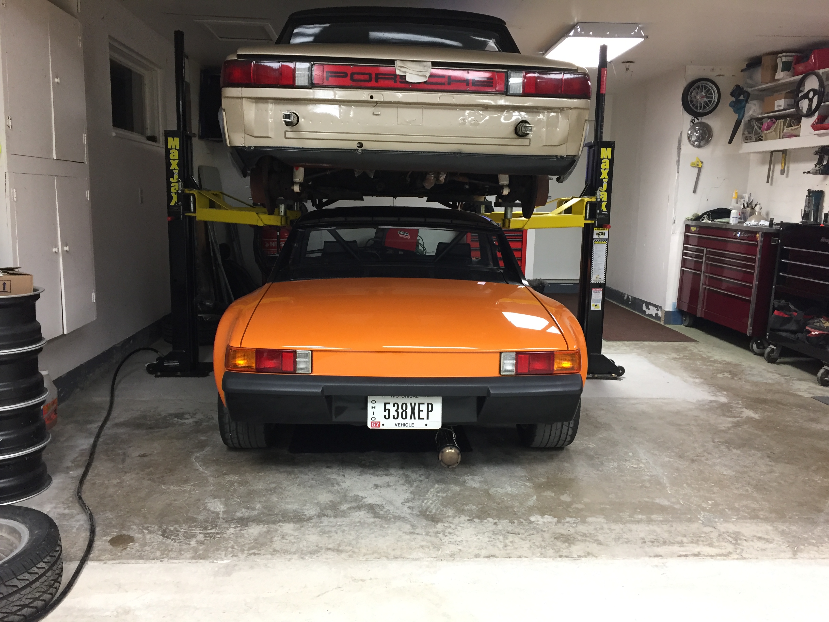

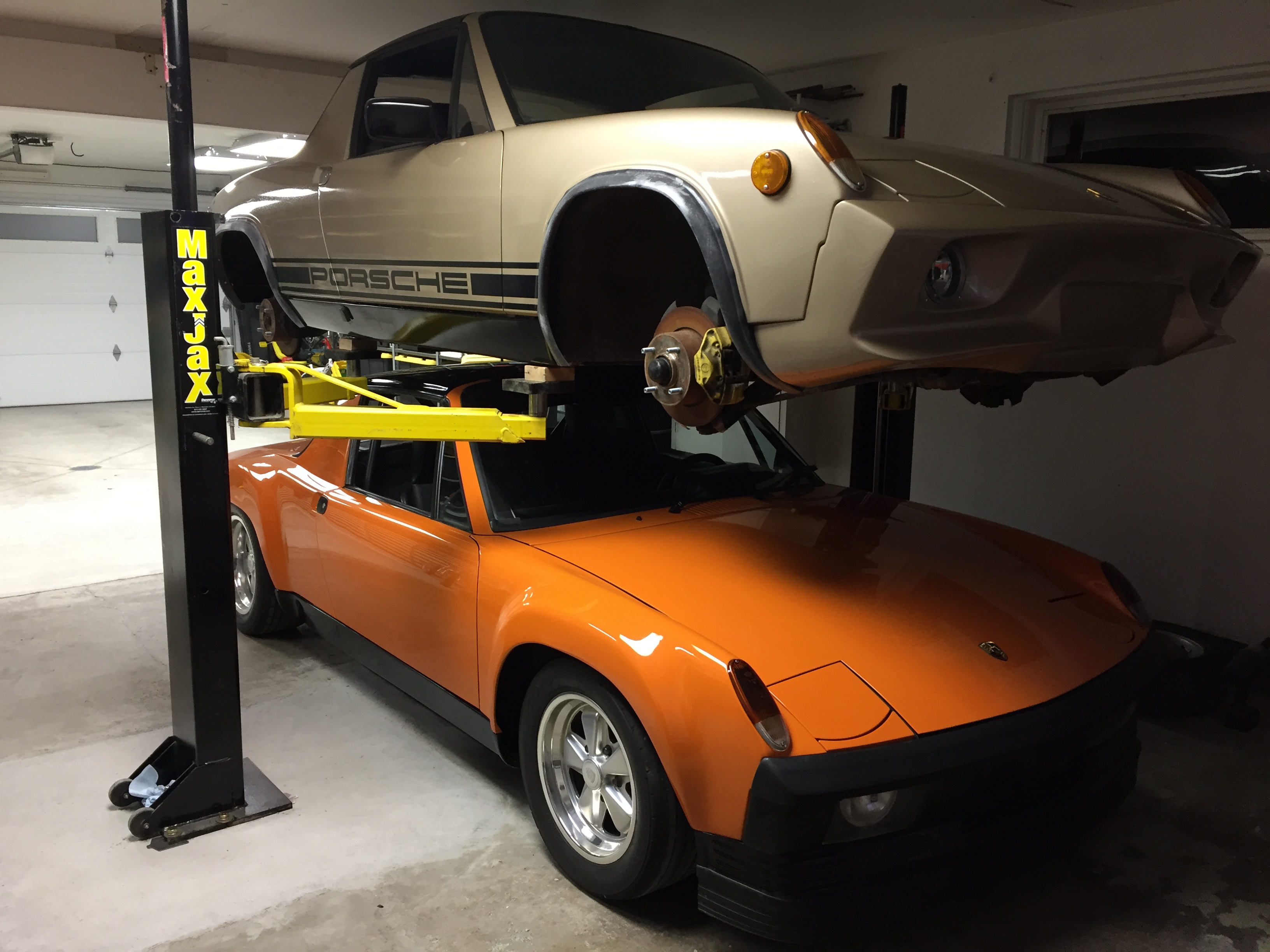

post Nov 21 2017, 08:21 PM
Post #48
Posts: 54
Joined: 14-February 06
From: Dayton,OH
Member No.: 5,581
QUOTE(mepstein @ Dec 19 2016, 05:26 PM) *
QUOTE(ledfoot @ Dec 19 2016, 08:23 PM) *
QUOTE(Phoenix-MN @ Dec 8 2016, 06:01 PM) *
Does the Maxjax lift the car high enough to park another 914 underneath? I'm sure the car on top would need the wheels removed for more clearance.
No
Guess again...
Just finished my Maxjax install and now have two stacked in the garage. I added the 3" Risers for more clearance. Can't be happier not having to use jack stands. (IMG:style_emoticons/default/aktion035.gif)

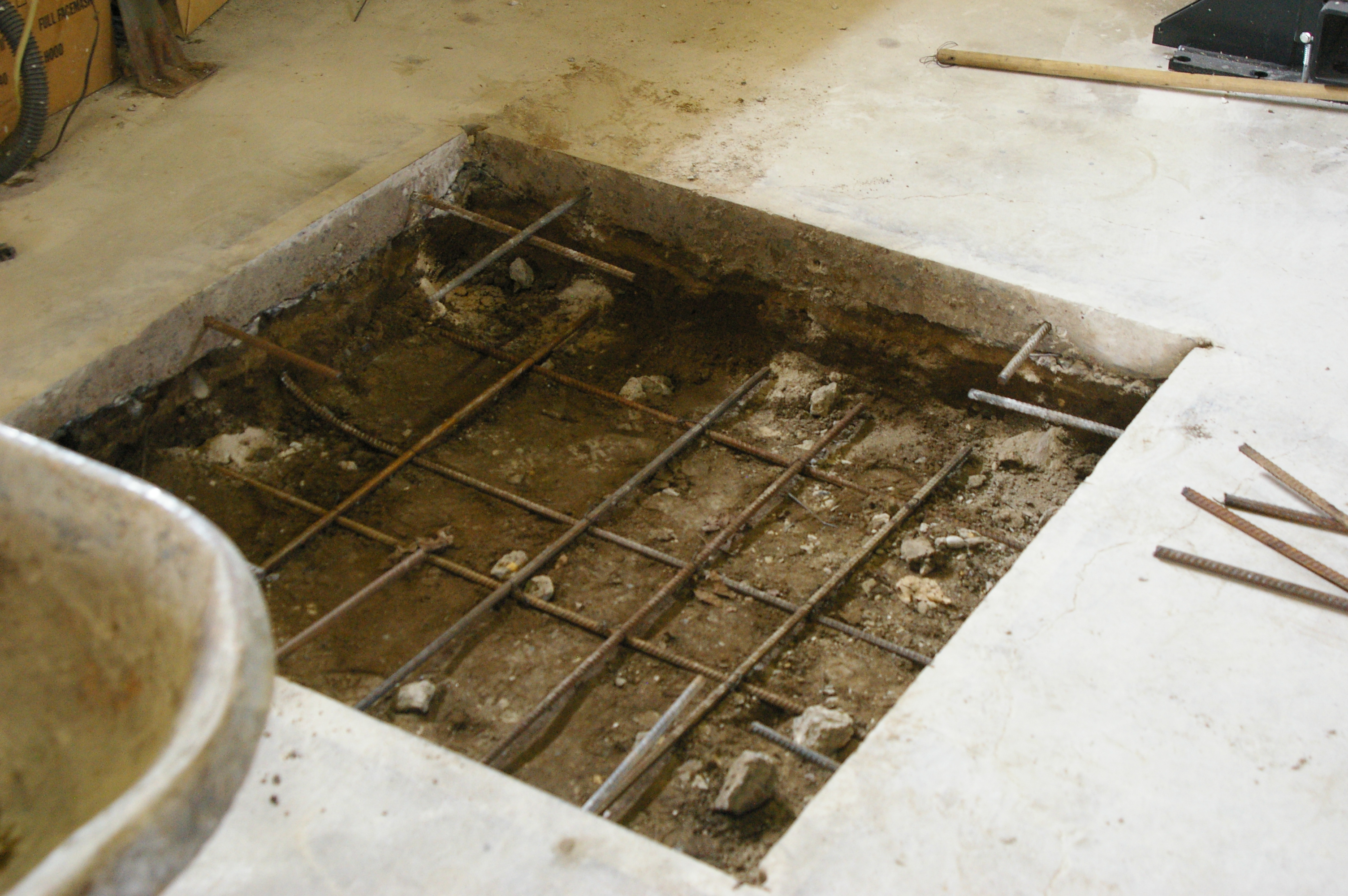

I just had my BendPak mid-rise, flush-mount scissor lift delivered. I expect that within the next two weeks we will be cutting the concrete slab to excavate, form, rebar and pin our new concrete so we have the pit to install the lift into. The floor will be porcelain tiled to complete the job.
This is tied to a full garage remodel with new cabinets. The cabinets will include one section for just the lift hydraulics and motor. All lines will run through a PVC chase in the floor, wall or cabinet. Should result in a clean garage and still allow for service, removal or replacement of the lines if there is ever a problem.
Once we start laying this out and cutting concrete, I will be taking photos and posting them. I am so happy to be able to do this. I am tired of kneeling or sitting on the floor to play with my cars. Hard on the old body.

It seems that the pit would be a constant " lookout " when moving around on a castered stool....

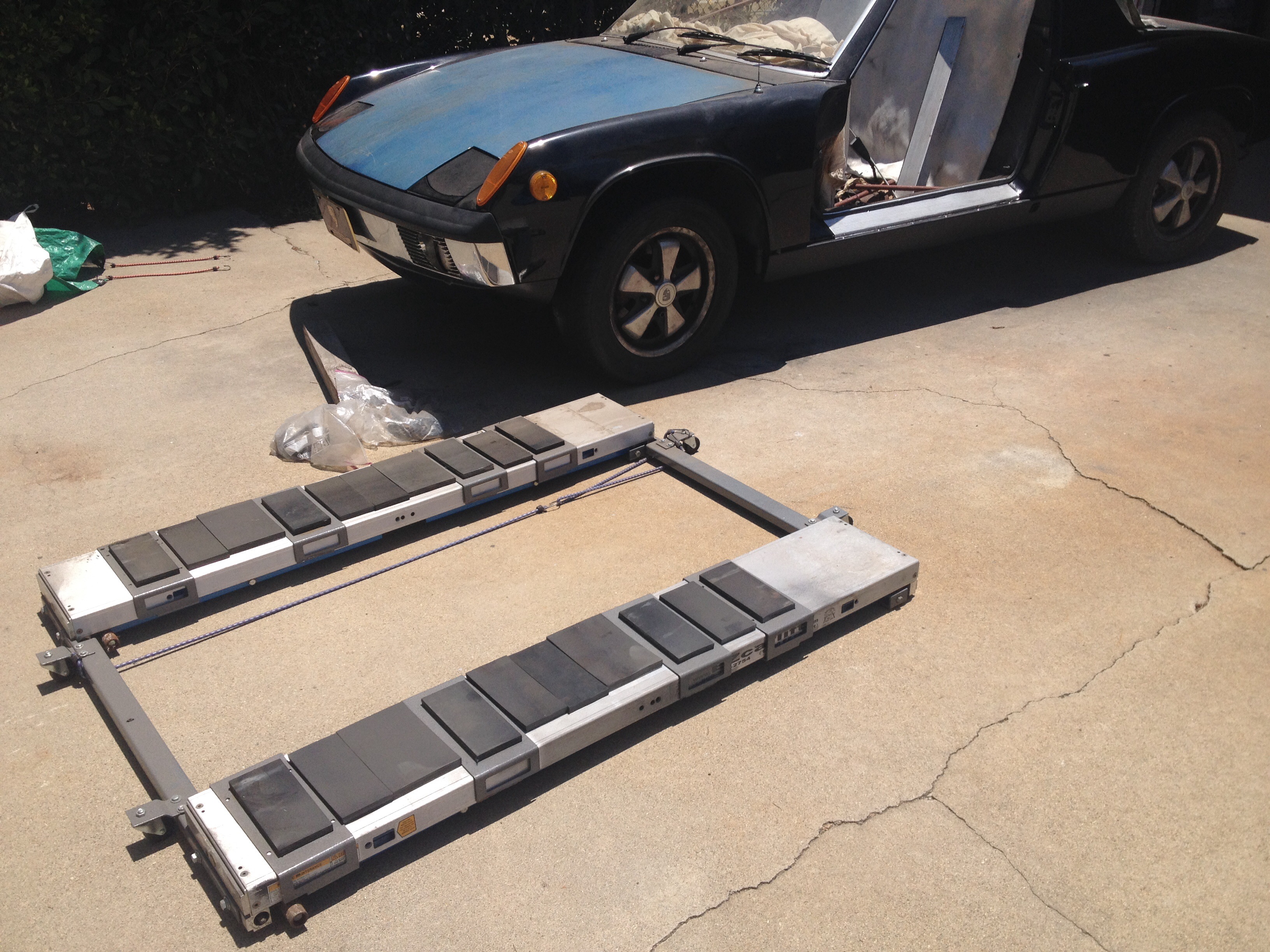

This is what I decided on.
EZ Car Lift, been a great help, added the wheel kit, now this is portable.
No modifications to the garage , uses heavy duty electric drill. Even has a drive over kit for lowered cars.

When down, the lift will have about a 3/8" reveal around it and the lifting "pads" will be absolutely flush with the floor. I do not think we will have any pit-hazard issues. But, I am old so you never know....

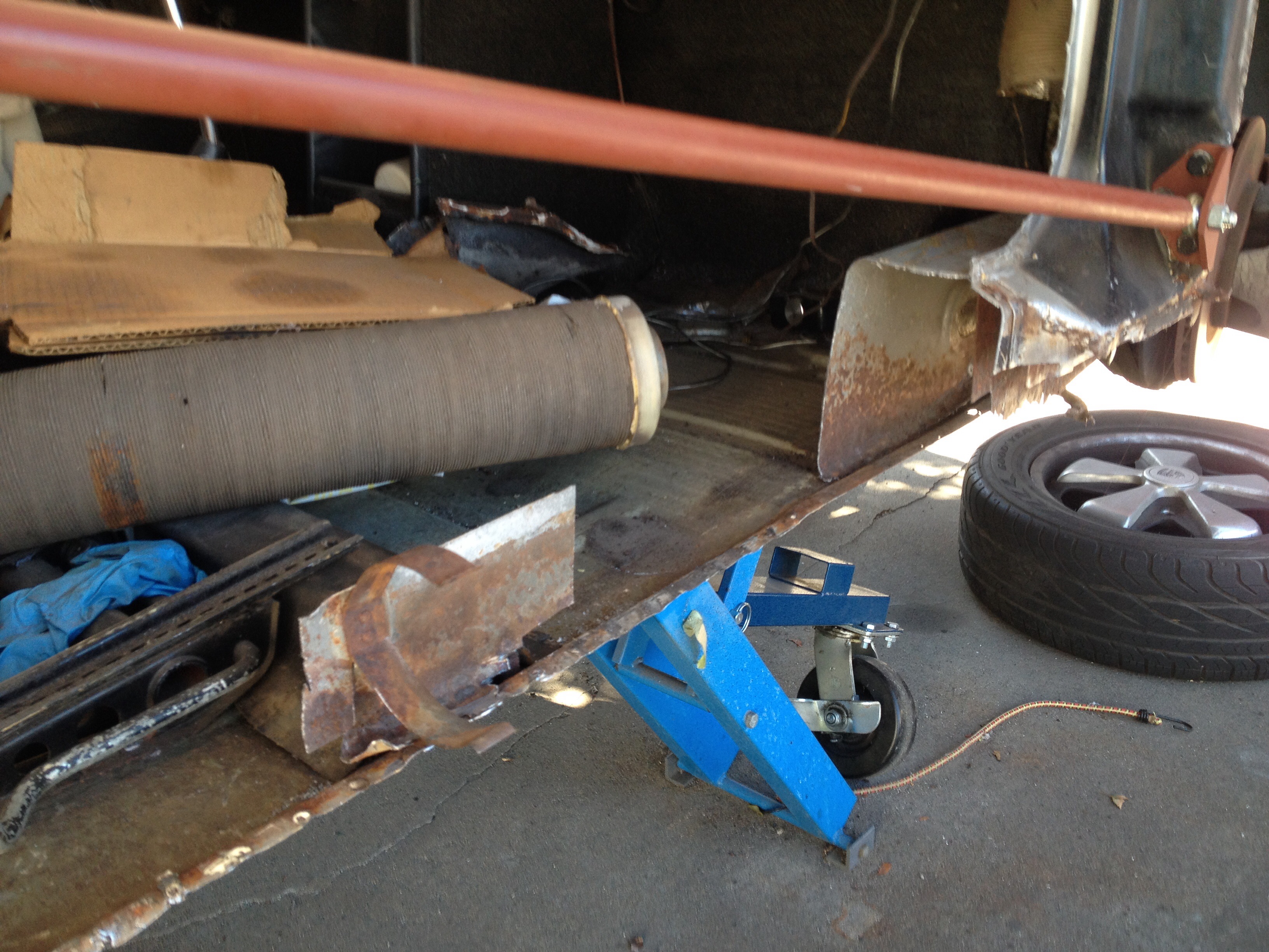

By using the rubber pads and shorter cross members I was able to support the pan with great access to make repairs.
Light weight and flexible configurations.
