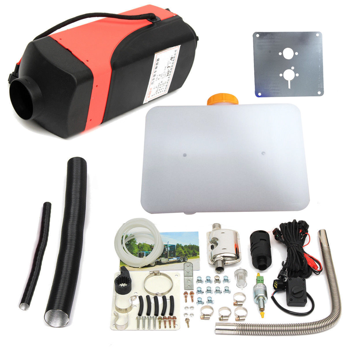

Cool little thing comes with the tank...see in the picture? Looks like a whisky flask!

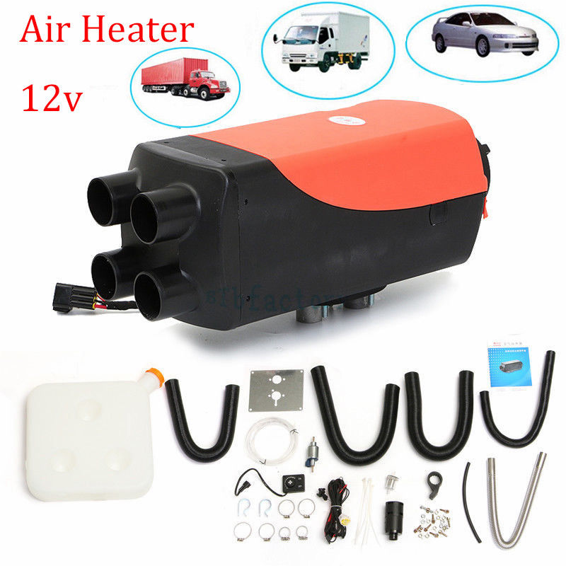

Looky looky....5K / 4 outlet

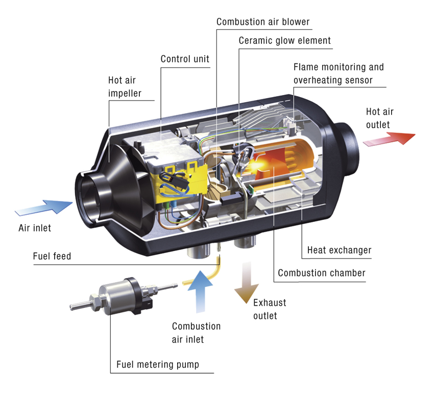

(IMG:http://www.914world.com/bbs2/uploads_offsite/www.eberspacher.com-179-1512249836.1.jpg)
