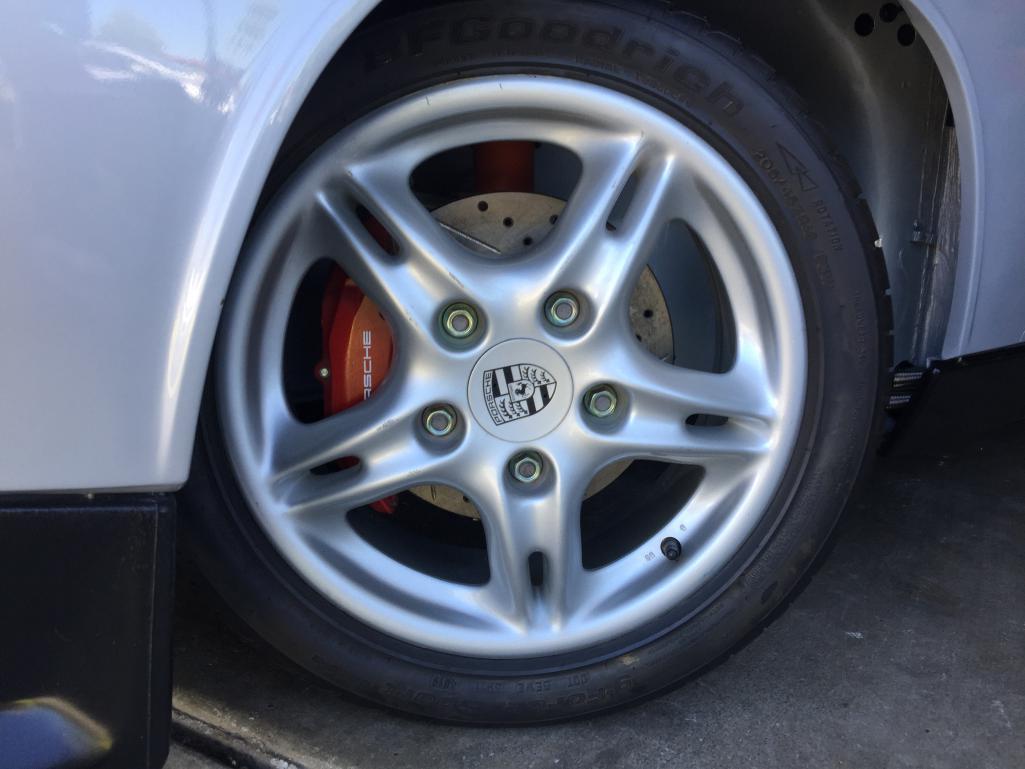

My car currently has Boxster calipers front and rear and I am running Boxster wheels. I like the look of 15" Fuchs so I am looking at the Maxilite 15x6 wheels. Anyone out there running Boxster calipers with 15" wheels? Just wondering if they fit. I don't know anyone that has a 15" wheel to test. Thanks.

What rotors are you running? That's a key factor...I'm guessing Carrera (impact bumper) rotor?
I'd be surprised if 15" fit, the 16" I use look like they don't have a lot of room to spare.
Anyone else have a set of 15" fuchs and tried it?

I am running Stoptech Carrera rotors in front and 911sc in back. It looks like there is plenty of space but could be wrong
